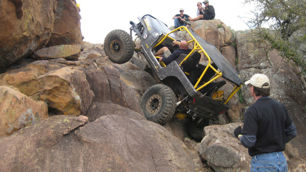

This is a dedicated offroad trail vehicle located in Houston, TX. It is unbelievably capable offroad! It started life as a 1984 CJ 7 and was completely rebuilt with a 5.0 High Output V8, custom suspension, custom transmission – transfercase – and underdrive resulting in an INCREDIBLE final crawl ratio of 331:1, Custom built frame from 3/16 – 2x4” rectangular tube. This is a 3-seater with a wheel base of 109”.
See misc. build and wheeling photos here
1984 CJ7 w/ Clean Title
Ford 5.0 Highoutput V8
  • 302 Engine from a 2000 Explorer w/ GT40P heads
  • Wiring/Computer/Accessories from 1990 era Mass Air (MAF) High Output Mustang
  • 100% new engine wiring from http://rjminjectiontech.com when I did the engine swap
  • Computer replaced when I did the engine swap – computer is Mass Air (MAF) EEC IV
  • Fuel Injectors upgraded to 24lb
  • Shorty Headers
  • Custom K&N Cold Intake
  • Engine mounted York compressor (largest10 cubic in. displacement) capable of operating any air tools
Transmission
Ford NP 435 with a first gear ratio of 6.68
Underdrive
Mad Rooster Underdrive/Crawler Box gives an additional gear multiplication of 2.72 which helps get the crawl ratio to a final ratio of 331:1
Dana 300 w/ 4:1
  • Completely rebuilt with JB Conversions LoMax 4:1 Gears
  • JB Conversions front 32 spline output shaft
  • Advance Adapter rear 32 spline output shaft
Front Chevy Dana 60
  • Chromoly Alloy USA axle shafts
  • CTM U Joints
  • Drive Flanges
  • LockRight automatic locker (works flawlessly)
  • High steer (draglink in front of axle, tierod behind for protection)
  • PSC Hydro Assist (all PSC - Pump, Steering Gear Box, Cylinder)
Rear Corporate 14 Bolt
  • Disc Brake Conversion
  • Shaved 2” for additional ground clearance (ring gear NOT shaved)
  • Full Detroit Locker
Suspension
  • Rear Suspension is a double triangulated 4 link using coils and shock absorbers
  • Front Suspension is 1.5” Rubicon Express SOA leaf packs (RE #1445)
Frame
The frame is 100% custom, completely fabricated from scratch when the engine swap was done. Frame is constructed from 3/16” 2x4” rectangular tube.
Tires/Wheels
39.5 Irok tires mounted on H1 Hummer double beadlock wheels with custom rock rings
Armor
Custom Tube Fenders, bumpers, PSC 3/16” Rocker protection and 3/16” full comp-cut corner guards
Extras
6 point custom roll caged tied to frame, Custom dash w/ Autometer gauges, Warn 8274 winch, Custom Roll cage, Corbeau racing seats (need to be recovered), water-tight custom center console, 4 point harnesses, RCI Fuel Cell, Cobra SX75 CB radio, rock lights, electric fan.
I’m sure I’m forgetting lots of stuff
NOTE: The red label Krawlers and Walker Evans tires/wheels from some of the wheeling photos were borrowed for that particular trip – they are not on the Jeep. The Jeep has H1 double beadlocks and 39.5 Iroks.
