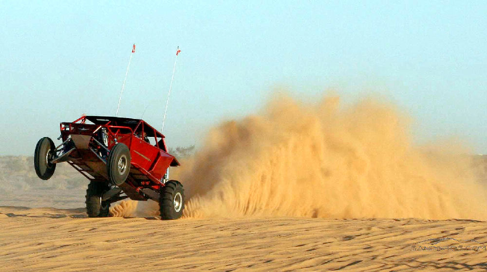

Randy
this is NOT a race Truggy...and it has a independent rear (IMHO they just handle better in the sand and around turns)..... its a sand/desert play Truggy i made for my friend Ryan English in Henderson NV ;
(pic; Pete @ DDR.com)
front engine (dry sump twin turbo aluminum BBBrodix) with full manual TH400/Allison hybrid (custom internals to fit the big fat Allison input shaft) and a B&J Quickchange (torsional limited slip, 41 spline, all 300m material)
here is another pic; Ryan with his buggy (we like to call it V-Rex) giving guest rides
and another one; i usually dont like wheelies (IMHO if your front tires are off the ground you dont have control..... i guess i`m a control freak ) ... but you dont see many 4000+ lbs front engine truggys doing wheelies
(pic; Mike @ Sandbros.com)
i dont like ass-heavy dune buggys and i hate transaxles... IMPO for a all around "fun to drive" desert/sand/street car a truggy is the way to go
