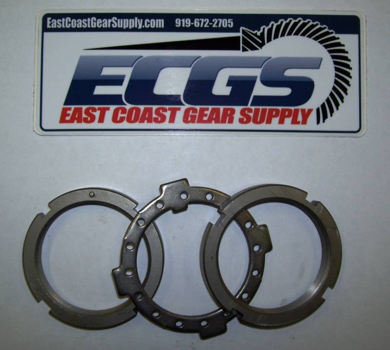

Just pulled spindles off a D50 on my other truck this past weekend, the beams were off a '92 and it had the Chevy style/ 3 piece setup that uses the 4 prong socket. My '94 ball joint 60 has them as well, but a buddie's '92 D50 had the retarded old style spindle nut, so I'm pretty sure 1992 was the split from the old style to the new.
If you've got the old one, it's a 2 3/4" 6R (6 sided, round) spindle nut socket. This one also works for D60 rear axle spindles.
Pretty sure both of mine came from the tool aisle at Vatozone for $20 or so apiece.

For the OP, new style on the top (good), old style on the bottom (ghey)
This weekend I also removed the manual lockouts on the '92 D50, and threw them in my '94 D60 hubs which originally had the automatic 5 screw locking hubs. Both are interchangeable, and both utilized the Chevy/Late Ford style spindle nuts.

And just to add to the variety, two kinds of Chevy/Late Ford style spindle nuts exist.
We've got the one's pictured above, with no outer tabs and one inner location tab on the washer:
And the others that do have outer tabs, and a little knub on the inner nut to hold the washer in place:
These last ones are necessary for the automatic hubs to engage. There is a sprag on the back of the auto hub that uses the tabs in order to hold still with the spindle, so that when the inside driver turns, they engage. The kind with tabs are what I surmise any of the factory ones will look like. Either will work with a manual hub of course.
