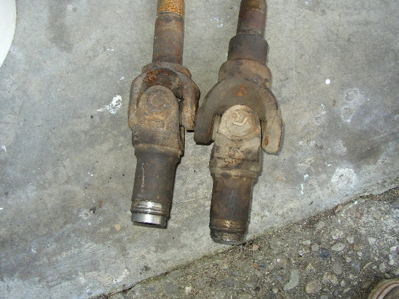

Hi, im new at this forum, hello everyone! well i have a problem with a 1993 Bronco. since it has Nitrous (150 HP) its breaking the font TTB left axle where the u joint is. So i decided to buy a reinforced axle to replace this one that is not being hard enough. The problem is that i cant find a heavy duty one so i need some recomendation where to look for one. so i would be very thankfull if some of you could tell me something.
Well thanks... i'll be waiting answers
Cristobal

if you want to stay with the TTB find a dana 50 TTB for dirt cheap. uses dana 60 joints down side you convert to 8 lug but hey then you can put a 60 or sterling 10.25 in the rear
send superior your shafts thats about all i know of for options ont he TTB dana 44, anytime i had one in a bronco or a f150 i swapped it out to a dana 50 or fabbed in a hp dana 44 and stuck alloy shafts in.

The D50 TTB does not use D60-size joints, they are in between sizes of the D44 and D60.
I would agree though, get on the phone with Superior, Alloy USA, etc. and see what they can offer. Fortunately the driverside shaft is no different than for a straightaxle D44 (other than length), you should be able to find something for it without too much hassle, it's the passengerside shaft with the slip-spline that's probably gonna a bit tougher to get in 4340.
Perhaps simply running genuine Spicer 5-760X u-joints and welding the caps to the yokes could help, too (if it's busting at the joint).

A POS axle is still a POS axle. A D50 shafts neck down to a D44 size.
If you want it to last a little long run a d50 stub shaft. After you break that constantly grab a Solid 44 or 60, problem solved.

How is he going to run a D50 stub shaft? D50TTB uses a 1350 external snapring u-joint, same as in rear driveshafts.

Anyone that runs a TTB44 breaks it and swaps in a D50 stub.
D44 stub versuses D50 stub, same splines, same size, bigger u-joint where most break. I've run one for about 3yrs or so now, they still break jsut not as often.

I never suggested D50 TTB outers on a D44 TTB I stated getting a D50 for his truck like in robbing a whole dana 50 TTB out of a pickup.....
A d60 is my choice but a TTB can be fun you'll have to weld some brackets on the TTB50 but it will give you the suspension movement that is sometimes advantagious when jumping/ desert racing a 4x4 rig ...... Really depends on what you are doing, for all the work a D60 and a strong 4 link would be awesome but a D50 could be made to do a decent job

Alright, just wanted to make sure someone didn't try that. Cannot be done.
Swapping a D50 TTB into a Bronco is plain retarded in itself. They are leaf sprung and all full size Broncos are coil sprung from the factory. Might as well find a straight axle like you suggested.

CTM will make you new bad dude shafts. Expect to spend 2,000$.
