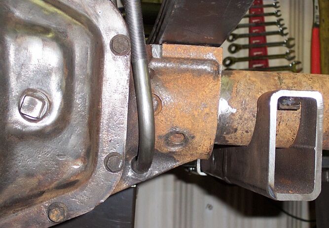

i have a 96 250 with a Dana 60 front out of a 94 350. the way the u bolts are in the front is the nuts are on the bottom and hang low. what i am trying to find is a kit that allows me to turn my u bolts upside down so the nuts are on the top giving me more clearance. the reason this is confusing to me is b/c on the driver side you cant put a u bolt on one side b/c the leaf sits on the beginning of the pumpkin. if there are no kits any ideas for fabing would be good. thanks

i just made my own
[IMG][/IMG]
[IMG][/IMG]
[IMG][/IMG]
top plate is 1/2 and i just cut out a slot for the u bolt to fit in the pumpkin.

what size u bolt did you use on the driver side?

The pumpkin side of the drivers side uses a 3 7/8" u-bolt. A 4" will work fine also. You can also use the u-bolt plates from a sterling and ream out one side slightly, I had some lying around, saves you from buying some.

The mo' tricker way to do this is to drill a hole in the web. It was a minor PITA getting the u-bolt thru, but not that bad. Just take care not to crush the fine threads. If you're feeling lazy a notch is fine, too.
