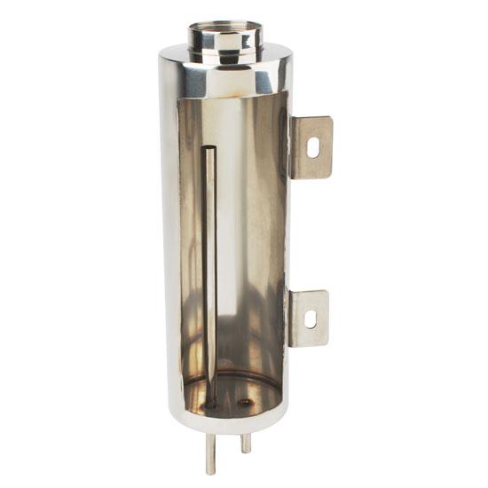

And why I like the Speedway cans. The 13" is $27 and looks super pro-level with chrome, mounting tabs, screw on cap, and the internal straw action so rollovers its harder for fluid to escape.
www.speedwaymotors.com
Item #: 91102213
A cutaway view of the ones I like. I know I've posted them all over Pirate, and have seen them popping up on rigs from east to west coast for the reasons I listed above.
