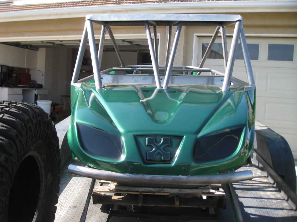

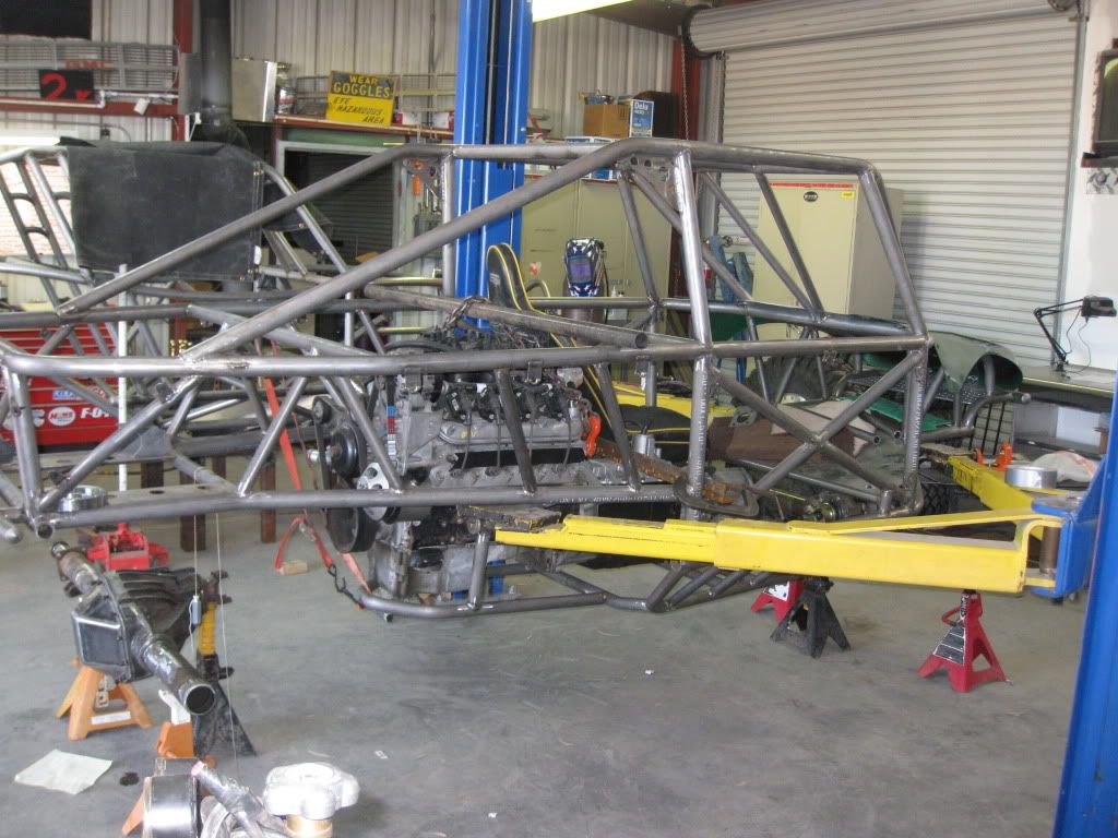

Here is the start of this all. This is an SXOR chassis. Modified to be 8in farther forward than any chassis they have made. This is going to put the driver and passenger feet in front of the front axle. This should help with visibility and weight distribution. Goal at the end of this is 45% front weight and 55% rear. We will see. Not sure if it is practicle.
This is what I picked up from SXOR. A heavily modified chassis and panels
They do nice work. It is a good place to jump off from.
This is brought to the shop. The guys building this truck are Brian Hays and Glen Westberg with help from me and the Degenerate crew (thank you Nick and Pat). They have an amazing shop in Ridgecrest, CA. No name. Not yet. They are too cool to drop it early, you know. :grinpimp:

Sweet ride, Buck. Bit of a step up from the Defender 90 days. Diggin the hood and lines of it, looks good.
So in terms of getting the weight distribution percentages as described, either you're one solid mofo with legs like Ronnie Coleman, or you'll be sitting WAY forward of the engine/auto/LT230 to make it happen. Granted the plan is to have you feet forward of the front axle, but with the driveline, radiator/tranny coolers and size of the rear links weighing against you, the 45/55 split is gonna be interesting to attain. That's from just looking at these 3 pics, mind you.
Like it a lot, though. Nice fab work as always.
Mick
#6 · (Edited)
Not as hard as you might think. The Jimmy's, M&M, Jim's Garage etc. buggies have been moving the engine WAY back for several years with the driver's feet almost against the exhaust and achieving almost 50/50 distribution.
My SXOR buggy has the rear engine LS1 WAY foreward and weighs 1,600# front and 1,680# rear without occupants. (49/51) It has a 106" wheelbase. Adding the extra length should achieve the desired result. My buggy has had no problem with steep climbs and really shown no tendency to "flip over backward."
