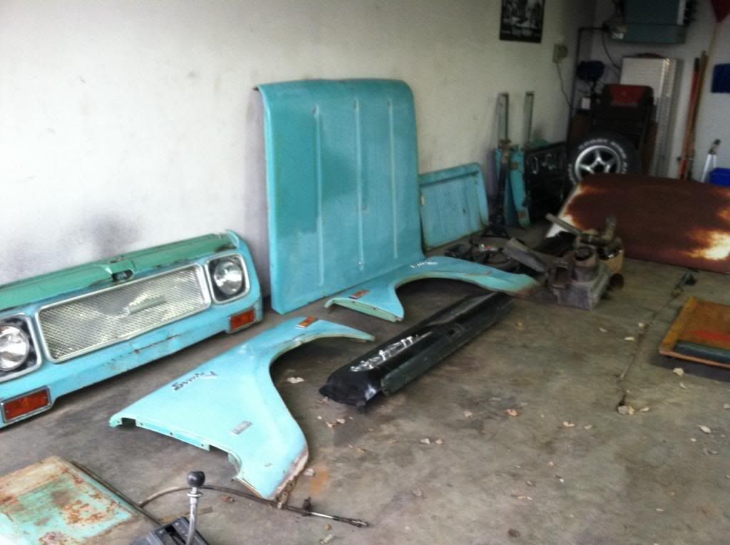

Time for a new rig, got very bored with the old rock crawler and wanted something that's a little faster and drives a lot better.
Some bright ideas- radiator in front, NON full hydraulic steering and some doors.
Specs:
1970 800A
Scout frame, motor, tranny and sheet metal.
345, 727, Atlas 2
60, 14 bolt, 5.13's Detroits, Cromo's and flange's
112" wheelbase, 20" belly, 6' roof
And a whole lot of fun building my third Scout!

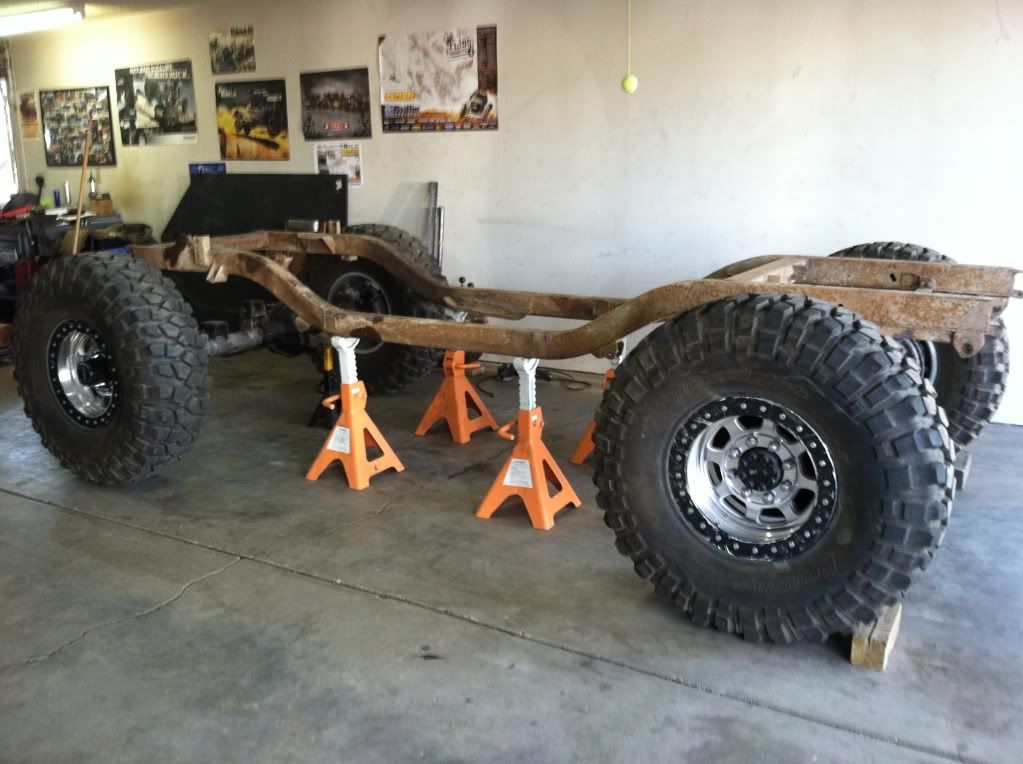

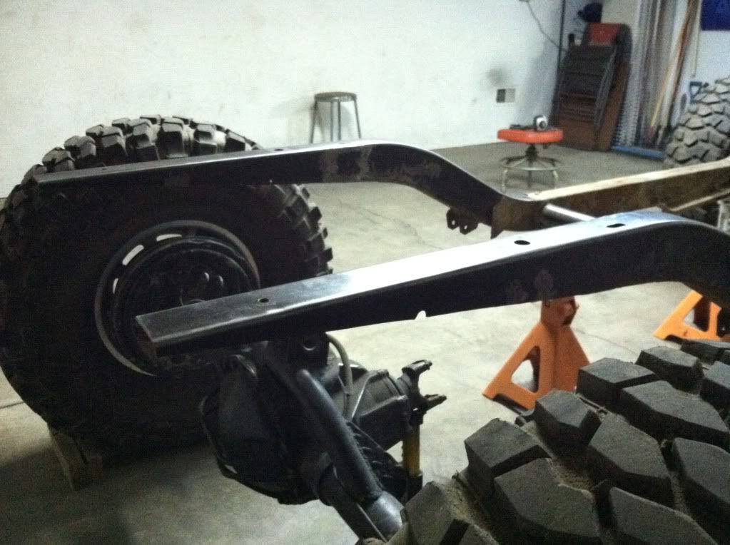

#2 ·
Shaved the rear section of the frame, on to the subframe.

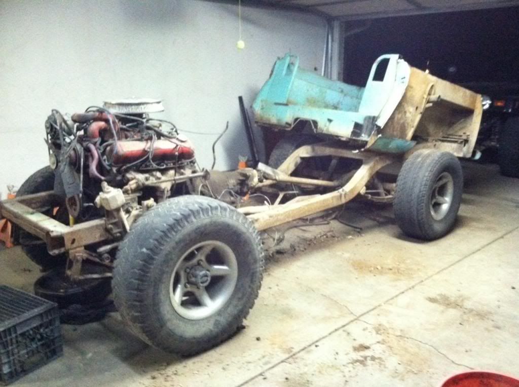

#4 ·
Motor mounts and tranny mounts are in, time for rear control arms and truss.

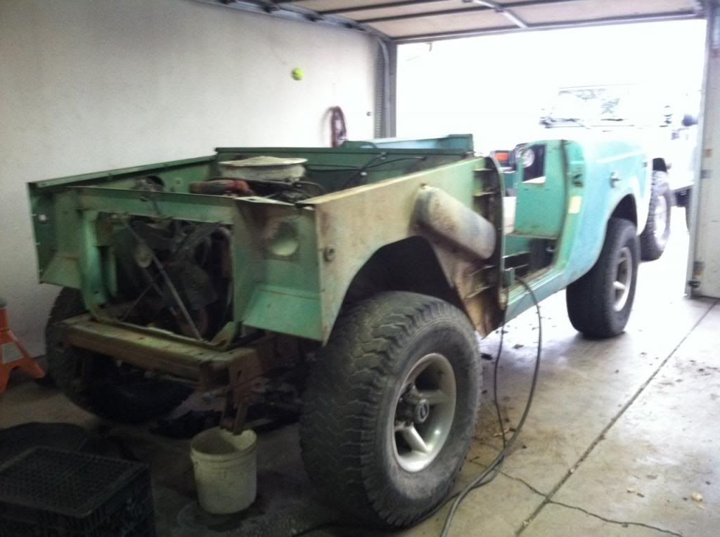

#5 ·
Getting after the tube work and the new shoes showed up!

Thanks, since I was using a stock frame I thought I'd make some improvements.
The rear was shaved for better departure, the rear is also pinched in 1 1/2" on each side then straightened back out for shock clearance. Looks better too.
The gearbox decision is a result of reasearch, plenty strong in the rocks, and drives great at speed. I have friends that miss there assist which I will have.
