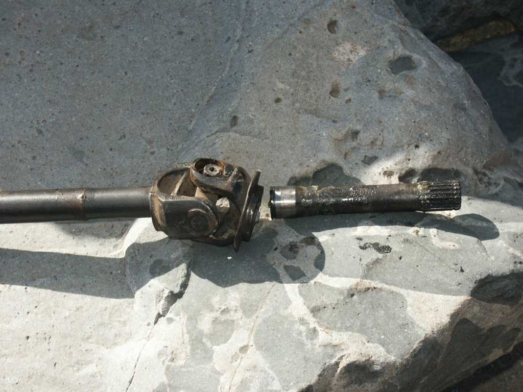

!!! MASSIVE research effort -please post pics/stories of ALL your broken axles !!!
I'm trying to compile enough data to actually be statistically relevant - or at the very least be enough to qualify as strong anecdotal evidence.
Please post pics of any and all axle shaft breaks.
Front and rear.
No big story required - just what axle it is, and it's age if you know it.
Stories without pics are ok and desired to (but will require more story to describe what/where the break was)
Between us, we have to have broken a huge number of axles - I bet nowhere else could you amass more data.
I'd love to collect as much info as possible on this.
Thanks very much for your help

Dana 44 front. Broke right behind the yolk. Seen 3 others break at the same spot. Sorry no pics. Axles were less than 2 years old.

44 front stub, right behind the yoke. Tire turned full lock, and bound up. Barely let the clutch out and...snap!

Stock '01 Ram front dana 44.
5-760X Ujoint tore the ears out of the shaft.
Locked up, full turn, backing up

10 bolt short side axle and stubs- always the ears on the yoke.
Dana 60 30 spline stubs, always shattered the splines, usually pulling sombody out with the wheels straight.
Dana 60 35 spline stub, stretched the ears, popped out the bearing cap under a full throttle turn going up hill.
14 bolt. Three passenger side shafts where the axle necks down from the machined area by the flange to the raw uncut axle. without posting the pic, but only showing the link- http://www.pirate4x4.com/tech/billav...e/DCP_6517.jpg right where the axle necks down.
No pics.

2 Dana 35s from a 92 wrangler, broke right at the splines, 2 dana 44 front stub shafts at the yoke from a 90 grand waggy.

Dana 44 front, stock shafts (~20 years old), 760 u-joint.
My tack welds on the u-joint caps tore, then the ears egged out, then the caps shot out or broke up, then the ears broke. This is in my Toyota, 100:1 gearing, 37" tires, front locker, happened while backing up a ledge.

Broke several sets when i was running 40" mtr's. Not single u-joint failure. All the breaks were on the shaft itself. Probably due to sever fatigue (ie. big ass tires). I have had good luck with 760's.
I am now running cromo inners from Randy's. They are holding up great. the spicer outers are doing what they do best...ovelizing. I've got two trips this new set. One at Cougar Buttes, one at JV an its time for new outers. Inners look great

D44, Warn CroMo's, Spicer joints. 37" tire, bound up at full lock. Not sure what went first, suspect the joint. Took out one ear on the stub and bent the other. Inner shaft was still usable. Took out the knuckle as well.

Long side at the neck down on a stock Scout D44 front. 35" tires on Cadillac hill. U-joint went as well.

D44 U-Joint & Long Side Shaft (at once)
37" MTRs Stock i6
Vehicle: YJ
Trail: Rubicon
Locked: Yes/Detroit
Front diff. high-centered turned into a tree root got traction with that one tire and snap.
35" BFGs
D30 Stock Axle
Broke U-JOINT
Pulling someone up a hill in reverse from the top using a front tow hook, barely giving it any gas and kaboom.

currie 9" front. currie inner shaft, 1/2 ton chevy stub. ears broke off u-joint first which took out the ears on the inner and outer shafts. less then 1 yr old. bounceing while on gas with wheels slighty turned. this is with 33's, 4.10's, detroit, and I-6
personaly i blame the autozone shitty ass u-joint.
By shattered - you mean fractured into may pieces/ Or "stripped" or ??
Can you estimate numbers?
By "at the splines" do you mean within the area that is splined or right at the transition from splined to non-splined?
d44 35" and v8 do i have to tell more
If you could - like - I see many destroyed yokes - any stripped splines or fractured shafts in that heap o' carange?
Can u put a number on "several"? Inners and stubs?
Can u say where on the shaft?
Confirm shaft failure was ears/yoke?
are we bothering with D30 and D35 stuff?
yes, please. Annonymously if u have to
Dana 44 front with 38.5" tires, 6 cyl engine.....broke a stock inner off at the neck down.
Do you remember long or short side
Dana 60 rear axles- at least 8
Front 30 spline stubbys - 7 in 2002-2001
Where do they break? Is it consistant?

I broke 3 Warn stubs that looked almost just like that. What was I doing? Well it seemed like when they broke I was doing something minor. Then I would think about the day before when I was hammering it to get up a ledge, bouncing it of the ground, on the gas, and it didn't break. But there was never a time where I broke a shaft because a tire was bound up. All shock loading.
