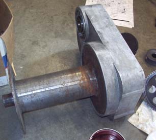

So I got a "winch" from gus. It came to me in 4 boxes. A friend of his gave it to him for some reason, but it came with some assembley required. :)
I the story goes like this. Bellview makes a winch, 6000lbs rated. Warn buys Bellview and then renames it the Warn Bellview and prorates it to 8000lbs. :)
There is no remote on this guy... All the winch controlls are cable actuated like a lawn mower or snow blower.
It looks a lot like a warn 8274 except has more external beef and a more 70s look to it. None of these things have been made since 1974, and this one looks nearly new.
I found a parts explosion view which helped a little.
So here is the pile of parts minus two of the motors. I got three motors with it, which was a mixed blessing...
The first thing I tried to do was eliminate motor parts from the winch parts. This goes in the back of the motor and is used to keep the motor from spooling out. Its kind of like a brake that allows cable in but now cable out. The Bellview has no power out...stock...hehehe :grin:
There is a spring, two blocks that look like giant keyways, a sleeve, the sprag thing, and a little pin.
It made me fell good to eliminate those parts because I wasn't finding anywhere else for them. The parts diagram is only good for confirming parts placement. Its really hard to read. I had to guess about some things. :)
So I stuck the drum in it.

Next I installed the three nylon drum bushings. I was surprized they weren't bronze, but I guess nylon reduces carnage. These sub 1k winches aren't that "high quality" anyway. :devil1:
The motor side drum bushings get lubed from oil splash, the other side is lubed from a zerk fitting in the very end (see the hole where the grease comes out).
Now I will be switching from captions above the pictures to captions below. :grin:
The highest speed bearing at the motor is lubed and sealed, the second highest uses nice ball bearings, the second highest uses roller bearings, and the slowest uses those bushings.
That large gear is the main drum gear. The small gear on the dual gear thing I'm holding drives the drum gear. You know how gears work...look at the picture.
When I was installing the 1st reduction stage I didn't use one of the "parts". I'm lucky I could get the little bearing back out so easily! I was wondering why there was .25" of .5" gas pipe nicely cut in the box. A closer look at the parts diagram and parts list shows a bushing/spacer. Without the little piece of gas pipe in the hole the gears wouldn't engage correctly.
