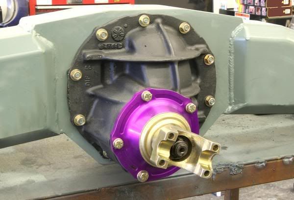

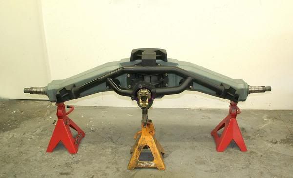

The new Atomic Axle product line from Overkill Engineering takes a radically different approach to solid axle design. The foundation for this new high clearance design is the arched steel housing. The housing is constructed from A656 80,000 PSI tensile strength steel and is equivalent to nearly ½" thick mild steel. The housing weighs in at 110 lbs. Atomic Axles are designed for the professional rock crawling competitor or desert racer, of coarse anyone can purchase the competition units no matter what their needs. All Atomic rear axles feature heavy duty full float axle shaft assemblies. The high angle faceted design provides superior strength and creates a natural truss structure for high impact applications, such as desert racing. The A656 steel housing allows custom suspensions to be welded directly to the housing using standard MIG welding. The axles can be ordered in various widths, axle shafts, and brake configurations depending upon your specific application. Atomic 1 ton axles provide a massive 5" of additional ground clearance over a stock Dana 60. A rig running 40" tires would have 19.5" of ground clearance. The arched housing actually peaks higher outside the center section for a total of 8" clearance over the stock Dana 60 or 22.5" ground clearance with 40" tires. Atomic front and rear axles use a Ford 9" third member housed in a high strength faced center section to preserve proper gear mesh under heavy torque load.. 1480 u-joints transfer power to the wheels. The housing's center section is sealed using standard Ford 9" outer bearings and seals. 35 or 40 spline stub shaft extend into the third member/locker. All axle shafts can be ordered with 35 or 40 spline shafts along with 1480 U-joints. The front axle center section is offset 4" and can be ordered with a driver or passenger side input.
Doesn't sound too good to me. Not that strong (9", 1480). Just a little more ground clearance. And the housing weight seems to be BS or it's not as strong as they say it is.
#22 ·
Seems like limited resource usage not to have every one of these axles as a steering axle...the CV/UJ is in there ANYWAYS, why not make use out of it...
#29 ·
not to bash a product or anything but I think I would rather have a portal-Tek axle for the same money
#35 ·
Don't forget you wouldnt have to run 49 inch tires with these. How much do people spend on portals to get them to hold up to the huge tires? These might be good for comp stuff where money is no object?
They have been out for a couple years. I dont think they would be that great for comp stuff, if they were we would have seen more of them out there.
