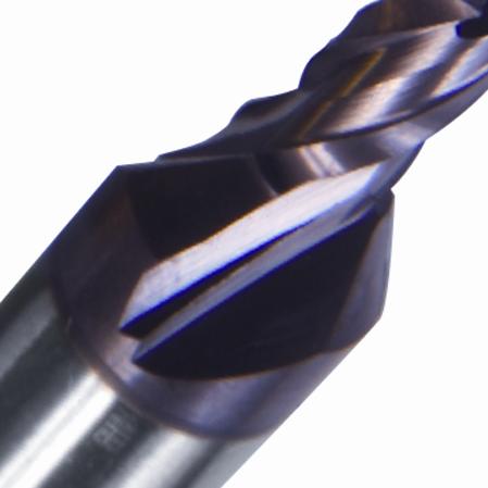

There are some cool coatings out there that are as hard or harder than sapphire. TiN is gold colored, but personally I hate gold, so I would look at:
TiAlCN is dark purple to black.
ZrN is a tan color.
