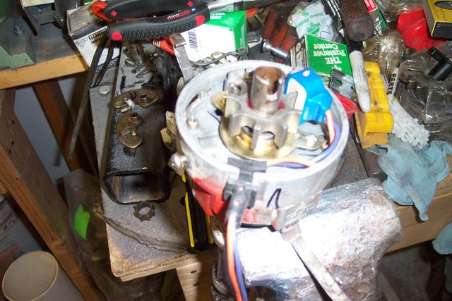

One Goldbox distributor now Duraspark'd

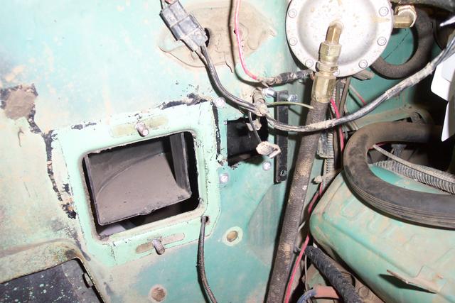

And a new hole in the firewall.
This should let me use the stock GM firewall plug thing, by pressing it from the engine bay to the cab, and using two pieces of flat-strap to hold it tight.
ECM wires come in in the "elbow" of the heater duct, and will then go up and over and mount the ECM under the glovebox.

Started to mount the HEI module to the distributor last night, too.

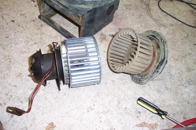

Discovered 1979 heaters use a larger fan than 1973. The aftermarket larger-squirrel-fan modification would only gain me a touch bigger fan, so I'm leaving it alone.
