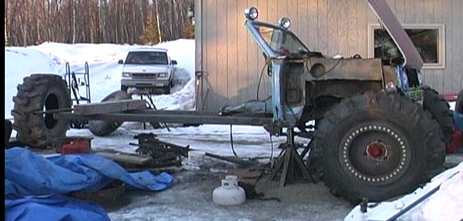

Found out my travelall was on its overload spring..
Now check this out. At that height, I have 6.5" of uptravel. With a ride height of 26.5-27", 6.5" of uptravel...
That picture isn't the one with the suspension. In order to get such a low height I had to chop the frame .75" in front of the engine mounts and extend the front frame up 14". The front frame rail in front of the radiator is now level with the fan center and valve covers. I should be able to update my thread by the end of this week with a ton of pictures.

Is that a little stubby propane bottle? or is it half burried?

im sure that propane bottle is a wheel stop
he just buried it for added stability
glad you got the camera fixed, that front end should be pretty interesting to say the least.

What's the turning radius on that thing? Hard to tell from the angle in the pics, but looks like you might need the whole state of Alaska to turn that bitch around.

I cut the bottle in half. here is a craft project for the whole family...
Go to a refil gas station for propane. When old cylinders expire people just leave them with the station. The stations love to have people haul them off.
Okay, now cut them in half. Drill three holes in the top and bottom to attach them back together with .5-1foot of chain. Instant redneck flower planter.
I use that one as a wheel block, jack stand, whatever. Its just a tool of the trade. There are a few pictures of it being used as a wheel block in the build thread.
I don't know what the turning radius will be. I think I have 24-26* of knuckel travel before the tire hits the radius arm. It can turn way more than the deuce steering stop.
But you don't think I'm putting the rear axle at the end of my frame extensions do you? That rear frame is going to be hacked WAY down.
