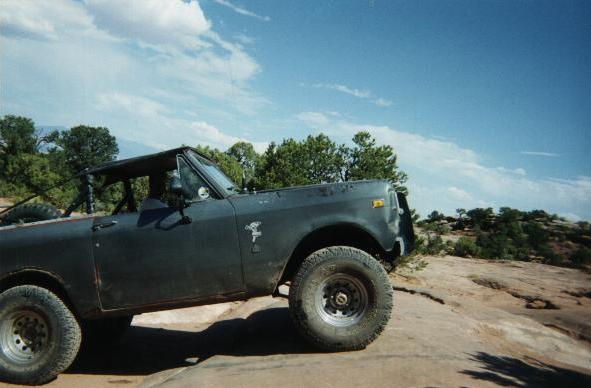

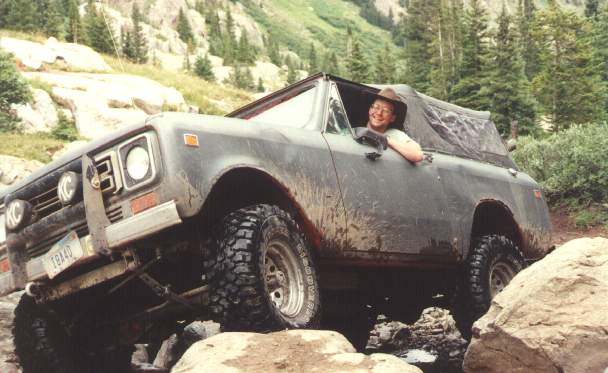

I've been running 4" Skyjackers SUA since 1997.
It was my daily driver for years, my tow rig for a while after that, and has always been my wheeler.
The rear was swapped out for SOA because it just didn't yield enough lift. It sits pretty level now with SOA rear, 4" SUA Skyjackers up front.
Rides nice? Dunno. Rides like crap compared to my Buick.
The shot body mounts and dented shocks probably don't help, either.
I have the 4" Triangles on my current DD Scout. My wife thinks the Skyjackers ride better, but doors that close, less rattles, air conditioning, and all of that seems to win her over for best overall experience on a 1000 mile drive vs. the square-tired SJ equipped Scout. Especially now that it only has 2nd gear and needs the T19 R&R'd.
BTW, 33s rubbed on both Scouts - the 4" SJ and the 4" Triangles. Lowering the bump stops helped, and so did cutting out 3" of fender.
