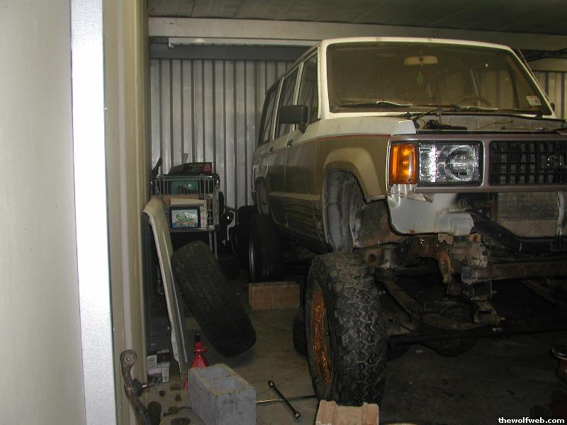

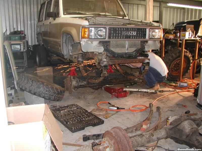

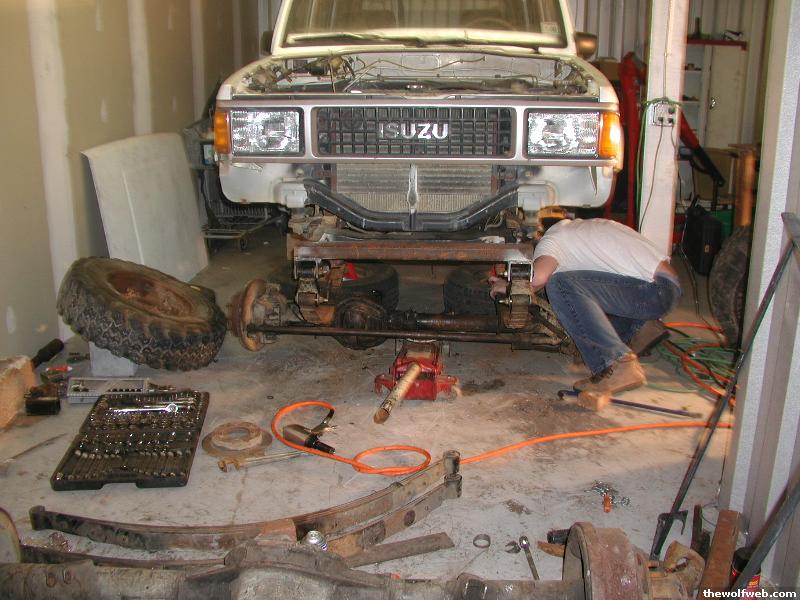

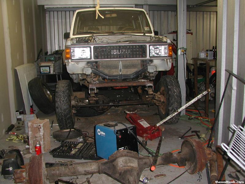

the 87 trooper is finally back on 4 wheels again... after numerous setbacks in locations to work on it, other projects, money, etc. we finally put in a couple good days in on it and got the front axle hung. still LOTS of finish work on the fabbed stuff, and of course smaller things like brakes, shocks, etc. but it's getting there. depending on $$, should be on the road in the next couple of weeks.
pic looks funny for some reason, the axle isn't really off center...

Coming along very nicely. So how far forward did you move the front axle vs. stock location?

I'd guess the axle is on ~2 in forward, not really sure we played around with the springs and shackle mounting some. We ended up having to mount front shackles to get a decent pinion angle. We were trying to keep it low, with very little drop from the hanger.

I thought it looked a little further back than most I've seen. Are you expecting to run into any driveshaft length/angle problems with the axle where its at? IIRC, most people have moved them forward 6"+ to get around those kinds of problems. Keep posting those pics!

i believe the axle actually ended up closer to 4 inches foward as it sits now... we still have a little adjustment in the mounts and could bring it another inch or two up. we shoved it as far up as we could without having to worry about steering box/arm changes. we're not really concerned with the d-shaft, if it doesn't work out well it's a good exscuse to lower it some. we'll also be adding a divorced t-case eventually, which will alleviate any problems. the crossmember is def. going to need a hoop cut into it before we can even begin to check out the front shaft. i'm pretty pleased with how it's turned out, there are only a handfull of SAS troopers. we mixed and matched a few ideas from the ones out there, and threw in a few of our own. so far we've only invested about 250 dollars in the SAS part, so we can't complain.

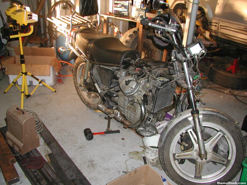

Planned on rolling it out last night, but instead got our $50 '78 Honda CX 500 running.

we're actually not as far foward as most people have gone. hanger mounts right off the front of the frame. i'd guess 3-4 inches foward of stock maybe. we're trying to get the height down some, and we're using a crossover/high steer arm on the passenger side so the tie rod should be a non issue. for now, we're going to use the ford tre that fits the isuzu taper. at a later date may have the arm reamed to accept a bigger tre and from the bottom. driveshaft will be out biggest concern. we have a very nice pinion angle with the knuckles in the stock position. crossmember mods will definitely have to be done to hook a shaft up. once we bring the heigh down some, the shaft should work out pretty well. we're not extremely concerned if it doesn't work out perfect, since it'll be getting a divorced np205 case eventually.
