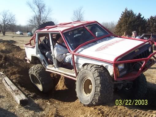

My exo and boattail.
New exo built with the rear fenders moved inboard +- 4".

Nice rig.
Do you have any pictures and info about the rollcage set-up?
I dig the way the the exo is set-up with the internal bracing.
I always like a boattailed rig.
How about some more details about the rest of the rig.

Specs: at the moment rear Cherokee 44, front 30, 456 and detroit f/r.
-Iroks 36-13.50-15 bias pl. rear buget lifted with an original xj main leaf 3 leaf from a chev blazer and 1.5 longer chackles. Front RC 4.5 spings plus 1.5 added spacer.
-IW: front d 44 fullsize 513, detroit, rear 9" 513 detroit,
-hitch will be moved up to the bumper and a new tube added under it.
-The rollbar inside is tied to the exo with two plates "sandwiching" the top.
bodtail,boattail... I prefer shaved also.

Its dove tailed.
not bobed
not boatsided
not backhalved
not frenched
not boattailed, that would require more fab work, and an outboard motor
Now if it was a bobed back-halved and dove-tail, now were talkin.
I like the front fender bars under the fenders.
I would add some tube at the top of the rear fenders, youll hit them alot.
Id moove the gas tank up through the floor and get that hitch gone or make something higher.

It's moved aprox 4 to 5 inches per side at the light area, starting afther the rear doors.
the original lights are gone and the new light area is aprox 2 inches shorther.
randon pics of the interior rollbar.
I may add the tube over the rear fenders on a later date, for now it will be tested at Tellico (the Cherokee crawl) and changes made lather.
