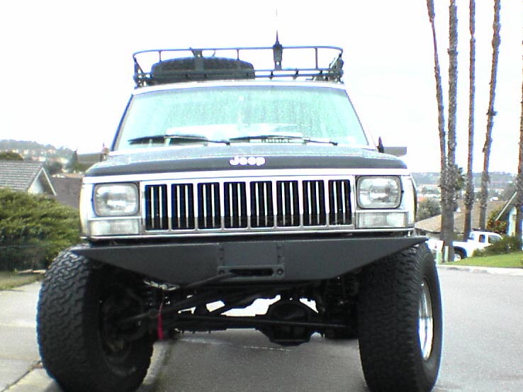

Heres mine.. Front and rear built to match, out of fork lift fork extenders, everything basically 5/16" to 1/2" thick.. a few gussetts are 1/4".. Also the clevis tabs i made each out of 2 pieces of 1/2".
I cut out and bent the ends to go along the contour of the lower quarter. Yea i know ive got a gap between the bumper and tail lights. Fixin to fab up some tail light boxes inwhich will fill in that gap.. As you see i added a 2" reciever adapter to both front and rear for a remote winch bracket.
