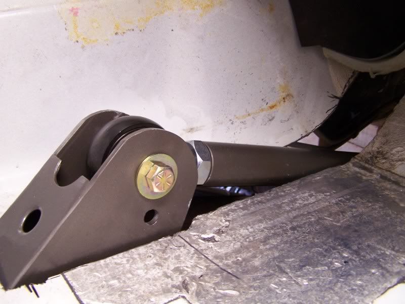

Got any interior pics with that cross member installed? How much floor is left on the passenger side?
Not his, but mine is similar. Here's a few shots:
(axle is drooped a little in this picture hence the link it aiming down)
[COLOR="Sienna"][SIZE="1"]-Bill

Heres the three link on the front of my ZJ. I went drivers side as the exhaust for the V8 was in the way on the pasenger side.
New crossmember, three piece, sides welded and this raised the drivetrain up about an inch.
Here is the drivers side mount for the lower and the upper. this part got welded to the frame. About 5 inches of seperation.
Here is the truss/upper mount that I went with. figured the 30 could use the help.
Dont use square for the upper, its very tight in there. Fits, but tight. Going to replace with round one of these days.
Yep, tight.
Flexes real good!
Overall I love it. Rides good and climbes like a goat. I mean, I showed up a built and stretched TJ with 42's on a wall climb once. It was no fluke, I did it several times with ease and it and none of the other 6 or so rigs with us that day could do it. It just hooks and goes.
