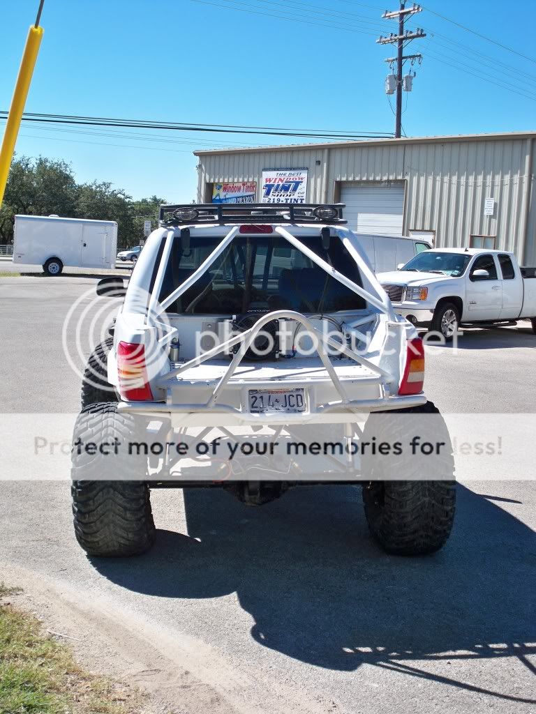

1999 Jeep Grand Cherokee (WJ) Upgrades and Fixes
-4.7 with 8 Angry Hampsters
-Dana 300
-60's Front and Rear
-ARB Air Lockers
-6:17 Gears
-38.5's (soon to be 42 Iroks)
-Twin Sticks
-Turn Brakes
-Hydro Assist (Soon to be Full Hydro)
#7 ·
Looks pretty damn nice man. With a little ingenuity you can cut about 3 more inches out of all your fenders, and give yourself a shitton more uptravel. I cut my rear wheel well in half and shifted it back about 3.5" so I could cut the fenders out more. It stuffs the tires up NICE, but I'm only on 36's. You could go further back with the rear half of the well than I did if you did something with the gas filler lines
