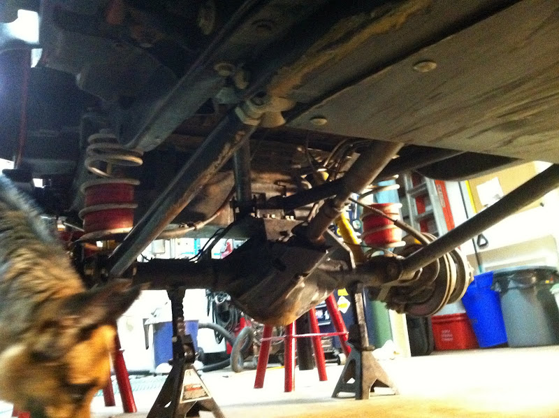

Got a chance to go over the suspension, tighten a few things, and take some more pics...
I need to relocate the upper rear spring mounts, but so far they haven't seem to be lacking any performance.
Here you can see the clearance that was made to the Kilby gas tank skid to the clear the 14b with the Ballistic 3/8" diff cover.
I marked the area that it needed to clear, plasma cut that section out, flipped it inside-out and re-welded. The tank sits in the skid cradle a little snug, but it's a little flexible and seems to be doing okay. The only issue so far has been when I fill up the tank. It seems to expand and when the pump shuts off, it pukes back a little gas. No major issue, but I thought I would mention it.... a lot cheaper than buying an aftermarket aluminum stretch tank for $600 plus.
My garage helper was curious to see what I was doing...

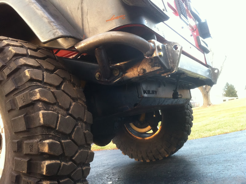

Now that I have the rear tire in the tub, I began working on the new rear bumper.
Similar to the flush bumpers, but with a little more beef in the mounts… What a PITA to cut these out with a porta band, 4.5” grinder, and jigsaw. These are 1” thick.
I’ll be keeping the frame tie-ins I previously made for the old bumper and adding some additional mounts to the sub-frame. I’ll also taper the ends and some corner guarding to protect the “schoolbus” like rear end of the LJ.

Rear bumper is done. I'm concerned that the corner guards will get crushed over time since they are only .120 wall, but they can always be replaced. Overall, I think the look is growing on me, but more importantly I reduced the rear overhang by 4" and dropped about 60lbs off the rear of the Jeep. Add that reduction with the rear tire relocate, takes a lot of weight of the rear of this pig.
I added some reinforcement plates to the frame

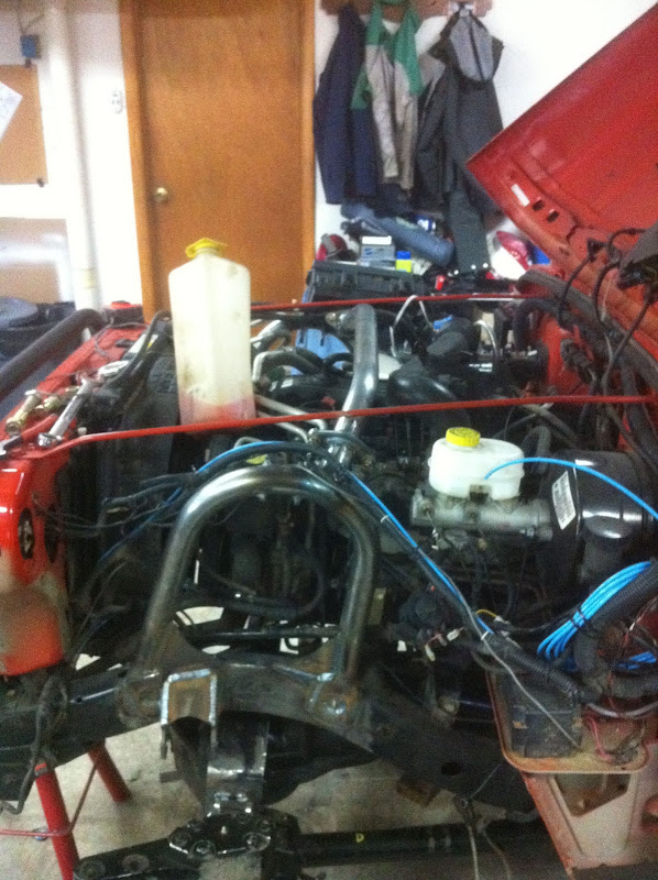

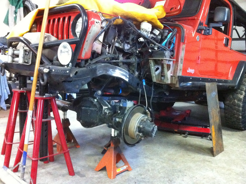

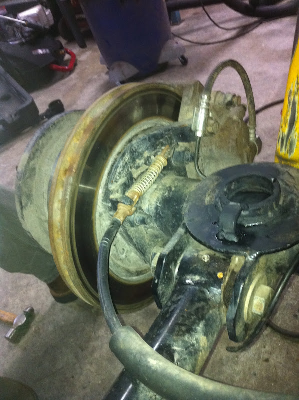

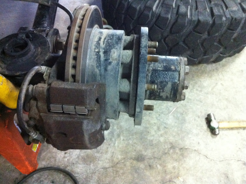

Also used some tax refund for some 14" STX ORI's for the front. The overall goal here was to get rid of the coils so that I can increase the front track bar length. I had to remake the frame track bar mount for the 3rd time (which is not the easiest to remove the from frame, especially if you are working on the ground).
I used the Genright coil over kit at a guide (just by viewing the online pictures), but made the decision to integrate the shock tower brace on the rear of the mount instead of the front (near the radiator).
I searched the internet and found that most guys with coilovers use the Buick 3.8L air box from the mid to early 90's (or they use a cone filter which I'm not a big fan of). I hunted all over the junk yard to find one of these but was unsuccessful. I did however find an air box from the lat 90's Dodge Avenger was about the right size. In the end, I gained 9" of length for the front track bar. This should aid with the excessive bump steer when driving on the road.
Using 115psi in the lower charge and 350psi in the upper for 4" of up travel. Seems to flex pretty well, but have yet to get it out on the road.
I'll get some pics of the air box mod later. Shakedown run planned at RC this weekend.... I'll report out later. Here's the driveway flex shot;

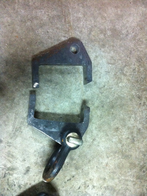

Rc 4-13-12
RC went well. Nothing major broke, but the rear spring on the passenger side did unseat from the lower axle mount twice and get pinned up against the caliper. Once on Otters trail (didn't realize this until I was all the way through the trail) and once in the Comp area playing around on one of the hill climbs. It was an easy fix on the trail, and I just need to make some spring retainers to permanently fix it. Overall, I'm really impressed with the ORI's as they performed outstandingly. I can't wait to get the funds and time to put them in the back.

Excellent build... Any more pictures or details on the rear brake setup? Maybe the brackets?
lilgreenjeepyj is offline   Reply With Quote Quick reply to this message
Old 04-24-2012, 07:08 PM   #49 (permalink)
Join Date: Nov 2005
Member # 56647
Location: South Central PA
Posts: 112
I removed the factory 14b drum brackets and made my own that matched up to the Ford brakes. Sorry I don't have of the brackets after they were cut.
The only downfall to this set-up is that the calipers do not sit up high on the rotor due to the e-brake cable orientation. They also stick out from the inside of the wheel (towards the center of the axle) about .75" further than they need to since the rotors are for a semi-float 60. (i.e. the rotor hat is wider to cover the axle flange.)
There are always compromises with any set-up. This seems to be working well (the e-brake will hold the Jeep no problem, even on a 45 deg grade) but I may have to replace a few caliper slider pins every now and then.
Also added some rear spring retainers.
I used Ford Explorer passenger rear brake lines for the flex hose.
This is probably the best picture I have of the bracket.
