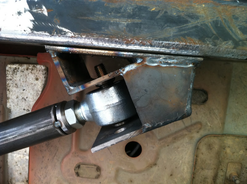

For the suspension, I decided I wanted long arms; 4-link single triangulated (uppers) in the rear and a 3-link in the front. I debated on buying an off the shelf kit, but decided I would build my own. I started with making a 3 piece cross member (2 brackets on each side of the frame) and a center skid. This meant that I needed to support to the transmission and transfer case separately. Based on my previous experiences with the Medic skid and performing maintenance, it was important to me to make the cross member skid removable without having to support the drive train. I used some 1.75” DOM and poly bushings with mounts welded to the inside of the frame. The members that support the lower control arms are made from a 10” wide, approximately 30” long, piece of 3/8” bent in a “Z”. I reused the 3 factory mounts in the frame rail, added two more additional nut-inserts (one on each end), added a mount support above each CA joint that utilizes a ¾” bolt sandwiching the frame with Frenched in crush sleeve, and a center support to aid with distribution forces from the skid. The center support utilizes ½” bolts.
Rear upper frame mounts
dirty_harry15 is offline   Reply With Quote

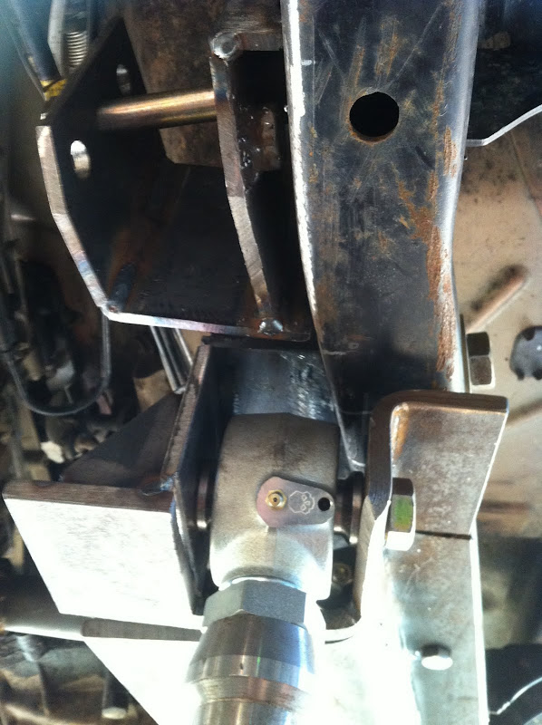

Front upper frame mount
**Note: I later had issues with front drive shaft clearance and the front upper control arm mount bolt. This is mainly due to the size of the joint that was used and the location of the mount. But I remedied this with having the front factory driveshaft cut and stepped down to a smaller (but thicker wall) 1.5” where the bolt resided. Is used Quigley4x4 (makes the conversion vans) since they were local and they were very helpful and reasonably priced to make this mod.

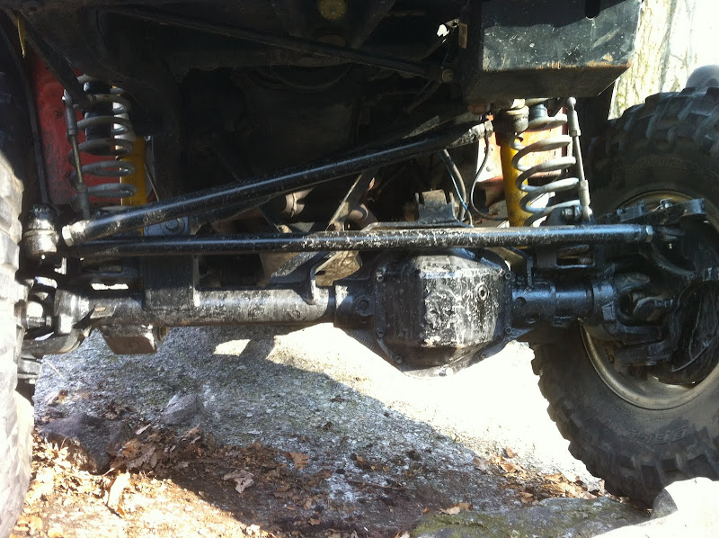

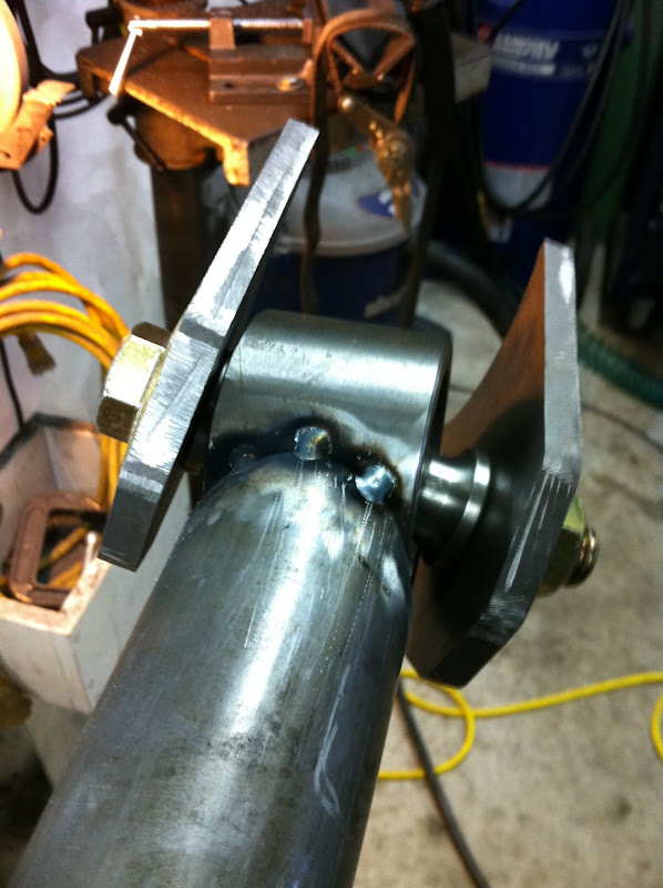

I used Ballistic 3” joints with with 2.25”OD x .25” wall DOM tubing for my lower links and Ballistic 2.625” joints for the uppers with 2”OD x.25” wall DOM tubing. I know that this is probably overkill, but I knew the rig was going to be heavy and as long as it’s at the lower portion of the rig, I decided it only helped the low CG theory…
At some point during the build, I found a sweet deal on set of 37” Blue label Krawlers. This actually worked out to my advantage since I wanted to get this thing on the trail sooner. Because I used the 37’s instead of the planned 40’s, I did not need to make a set of tube fenders and deal with trying to maintain flare coverage to pass inspection.
For the steering, I used GM one ton TRE’s with some 1.5”OD X .375” wall DOM. I had to flip the BTF high steer arms so that my drag link did not hit the frame when fully compressed.
Front Track bar; I had already previously removed the factory casting on the frame and made my own mount to accommodate a 3” Ballistic joint and thought that I would just reuse it when I went to one tons, but it didn’t work out. So I made another mount and moved it forward too so it would clear the D60 truss at full compression. The trackbar is made of a 2.625” and a 3” Ballistic joint with a 1.5”OD x .6875 wall DOM.

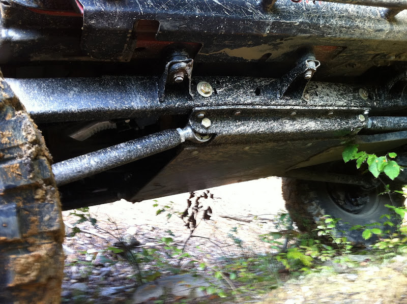

As for the fuel tank, I reused my Kilby skid but had to modify it to clear the 14b diff. (Unfortunately I can’t find picture of that at the moment.)
I also got really lucky during the final assembly as my driveshafts were the perfect length. I only had to swap out the rear 1330 u-joint for a 1330/1350 conversion joint.

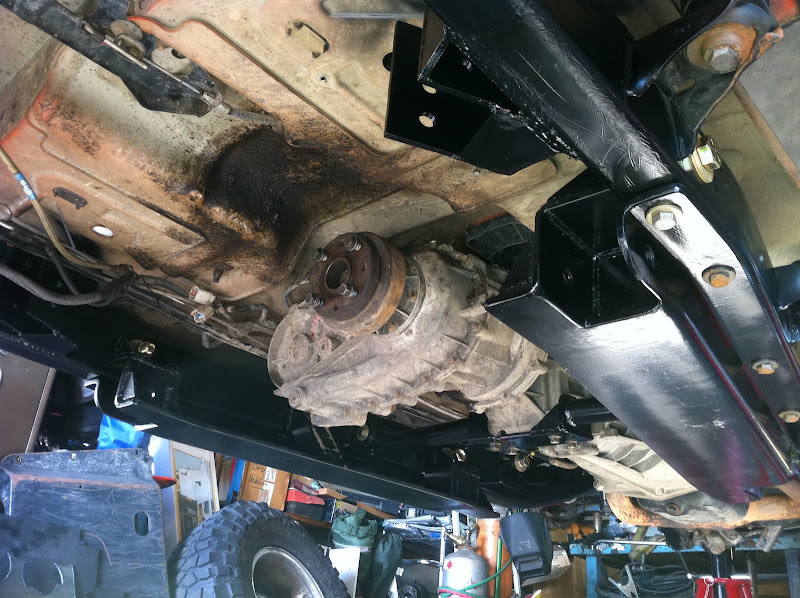

Here are some more pics of the build in no particular order:
Rear before paint
Front after paint

Typical practice is to leave the front axle wider than the rear. This does help with steering radius but I was always under the impression it was for tracking capabilities (on road characteristics).
My steering radius is worse now... Larger tires, short axle, but it's managable on the tight trails.
