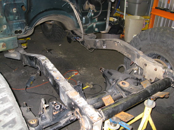

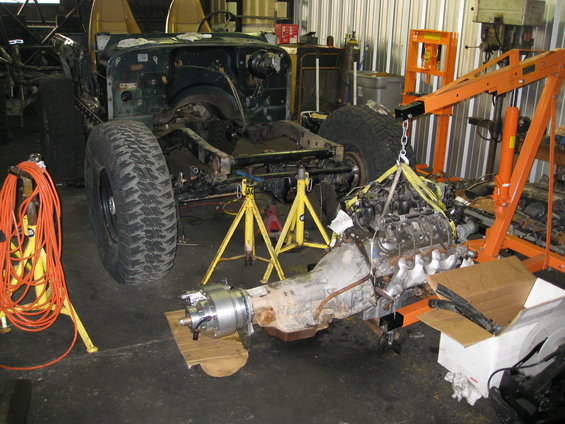

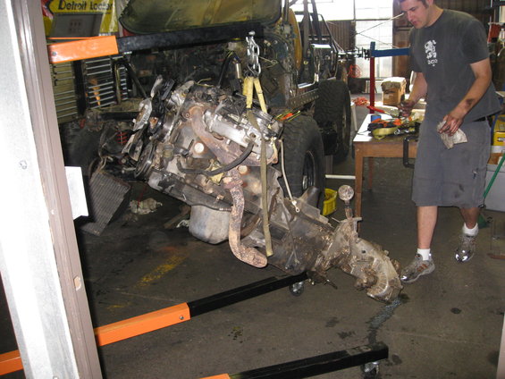

The drivetrain came out way too easily!! BTW this is all for sale.
The frame was stripped of all unnecessary brackets
The new drivetrain awaits...
A F-body camaro oil pan was installed to gain 3" under the motor. A new dip stick, windage tray, and oil pickup was also required.

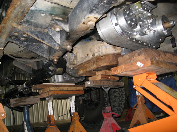

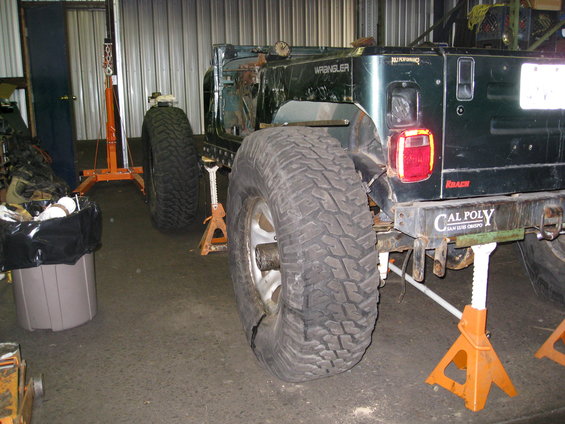

Ride height & drivetrain height specs:
Frame - 22" from ground
Clocked flat Stak - 21.5"
...the drivetrain now resides between rails.

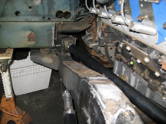

Some floor cutting was needed to attain the belly height

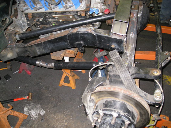

Lowers are nearly parallel to the ground. They were sleeved & lengthened... the lowers were actually 2"x.256 wall, so TRD machined some 1.5" tube to work as the sleeve.
Here is ride height... various other trimming, etc. required.

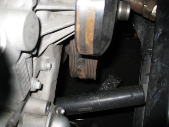

We discovered that the power steering pump is VERY in the way of the driver side upper link, so a bracket will be made to relocate the p/s pump to where an idler is currently.

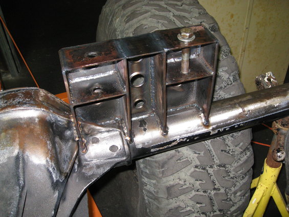

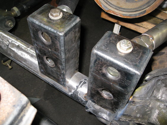

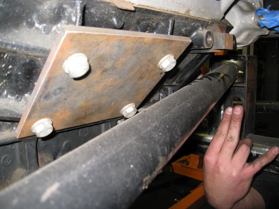

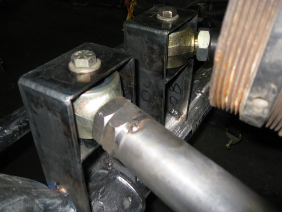

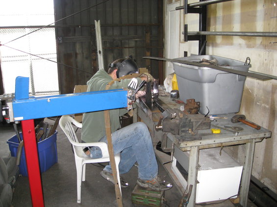

We got the upper link mounts made and tacked in place. They are 3/16 plate on the sides, 1/8 on the front and top & bottom plates that sandwich the johnny joint.
...TRD TIGing the axle side upper link mounts. Thanks to his skillz we are taking this project to the next level. I have been welding on brackets that will not be seen, so far so good!
And of course the dimple dies were busted out.
frame side -- had to cut the body mount a little to get this one to fit
p
The beginnings if a truss. It will get filled in w/more sheet metal (and dimple dies) and also have the ram mount, air bump pads, & coil over mounts all in a clean package.
...will update as progress continues...

i'd be curious to see how the joints on the front axle work since they're on their side.

ditto on the front joints being sideways like that, just don't see them like that usually. Also looks like your upper arms would want to hit the bottom of the motor when the front articulates, but could just be looks, I am sure you checked that already. The stance looks GREAT though really nice a low.

A lot of people mount the joints like that, but usually on the chassis side instead of the axle side. Some Trophy Trucks also mount a rodend like that on the rear axle. My truck is also mounted this way. We calculated the angle required for full travel and they will be well within the limits.
Building the mounts that way allows the truss to come up to the top of the mounts. We probably wont have it come that high but it is nice to have the option if necessary.
It will all make sense when done

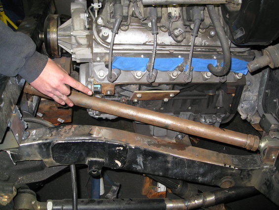

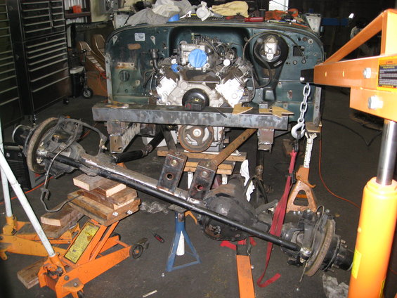

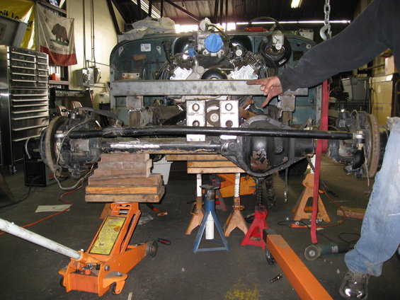

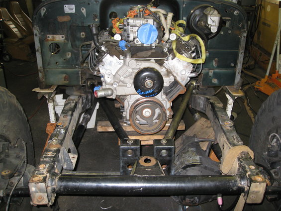

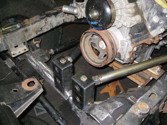

At long last there is some serious progress to report. We got stuck in a rut for a few weeks battling motor/upper link clearance issues at full bump. Just getting to full bump was the real issue... it involved cutting off the front frame section and settling on running a slight bend in the lowers to clear the stock YJ framerails. I came dangerously close to throwing the tub & frame in the dumpster. Have no fear, the lower links pictured are only for mock-up purposes...
Full Bump -- a temporary supa-bling crossmember was welded in to prevent the frame from going wacky after the front section was removed.
Motor mount plates awaiting... the mounts are going to be interesting.
The upper links straddle the block. You can see the need to relocate acessories high on the motor!!
After attaining full bump we were able to shift the motor back about 2". This was the deal maker for the front end! Check out all that clearance from the crank pulley to the upper links!!
The suspension was cycled from full bump to full droop... then articulated on driver & passenger sides to ensure nothing hit. Its all good! Now that the motor position is dialed in its time to build the mounts. They have to clear the upper links at full bump. They will be fully boxed in.

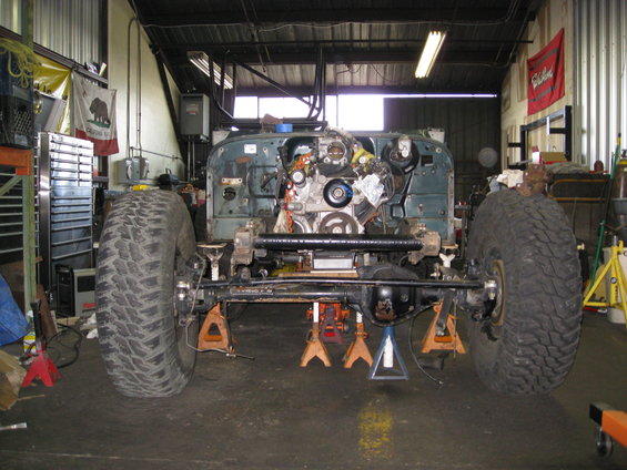

...checking for clearance issues while articulated. It gets a little scary when everything shifts around on those jack stands. I can't wait until its all supported on its own!
So its time to figure out the steering and get the truss going... The POS ram is freaking HUGE!! We mocked it up on the front end and realized that to mount it low enough to go to the stock knuckle arms (my original plan) the mount would have to stick 12"+ off the axle tube. I don't want a 60 with an underbite that bad! The ram is getting mounted high on the truss. Stay tuned.

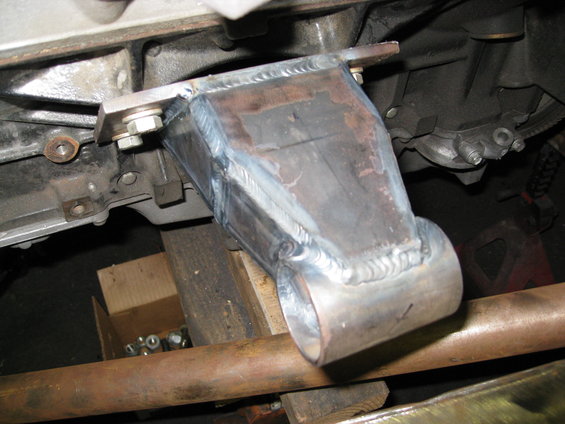

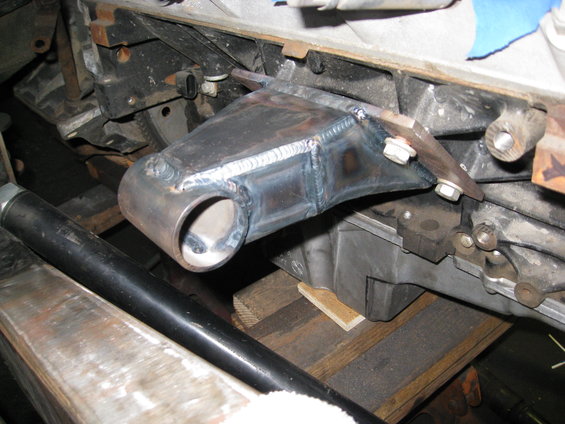

To follow up from last week the motor-side of the motor mounts are done. They turned out real nice.

Those engine mounts turned out really nice. Getting a rig that low is a headache, but you are doing a great job!
