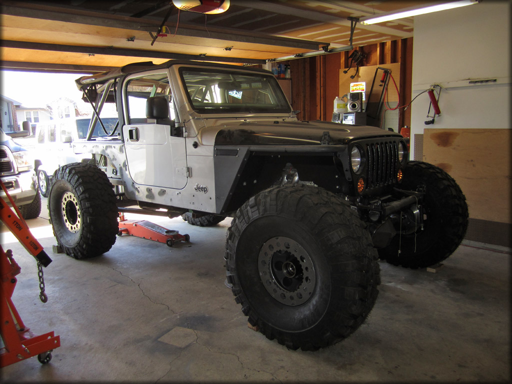

Pretty funny. Todd and I were talking about that just the other day.
Since I've owned it.
1.)
2.)
3.)
4.)
5.)
6.)
Soon to be seven.
TRAIL WORTHY FAB
Industry's Toughest Transfer Case

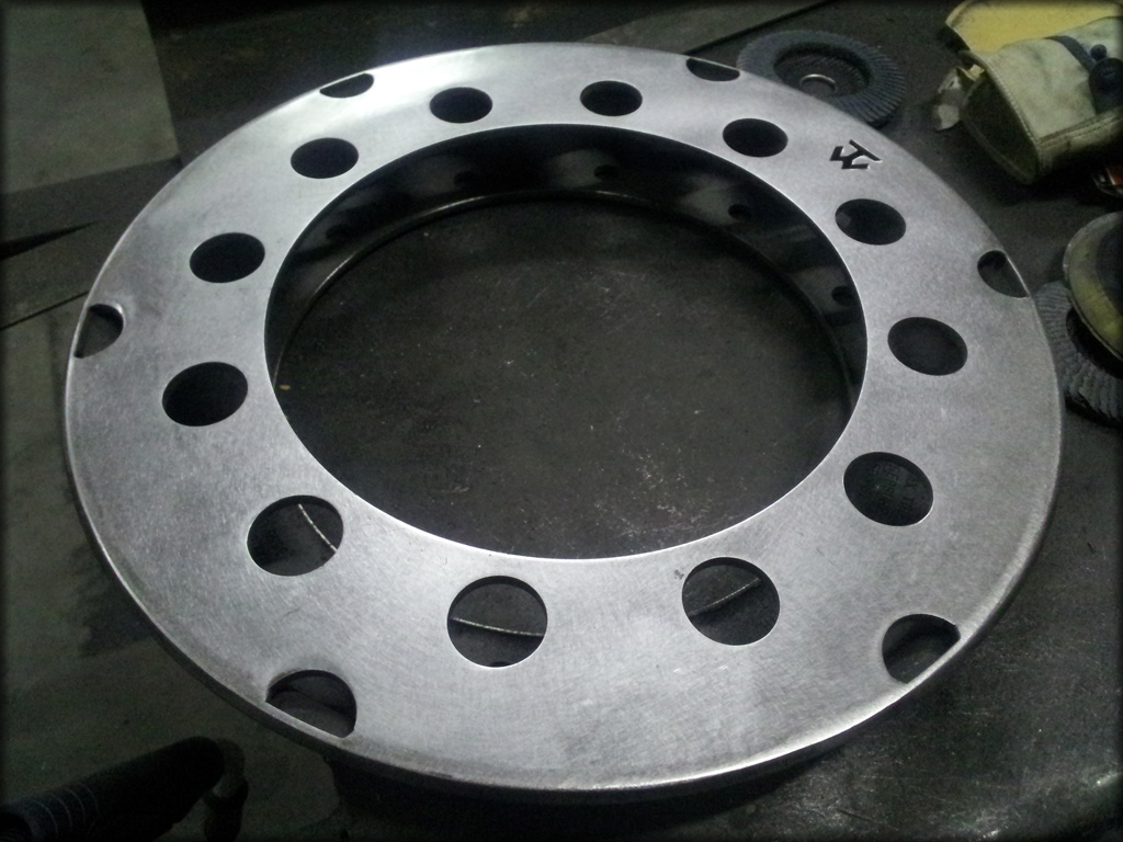

What tools and methods are you using to grind the welds and get such a uniform finish? Grinder with sanding disk? DA orbital? I see the flap disc in the background, but that is a pretty good finish.

It starts out with knowing you are going to grind them flat. You need to bevel the edge of the rock ring first that way the weld has some place to go. Otherwise you will grind the weld out of the setup when you knock it down. It helps to have a welder who knows WTF he is doing because a uniform weld is nice.
I use a 4.5" flap disk on my angle grinder. I only use 120 grit disks. Once I knock the majority of the weld down I go back with 80 grit sandpaper on the DA. You can really mess up the metal if you aren't paying attention. It just takes a steady hand.
Mick is our lead fabricator. He is the guy welding up the back shells and rock rings in the pictures I posted. I ground the welds smooth. It is a crap ton of work and almost a shame to knock down Mick's welds. The end result is awesome. It looks like the whole piece was made this way and not just an after thought.
We have a bunch of wheels headed to powder today so I should have them back by the end of the week.I will post up pics of the end result. The grinding of the welds has to be very precise because the powder I'm using shows every flaw.

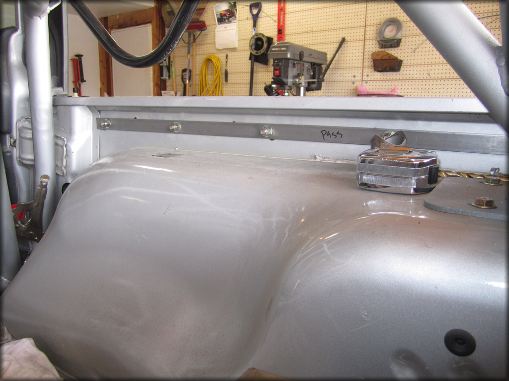

Made some backing plates for the corner armor to help unitize the tub. I have so many holes in the side of it from 4 different pieces of armor.

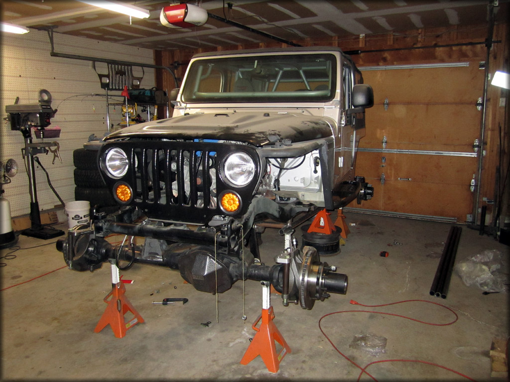

Back to jack stands. This message is Canyonmann approved.

that bitch is dirty and it hasn't even left the garage yet

I've washed it twice in my garage with a bucket and the hose!

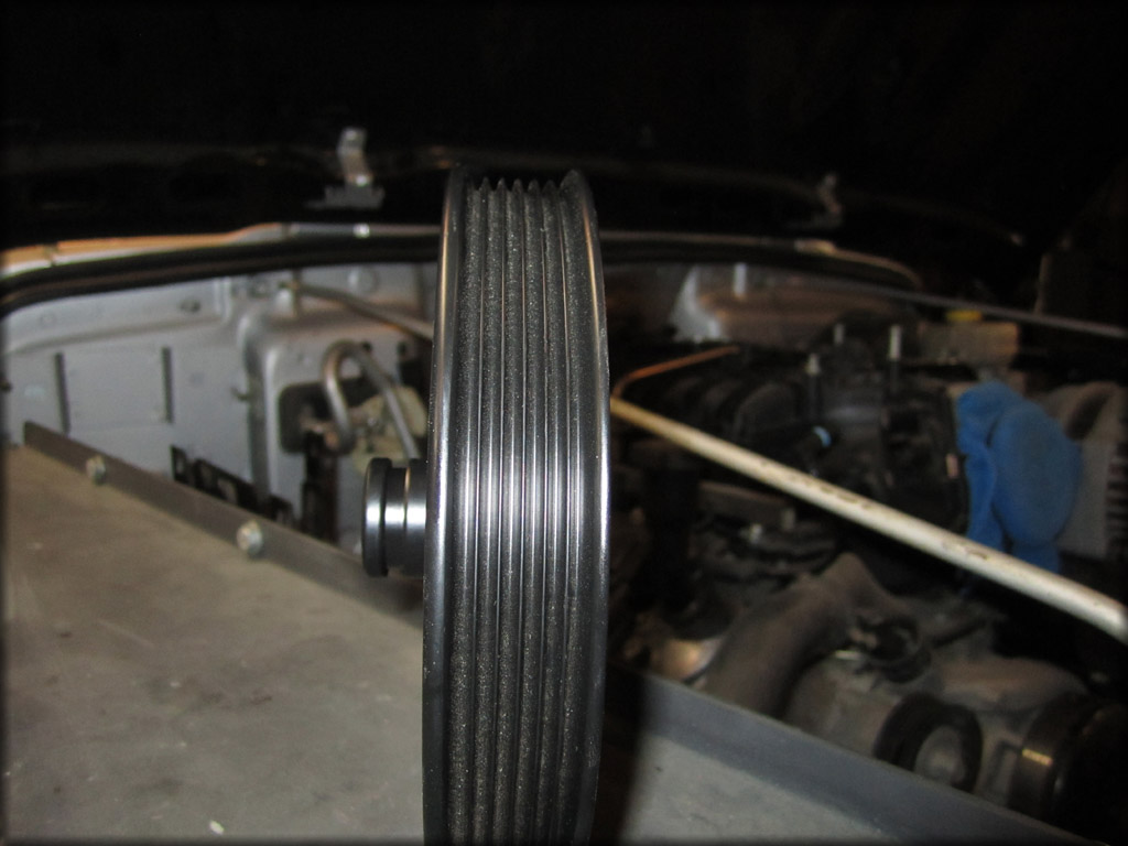

My PSC steering is scheduled to be here tomorrow. I needed a new power steering pulley so I picked one up local. 6 rib just like the stocker.
