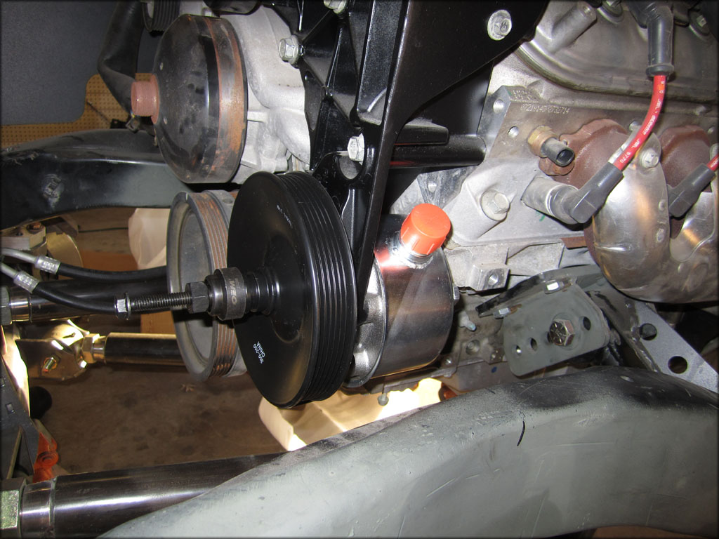

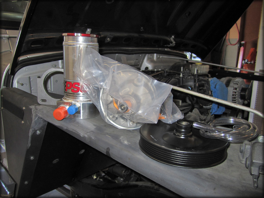

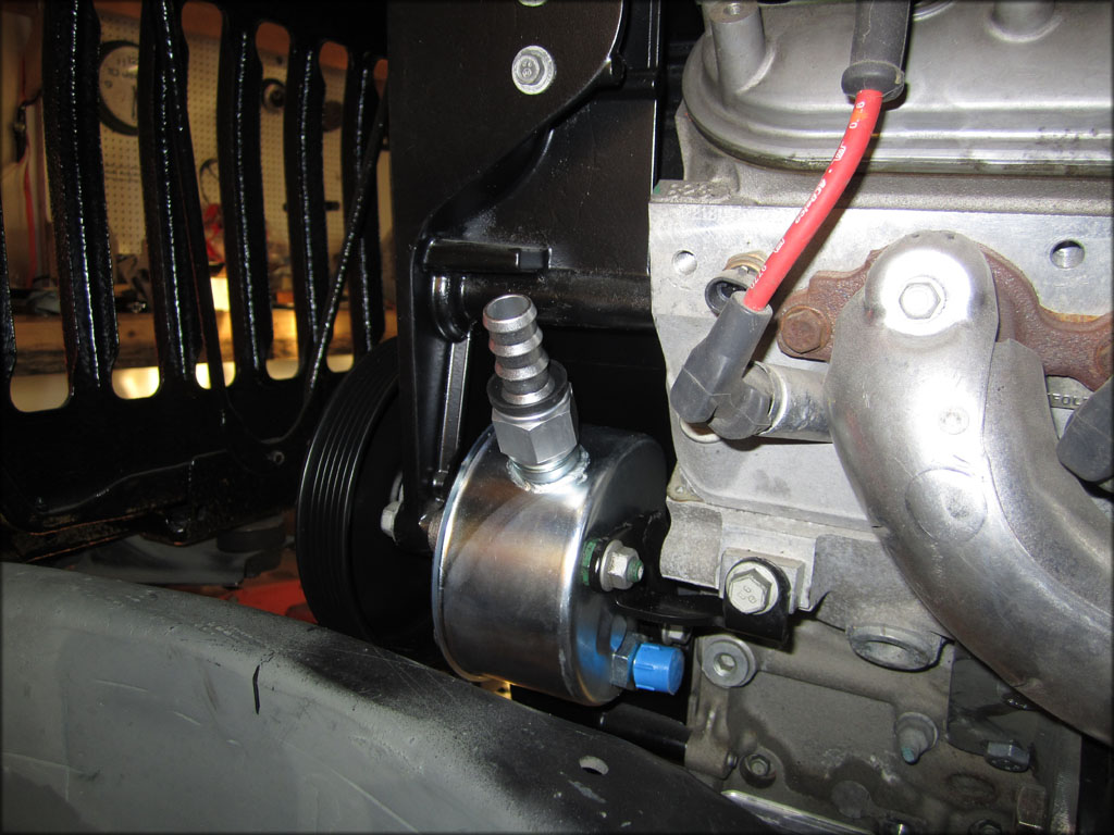

Pump installed and pulley installed the correct way.
Installed the stock bolts with the stock bracket on the back side. Everything fit really well.

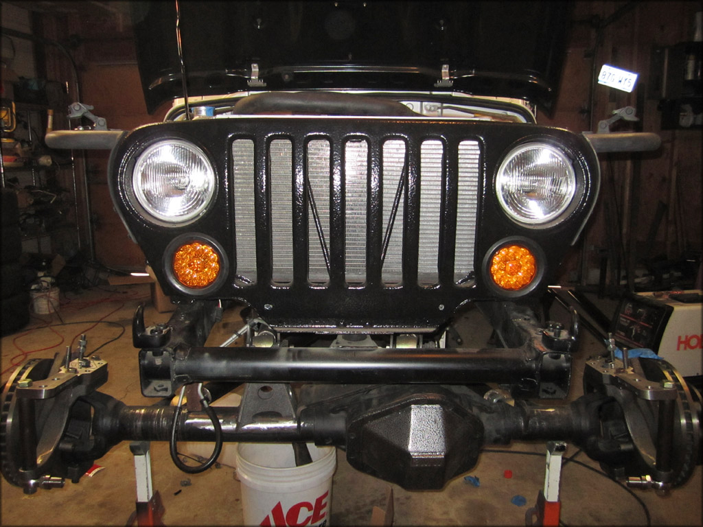

I'm about to order a few more parts from PSC. They have a slick way to mount a couple of coolers up front of the radiator. I'm going to use it to cool the transmission and steering. Check this out.
I will use the passenger side cooler for the auto and the driver side for the steering. Should be ample cooling considering how much air should move through the radiator.

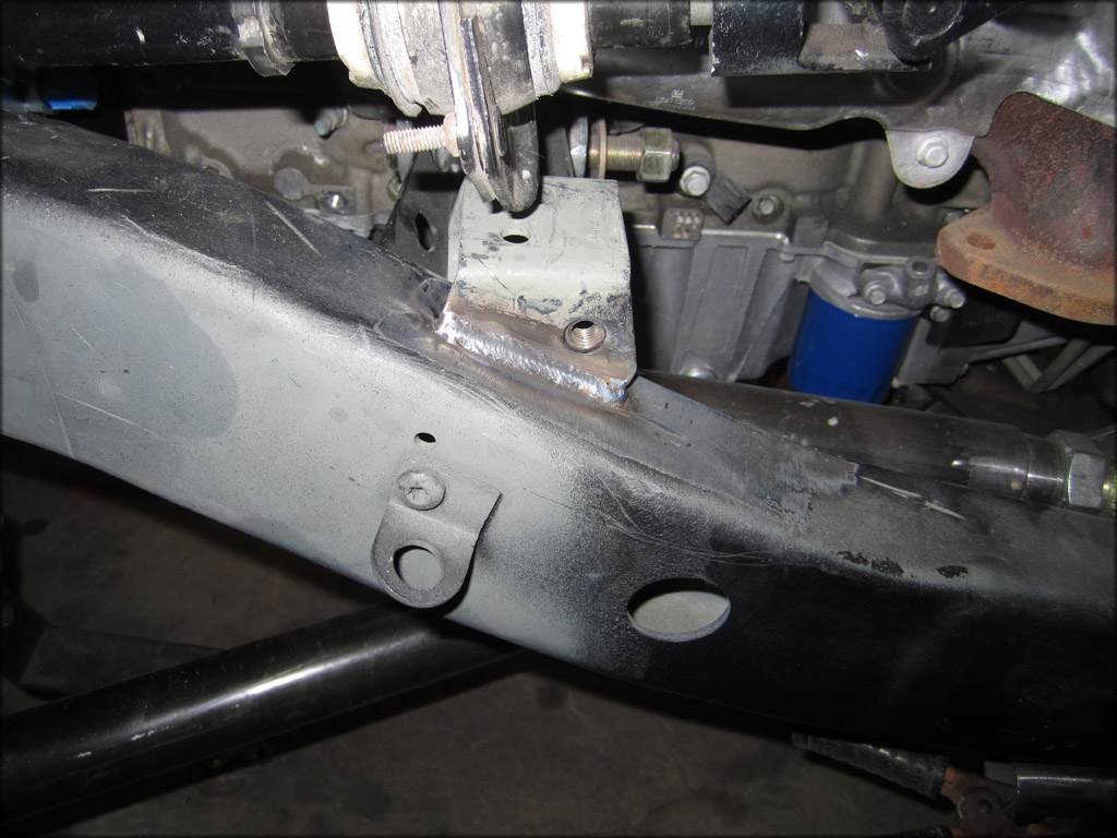

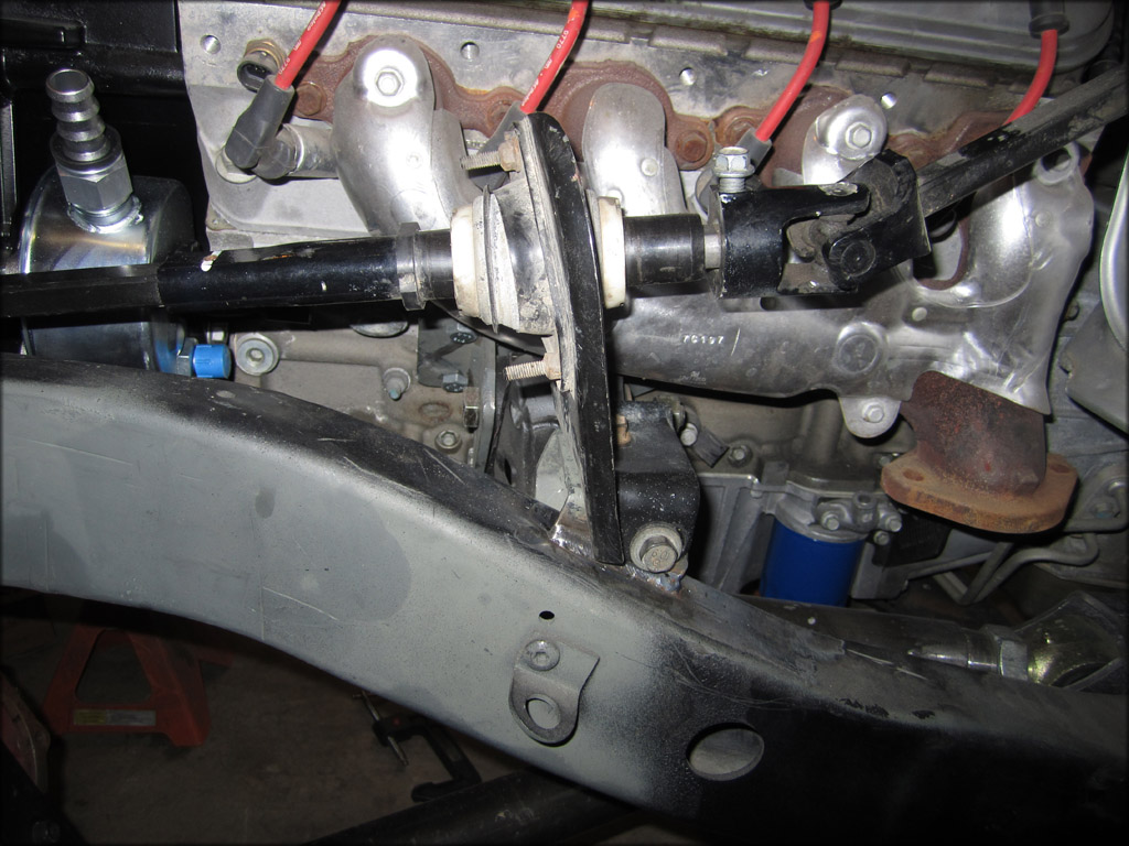

More progress. Got the steering column bracket mounted back up.
And final mounted.
Now I can mount up the steering valve.

Dual cooler setup ordered.

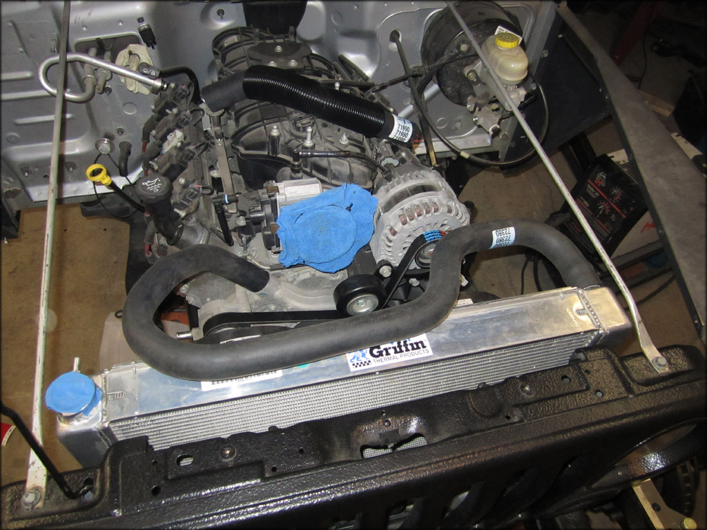

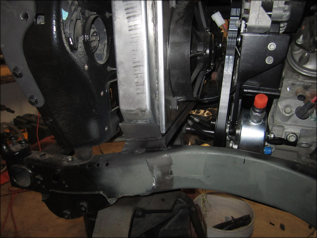

I got my lower radiator cradle built and installed today.

looking good! what's the number on that radiator? im searching for one for mine...that looks like it may be perfect

Griffin 1-55271-X
http://www.summitracing.com/parts/GRI-1-55271-X/

Do you have a part # for the radiator hose's?
Both radiator hoses are off of a 2008 Cadillac Escalade. I bought both from AutoZone.
Upper = E72380
Lower = E71990 and does not fit well.
The way the lower neck is welded on my radiator puts it at a weird angle so I will need to figure something different into the equation. I'm going to take that lower hose back and swap it for something different. If I find something that works out I will update you.
