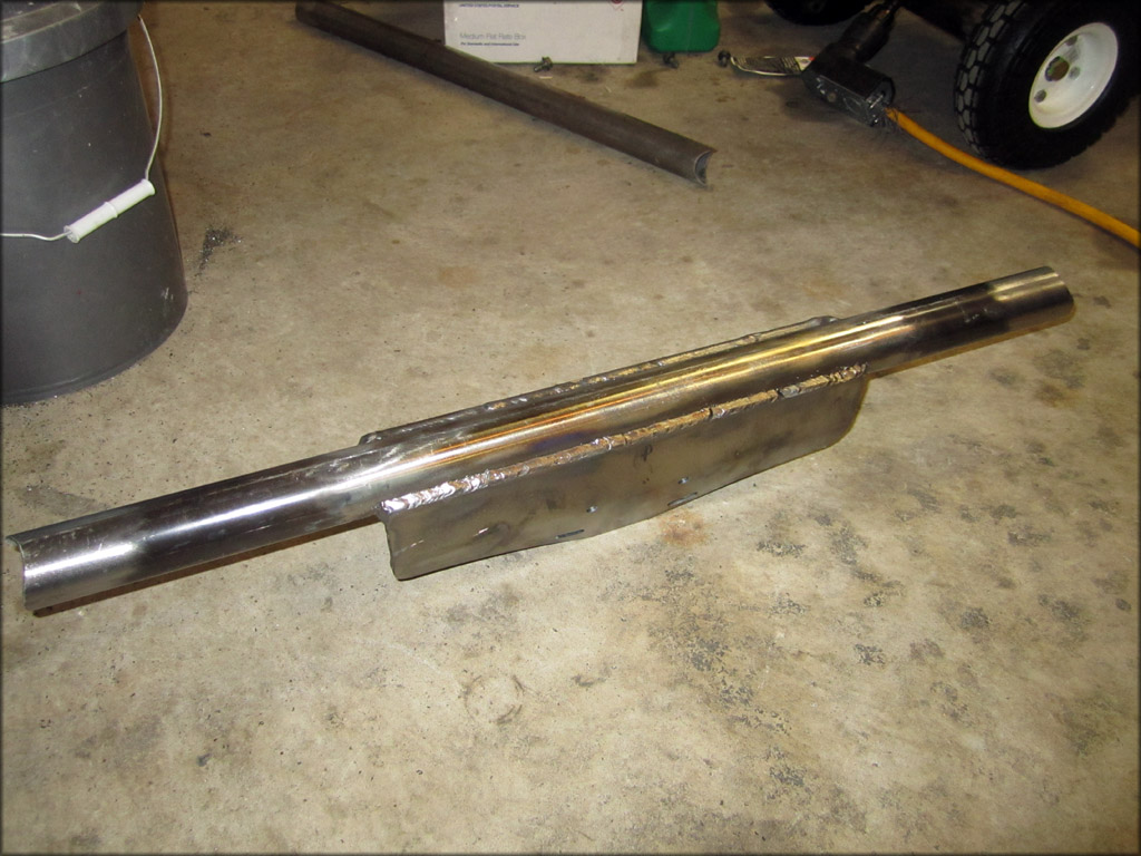

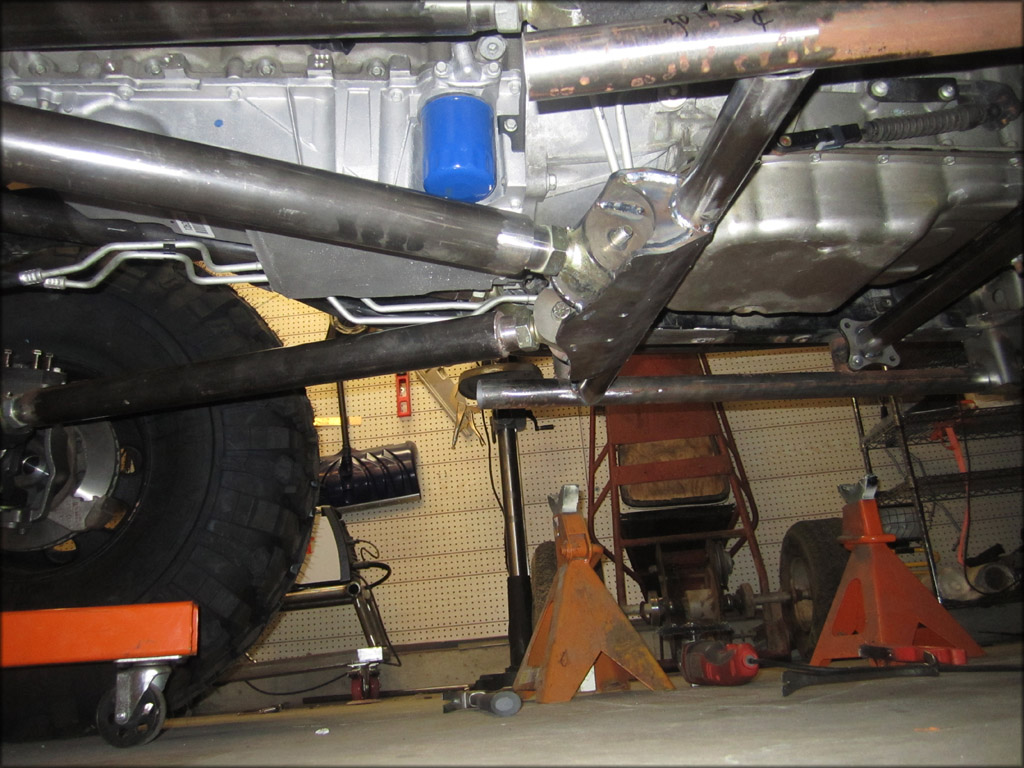

Got some more finished up this evening. I removed the temporary .120 DOM cross member and replaced it with the .250 then got it all weldered up.
I still can't weld. I need to get up off the ground and build me a weld table.
Then tossed back in place and tacked up.
How it sat after. This is one inch above full compression.

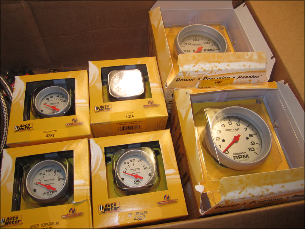

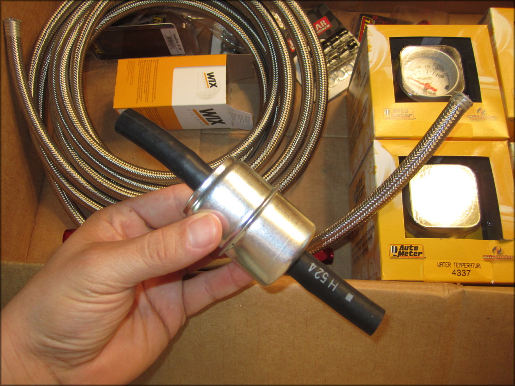

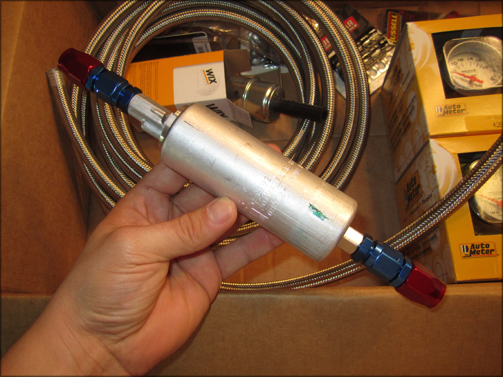

Got some parts today.
Gauges.
Walbro pump
I got this and already think I'm going to ditch it. I was thinking about what I did on my last jeep and the hose clamp quick detach wix filter just isn't going to cut it.
I gotta track down the fuel filter I used on Dookey. I can't remember what it came off of.
post up what you find. I'm about to order up something for mine. LI quoted me $650, but I really don't feel like I'll need all those shut off valves.

I remember there being a corvette name in there the last time. And the filter was 5 or 6 bucks. Easy to source, screws into place, had the GM bracket to make it easy to mount.
I've been looking online this evening but I can't track it down. I even looked up who built my fuel lines last time and they don't list it. I know I'd rather adapt a screw on fuel filter rather than using some ghetto hose clamps. Especially on the pressure side of the pump.
The search continues....

was it like this?
did it also regulate and return?
MR. HOGG is offline   Reply With Quote Quick reply to this message
Old 05-02-2012, 07:48 PM   #1462 (permalink)
WINNAR!
Dookey's Avatar
Join Date: Oct 2003
Member # 23680
Location: Wichita, KS
Posts: 11,794
Originally Posted by MR. HOGG View Post
was it like this?
No. I do not need the corvette regulator as my regulator is on the rail.
I'm thinking it probably came off a truck or something the more I think about it.

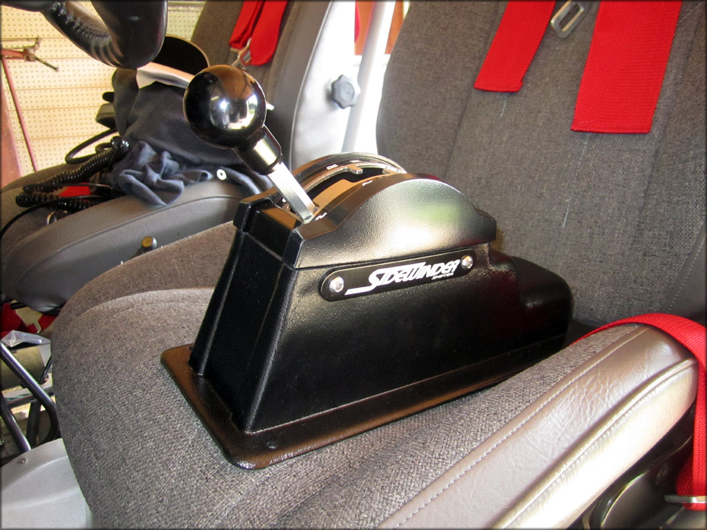

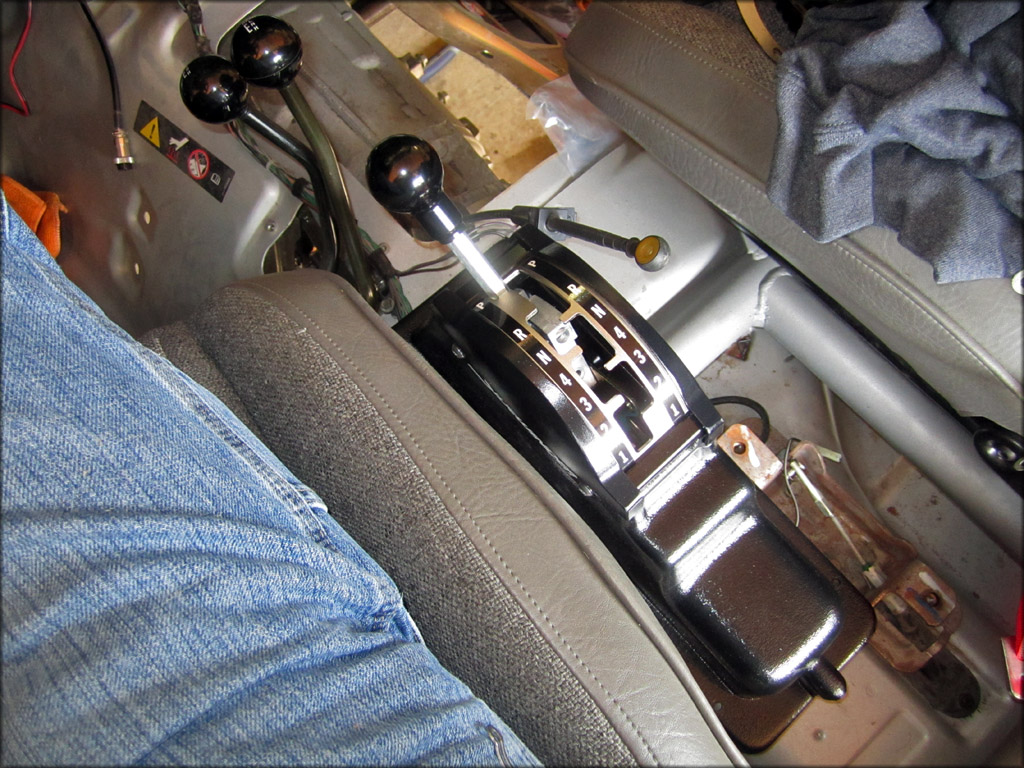

Got my shifter. Big thanks to Rocky at Wide Open Design for the help.
About where I'd like it to go.

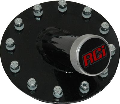

Got my fuel cell hard mounted this evening in hopes of getting my fuel lines run this week. I need to get to the yard store and pick up some plate steel to make a new panel for under the fuel cell for better protection. But this is where it will end up.
RCI Racing has this fuel filler neck and I plan to use it. When I open the tail gate it will be an easy shot for fuel.

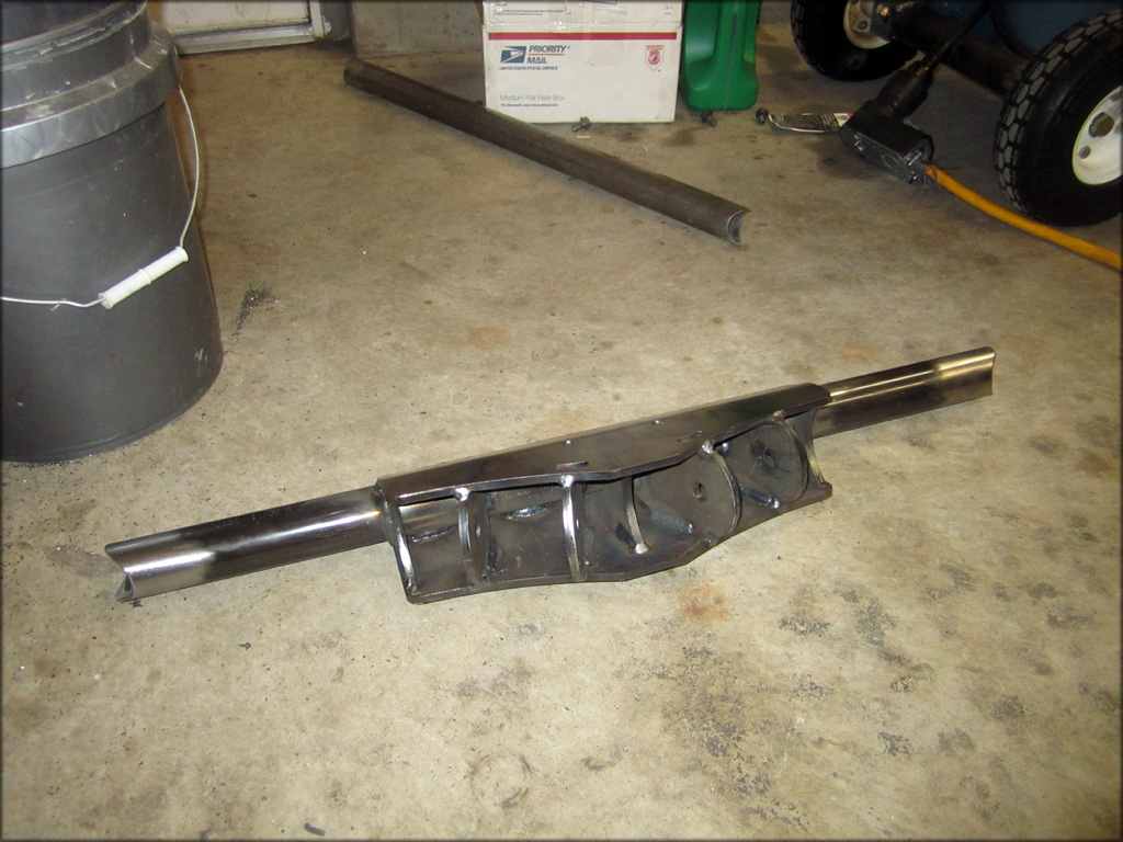

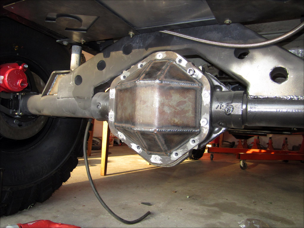

I plan to chop this up tonight and get it installed so I can take it to have the rear gears and locker installed.
TRAIL WORTHY FAB
| 316.337.5311
Old 05-07-2012, 07:21 PM   #1471 (permalink)
WINNAR!
Dookey's Avatar
Join Date: Oct 2003
Member # 23680
Posts: 11,794

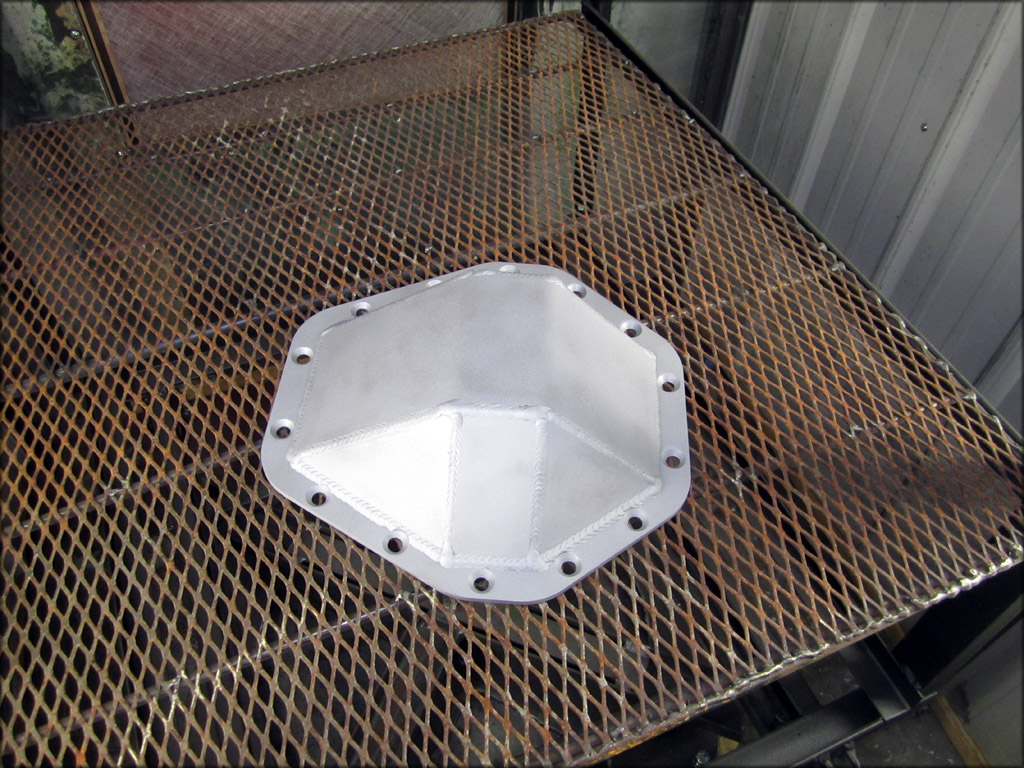

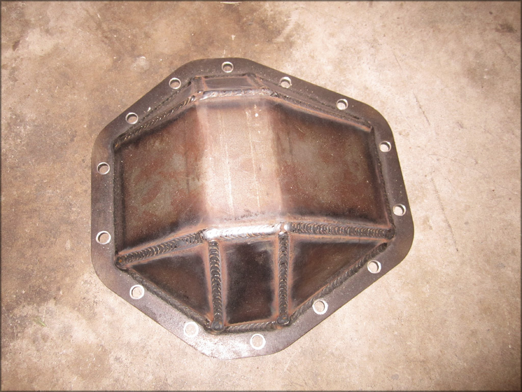

Started out by getting the bolt holes tapered.
Then I got it blasted clean
TRAIL WORTHY FAB
| 316.337.5311
Old 05-07-2012, 08:03 PM   #1472 (permalink)
WINNAR!
Dookey's Avatar
Join Date: Oct 2003
Member # 23680
Posts: 11,794

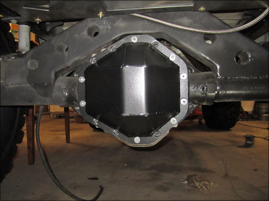

Powdered. Short on bolts. I need to make a hardware run!

Those are some good lookin welded on that cover!
Are you from Dothan by chance?
