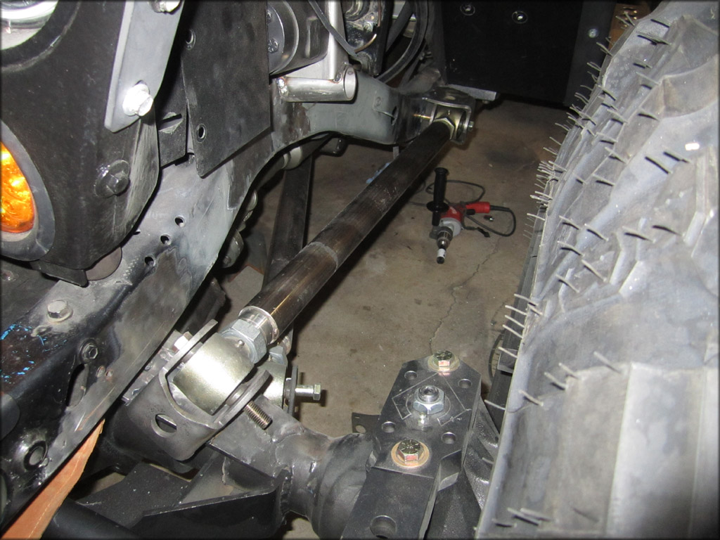

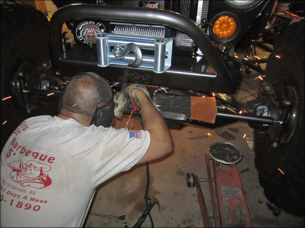

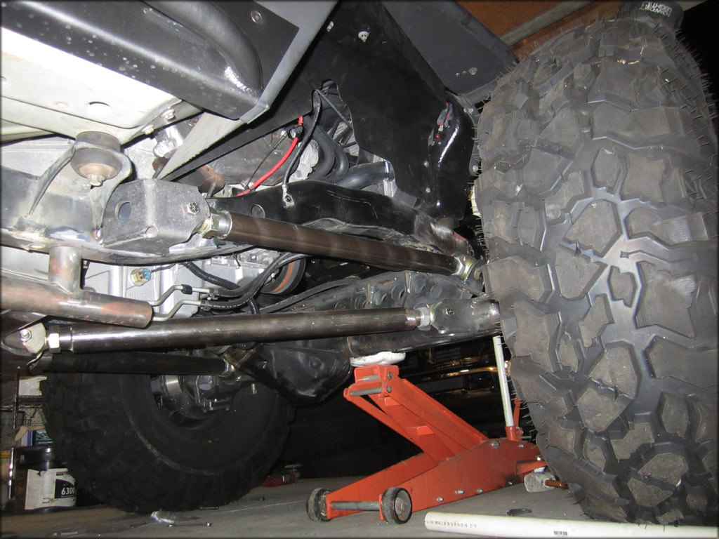

Well... it's a start.
Cutting off the old tacks.
And moving them over.
I'm going to cycle this tomorrow and see how it goes. I am very positive. Just running the body up and down there is very minimal pinion roll. Plus it leaves all kinds of room inside the frame for the drive shaft. Now I can get it exactly where it needs to be instead of making compromises.

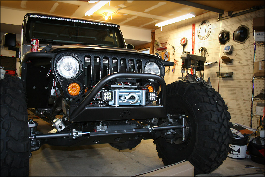

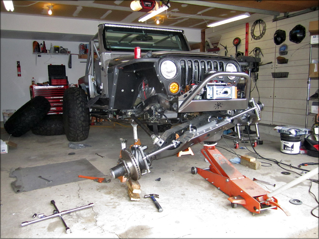

Made a small adjustment to the brackets on the axle and I think it is good to go.
Testing out the flex. The passenger side is 1" below full extension. The driver side is 1/2" above full compression and is 1/4" away from the frame.

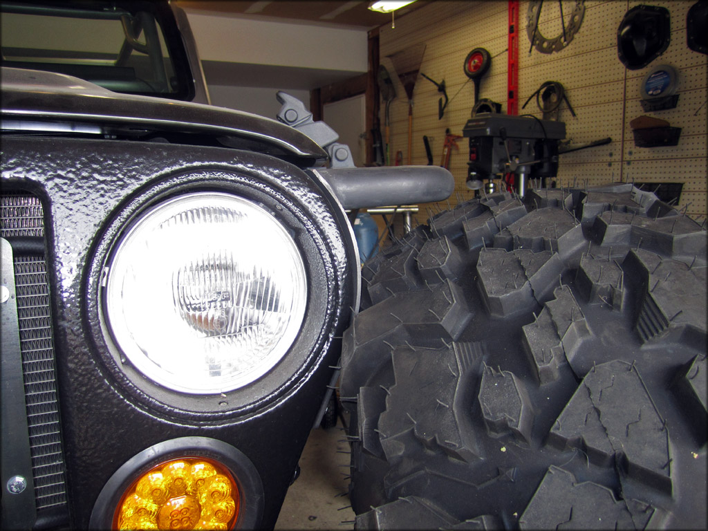

Tossed a tire back on and found out at full lock I hit the grill with the tire. These low COG rigs suck!!

Looks like all you need to do is build new rims or add spacers I was going to ask you about upper control arm clearance and full lock passenger. What I like about spacers is you get better lockout hub protection.
Upper control arm clearance is fine. I will make new back shells and push them out a bit. The extra width won't hurt anything.

Yes. There is 7.5" between middle of joints. It is easy to get more by dropping the lower control arm brackets. But I don't think I'm going to go that way.
No. I may change back to how I was going before. The only thing getting in the way of my upper control arms being on the inside of the frame is the motor mounts. I've been hell bent on not changing things that are already completed but I am trying to be realistic about it.
I was thinking about it this morning and believe I can run my upper control arms on top of the frame and on top of the truss if I move the motor mount brackets. So I might make that happen. I need to think about it some more.

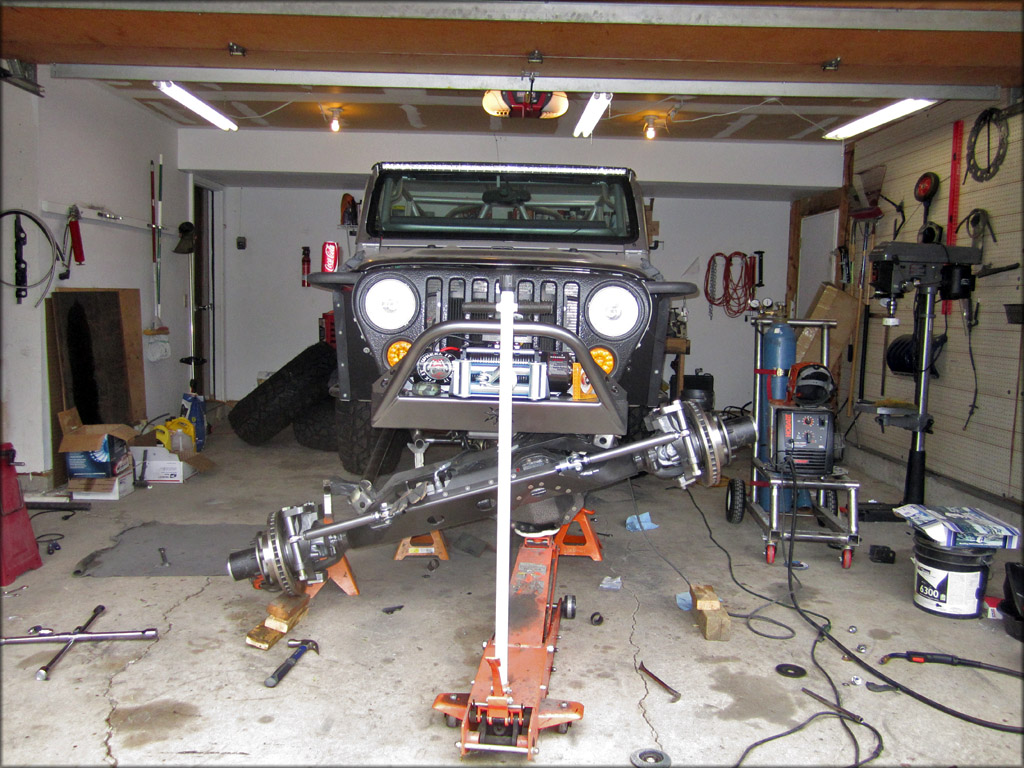

I was thinking about this over the past few days. I even went back and looked at pics of my last jeep to see where the difference was because I didn't have all these problems before. I've given it quite a bit of thought and the difference is time. On my last jeep I had all the time in the world to get things done. Now I don't. I get all psyched up to get something accomplished and when it doesn't go to plan I get frustrated.
It is fun to figure out the puzzle pieces to make it all work. Lately I've been complaining because of the problems but I'm starting to feel like they are a blessing. They are just different obstacles and instead of being in such a rush to finish this thing out I need to be patient and do it right.
I had problems with my last rig and I had to work through them. I'm having new problems that I haven't encountered before and I will work through those problems. Yesterday I was so upset I was ready to strip it all down and sell it off.
Today I'm having different feelings and I am going to take a break from thinking about the jeep so much. I have a wedding anniversary coming up in a few weeks and I'd like to focus on that as it is more important to me than anything else. So I might not post much about the jeep until I can realign my feelings.

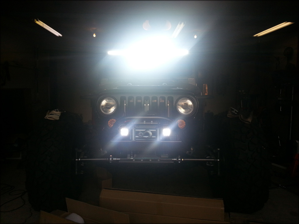

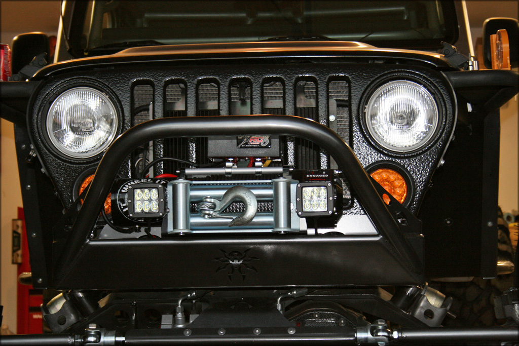

You can never have too much lighting!!
