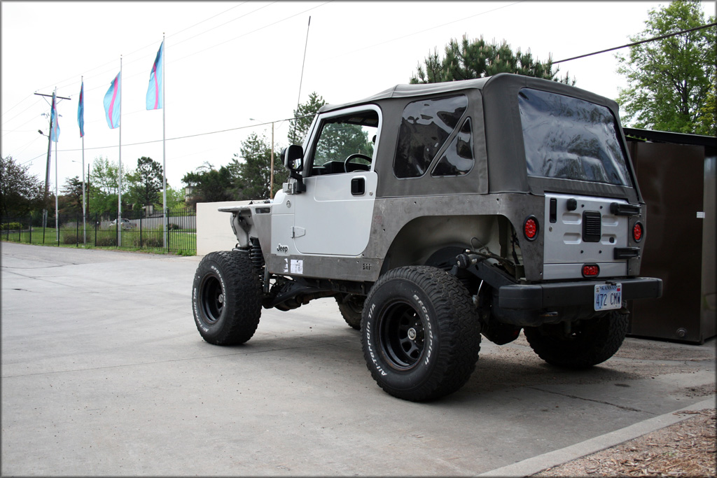

I started a new build. From the beginning. My wife and I flew to LAX on Feb 18th from Wichita to buy a jeep we knew nothing about. Then drove it home 1543 miles and had a blast. The day after we bought it we hit some trails in Sedona, AZ and plan to make a trip back there real soon. It had some really bad on road problems. The track bar bushings were shot. The steering box was about to fall off. And the baja claws were shot. Made for a real fun trip home.
As it sat.
2006 Jeep wrangler rubicon
Rubi 44s F/R. 4.88s. PSC bombshell covers
Nth Degree 6" long arm suspension.
GenRight corner armor and rockers
MetalCloak/Rev111 front fenders
Garmin Jeep trail guide GPS
35" baja claws.
The day after we purchased it.

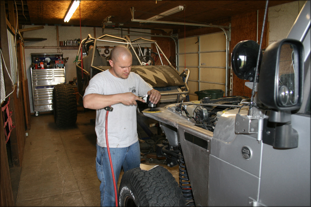

I got home and started selling parts. I sold the hard top, seat covers, tuffy console, and the cupped claws. I purchased a set of 35" KM2s and stuffed them with some ultra wheels. I made the jeep drive straight down the road and perform like it was supposed to and drove it to the Big Meats Run in March/2010.

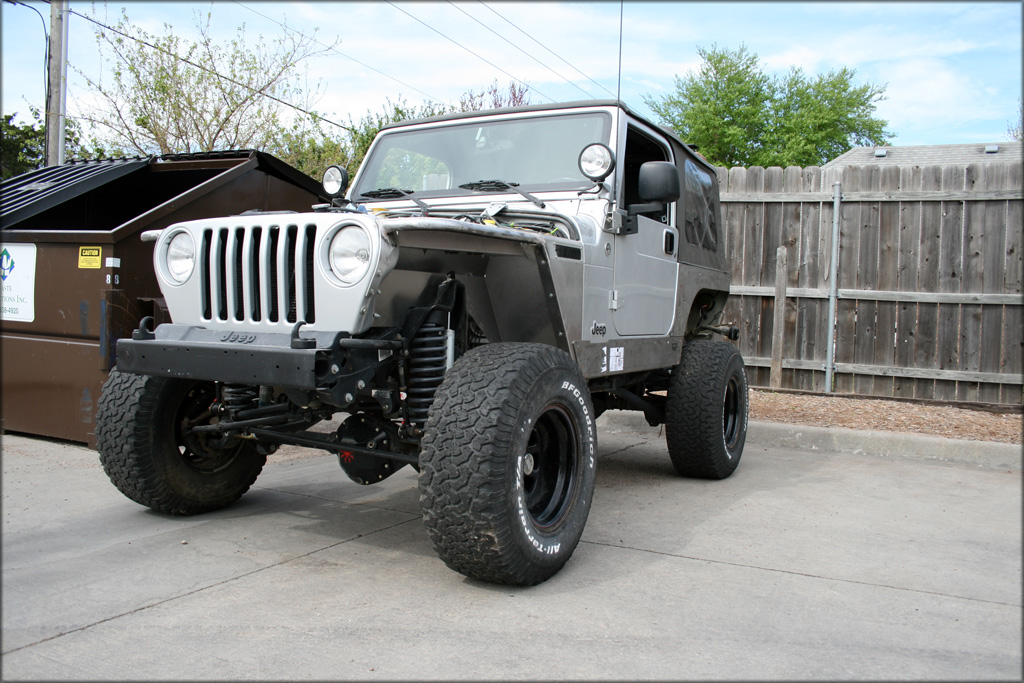

After wheelin around at the BMR I was pissed. I missed the wheelbase and width of my last jeep. So I knew some things had to change. Once I made it home it didn't take long to start selling more parts. I sold the heavy tire carrier off the back, the axles, all the GenRight armor, and the metal cloak fenders. I got it back down to basics on the tub.

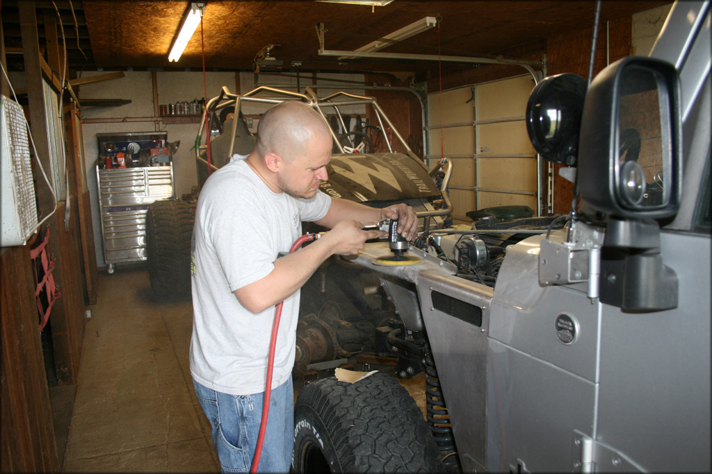

I called and talked to Sean at Rokmen and ordered a set of their hi line fenders and some hood edge molding so I could trim my stock hood. Once the fenders showed up I got them installed.

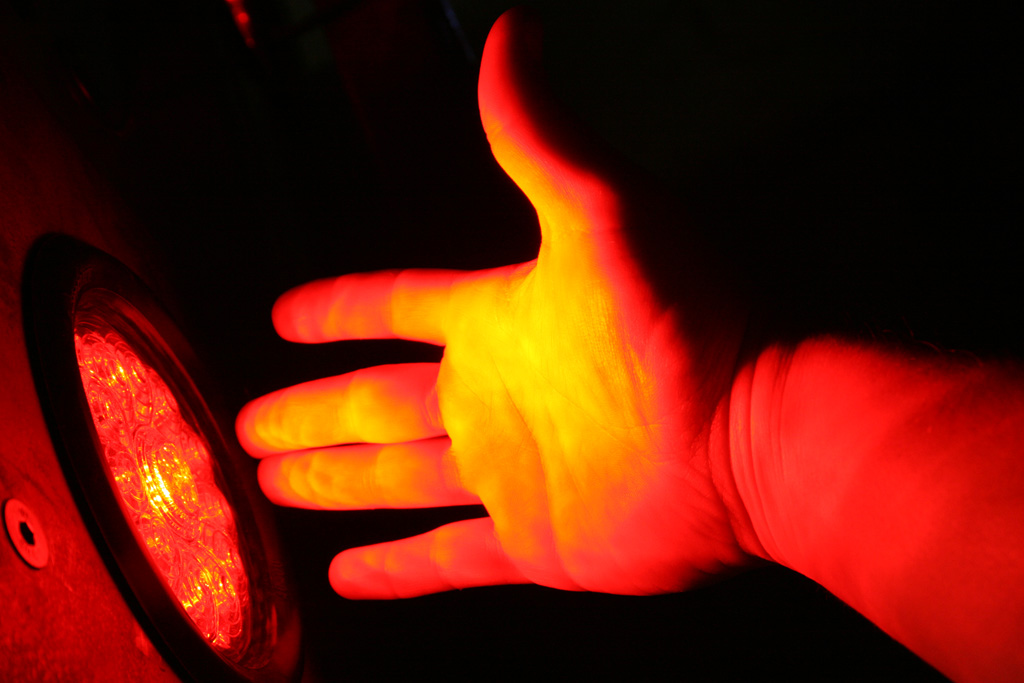

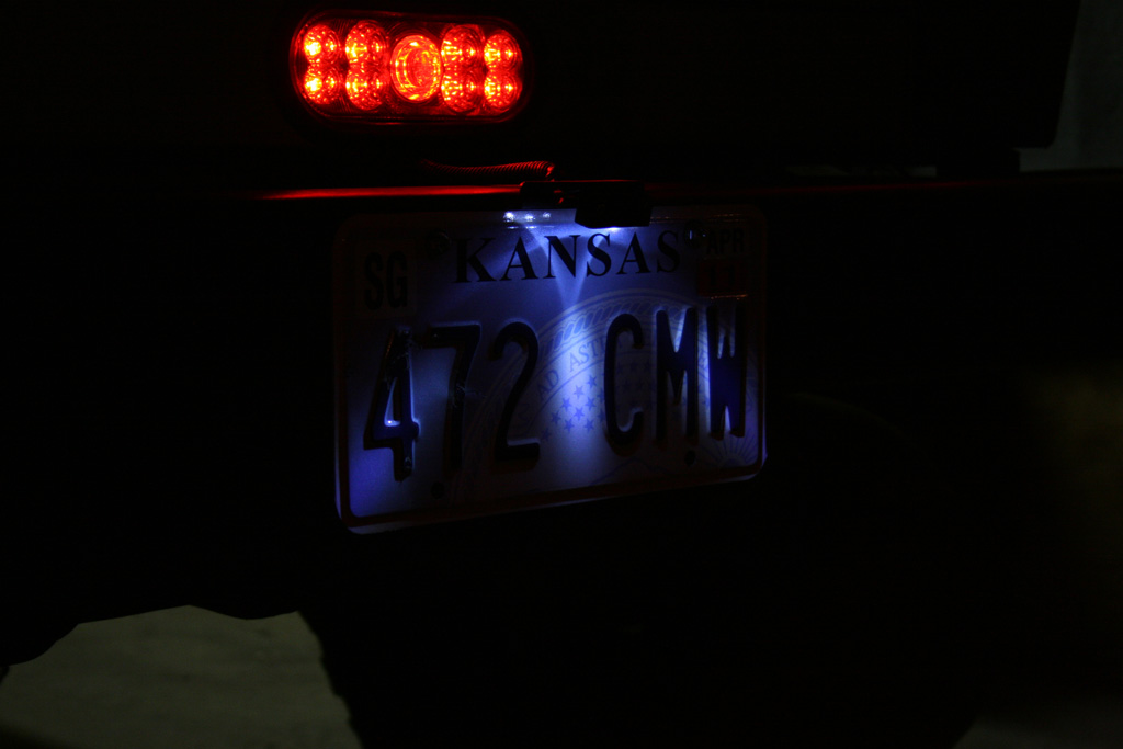

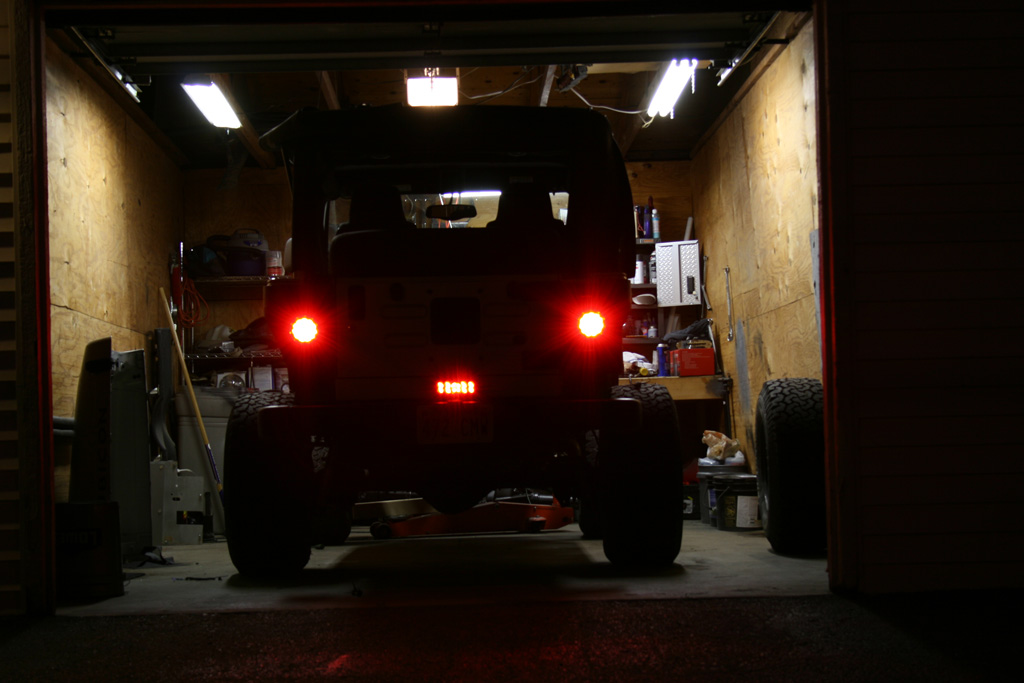

And today I installed all of my brake lights and tag lights. The brake lights are 4" American Superlight LEDs. The 3rd brake light is ASL as well.
The light output on the LEDs are phenomenal.

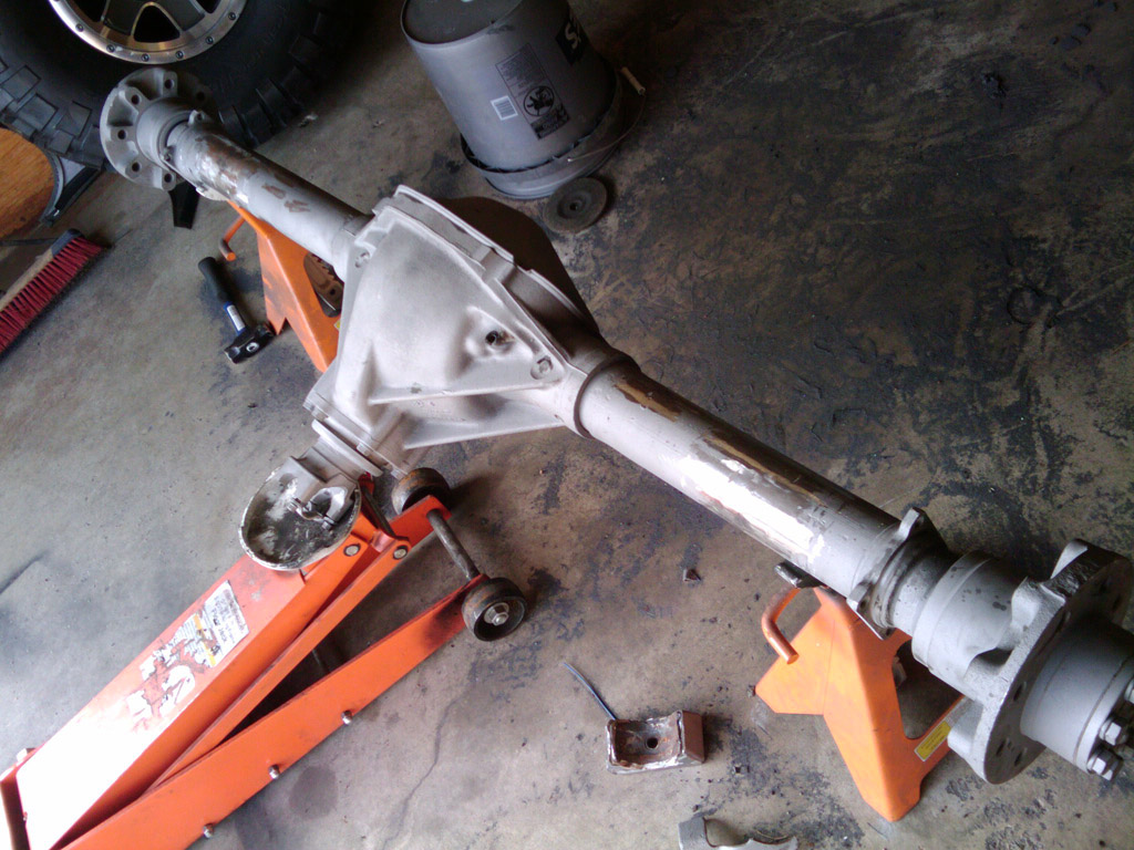

I bought a 14 bolt axle. It was in typical condition.
I had it sand blasted and I primed it.
Then I cut the brackets. I swore after my last jeep I would never do this again.
And painted it up.

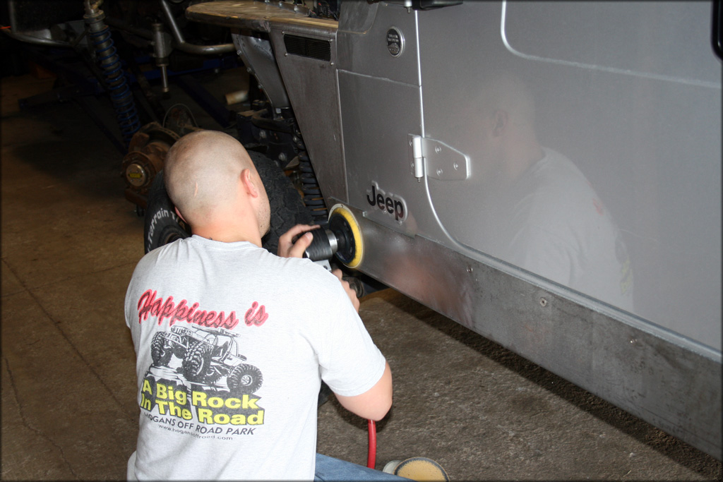

As soon as I get my hood in I'm going to ship this thing off to the body shop and have everything body matched. When I first started looking for a wrangler I wanted silver. Now I finally have it. So I'm going to keep it that way.

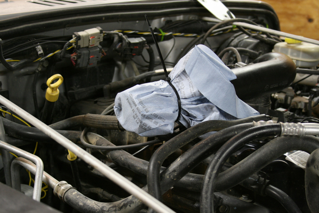

I hacked off my stock air box so I could reuse the tube. I bought a K@N cone filter to fit on the end of the tube. But until it gets here lowes will do.
Moved it out to take some pics. The last time I sat my comp corners right on top of the rocker guards. The vibration ate all the paint away between the two and it eventually started to rust. So I left a small gap between the 2 this time.

What are you going to do with the tank? I moved all the emissions shit in it's entirety into the back and just ran a long ass vent tube through one of the drain holes and zip tied the breather filter down there. You CAN completely do away with the charcoal canister(the big bulky POS) with no ill effects except a more gas-like smell will come out of the vent tube. It won't trigger any CEL or anything.
Carry on there Dookbert.
The chevy 60 heart ache was all on you. It was easy to dump it under Dookey. But there is no reason to go that route with this build when a ferd axle gains the high pinion and proper side drop. The only draw back is the lack of gears. I'm going to run 5.38s and I hope the 4 speed auto will pull it.
I plan to run a fuel cell in the cab behind the rear seat. I want to keep the seat option as I've started to pick up more passengers on occasion. I will yank the seat when it is just the dogs.
I'm going to ditch the charcoal canister and move the smog pump under the frame where the stock tank was. I'm still on the fence about the rear part of the frame. I want to move the frame under the tub for clearance. But I may just notch it instead.

Started smoothing out all my armor in anticipation for paint. The BTF armor takes a beating from UPS so I had to sand out alot of scratches.
I went over the fenders too trying to clean up the mess from my body filler.
Stepping back to check it out. Smoker agrees!
