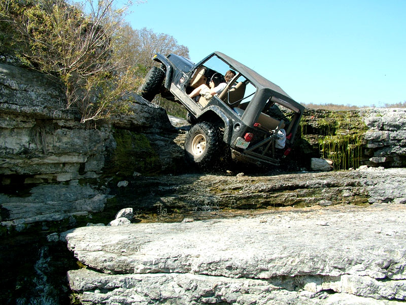

here is the setup you were talking about.
be prepared for tons of this. Also said jeep.
