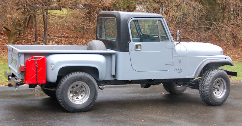

I am working on my new project and I am looking on how to go forward with the bed size.
The frame now fits a shortened M101 trailer perfectly, but lengthening the frame and mounting a full length trailer would be pretty friggin cool, too.
Poorly chopped picture references:
Long Bed:
Short Bed:

What wheelbase are you looking at running? If you plan on wheeliing this thing, I wouldn't leave the overhang at the rear. My .02

Just for comparison's sake, this one has a 113.5" WB. Also the cab is about 2.5" longer than the CJ-10 cab.

I don't really plan on wheeling it hard, I have a CJ buggy for that. It is already to short bed length, at 127 inches of wheelbase. I would have to att 17 inches to the wheelbase to run it long bed... it would be longer than my Excursion!!

Looks like it is going to be a short bed.
The M101 trailers are essentially the same front and rear, so welding the two rears together makes a nice, easy bed. The front of the trailers are pretty rusted, but the rears are in pretty good shape. I am sure they were stored tongue down for many years.
nother crappy chop
I got the 14b in today.

what is your wheelbase going to be? looks really long....
about 124".
Not much shorter than my Excursion...
With the 10b front, I am looking at this thing more of a drive around town/dd/snow and mud wheeler than a hard core wheeler. I have a locked/caged/beadlocked/pirate special to go hardcore wheeling.
The wheelbase should help with the ride. It still seems long for a short bed standard cab pickup, though.
