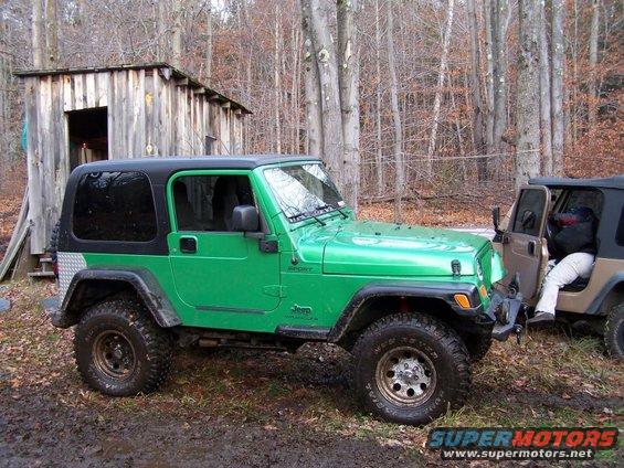

Hello all,
I've been reading like crazy about this swap and can't find answers to a few questions. I'll start with what I have current and what I am planning:
2004 Jeep TJ
4.0 w/ Kenne Bell Supercharger
NV3550
NP 231
Dana 30 Open Front (Current)
Dana 44 Locked Rear (Current)
33x12.5x15 Muds
What I want to swap in:
1979 Ford HP60
1993 Ford Sterling 10.25
H1 Double Beadlocks
Military Goodyear 37's
The ultimate goal is to keep the Jeep as street friendly as possible while on full width axles, keep the stock type suspension front and rear, to keep my back seat, run it with current 4" lift/1.5" body lift, and most importantly have fun in the process. Obviously, I wheel it otherwise I wouldn't be here. I just enjoy driving it around in the summer with the top off. Also, I don't trailer to the trail head so I need it at least to look street legal at a glance. Finally, the back seat is needed for the car seat as its fun to take the family out too sometimes.
Currently, I have 7" flares on all 4 corners. I bought the Jeep with the current wheel and tire combo so I don't know the exact offset, but they stick out far. All the same, the flares cover the tire. Currently, my total width outside of the tire to outside of the tire is about 74". I want to run the H1 Rims recentered to a 5-5.5" backspacing. This should put about 4" of rim outside the WMS. The 69.25" WMS to WMS HP60 with a large offset rim like the H1 rims should allow me to keep close to the 77-79" total width I am looking for without narrowing the axles. 69.25"+4"+4"=77.25" I realize those numbers are without a tire, but at roughly 78-79" total I will still have good tire coverage with my flares. Sound right?
Ok, anyways here are a few questions running through my head that I can't find the answer to...
1) With the Sterling 10.25 rear and a stock wheelbase, will I have to move my gas tank or swap in a fuel cell? Key part here is a stock wheelbase. I just don't know if the tank will clear the larger diff. Just like everyone else doing this stuff, I'm on a budget and would like to maintain my stock tank. More importantly, with the Supercharger I don't want to mess with fuel delivery too much. If a fuel cell is the answer, then I need to be able to maintain the sending unit and pump I already have as to not mess with the tune.
2) When swapping in the HP Front, will it be 100% required to turn the knuckles back? Like I said, I am going to run both axles full width. I would really like to not have to cut the knuckles off to turn them back to get it at 4-8 degrees, but I also want it to track correctly. I will if I have to. I was honestly hoping I could set the axle up level on the knuckle then turn it to 6 degrees. After that I plan to check my pinion angle and as long as it looks good weld the truss and brackets on. I plan to use the TNT HP60 truss kit, http://www.jeepinoutfitters.com/scri...idproduct=1559 as its only a little more than most bracket kits out there and I feel like you get a lot more with it.
I know everything I am not saying is 100% ideal for a hardcore 1 ton trail rig like most are building here. 37's on a stock wheel base, stock type suspension (no 4 link), ect. I just want to get it to this point so I can have something to work off later on as money permits. Also, I understand the Military Goodyear rubber is hard and not many people like wheeling them, but for $75.00 a corner it will get me rolling for now.
Sorry in advance if I missed a build that covered most or some of this. I have been reading all over though and couldn't find exact answers to these questions.

Originally Posted by primate60 View Post
are you referring to a shaved 14b?
I am. Specifically, like the one that was cut and welded in the 14 bolt bible which gained about 2" of clearance. Everywhere I have read said that the Sterling axle has about the same clearance as a 14 bolt shaved about 2" without doing anything to it.
Originally Posted by jpfrk2001 View Post
Pics of said SC please.
Not the greatest pics, but that is me coming up the ledge on that last shot.

Ok, so its been a while since I have posted on here but the build is starting to take shape. Its way different then I had originally planned, so here is an update.
Front:
79 Ford HP60 Front Full Width
5.13 Gears w/ Timken Install Kit
Eaton E-Locker
TNT Truss w/ all mounts
Crossover Steering (Tie Rod on the knuckle/Drag Link Over the Knuckle)
Custom Track bar
Rusty's Radius Type Long Arms (Picked up on eBay super cheap)
Spicer U-Joints
Spicer Lock Outs
Stock Axle Shafts 35 spline inner/30 spline outer
New Seals
Probably my own custom creation of a modified/welded stock diff cover
Maybe a little shave/grinding for ground clearance???
Rear:
Corp 14 Bolt (New Style w/ slide off drums)
Disc Brake Conversion
SRW Hubs
Detroit Locker
3/16" Fabricated Diff Cover designed to shave the bottom bolt of the 14 bolt off
Clayton 4 link 5" Stretch Kit (Lucked into this brand new from a local guy killing his project)
Other Items:
Toyo Open Country MT's 38x14.5x16
Super Short SYE (Already had it, just needed to install and get a CV Shaft)
Genright YJ Corners to cover the TJ filler whole and move it to the rear
Genright Alien 10 Gallon Tank

I am getting ready to order wheels soon and I still want to keep as much backspacing as I can. With 38's, can I run 5.5" of backspacing and not have them hitting the frame/anything else when I turn lock to lock? Yes, the axle is full width so it should be fine and I know guys are running H2's on a 60 front without problems hitting the steering and those wheels have about 5.5" of backspacing. I just wanted to know for sure I can clear everything else with 38's before I order the wheels. Its looking like to get a steel 16x10 with a 5.5" backspacing on a 8x6.5 pattern I will need to custom order them, so I just want to be sure before I do. Everything else I find in that size have a 4" or 4.125" backspacing, so I seem to be limited to custom wheels.
Does anyone else know where I can find 16x10 wheels on a 8x6.5 pattern with even a 4.5" backspacing without having them custom made? I figured it wouldn't be hard, but options become next to nothing when you go from 16x8 to 16x10.
Thanks again for the help. The rear is stripped of all the brackets, hubs, and all internals. I should have some pictures up soon of swapping it in.
