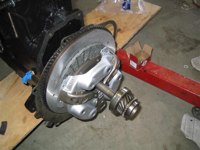

With the drivetrain done, time to get everything put together and installed.
Resurfaced flywheel with new ring gear installed
The new pilot bushing gave me a lot of trouble . I bought two, from two different sources. Before install they were fine, but after install the ID had shrunk just a little too much to fit on the input shaft. I made this little socket-duct tape-emery cloth flap wheel thing and carefully sanded the ID until I was able to get the input shaft to fit.
Found out my old input shaft made for one heck of a nice clutch alignment tool
New clutch from Herm. I miss my old clutch, it was so light! This new one is a little stiffer than what I have in my 1/2 ton pickup, but it's not bad and engages very nicely.

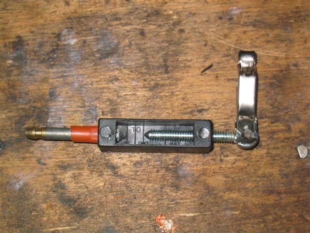

So for the 150th time, I have yet another brake MC interference problem. Yay.
This is why I regret not just bending the pedal arm over. Not much space here.
I first tried a set of 90 degree banjo fittings (from Herm). Well, they didn't fit either. The fitting itself was as wide as the gap, there was no way to get the bolt in.
Next I tried adapting some large diameter tubing (probably 3/8") running from the large diameter hole on the brake MC down, to an adapter and into the normal 3/16" diam tubing.
This didn't fit either.
So finally, by pure dumb luck I found out that you can get oversized fittings for 3/16" brake line!! I guess in some cars (probably most all jeeps) they use the oversized fitting on drum brake applications to keep you from mixing things up. Well, with one of these fittings plumbed onto a 3/16" line everything finally fits!!
Yet another reason I hate my local parts stores. It would have been so nice if they would have mentioned this fitting during the 20 some odd times I was there scrounging for some way to connect the big flare MC to the 3/16" brake line.

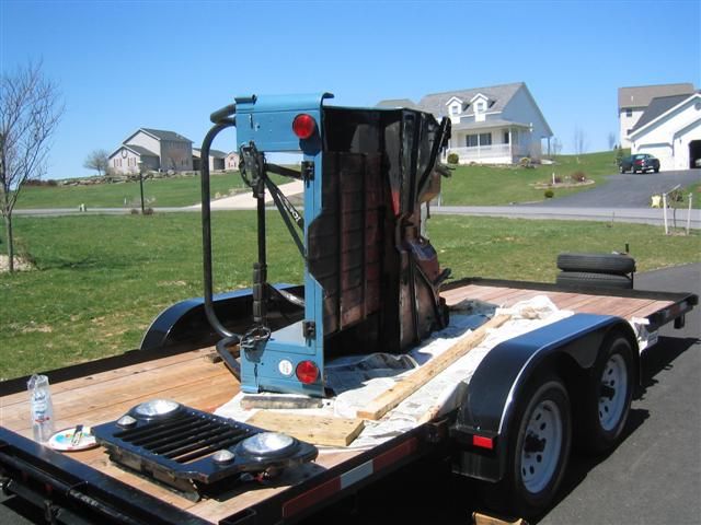

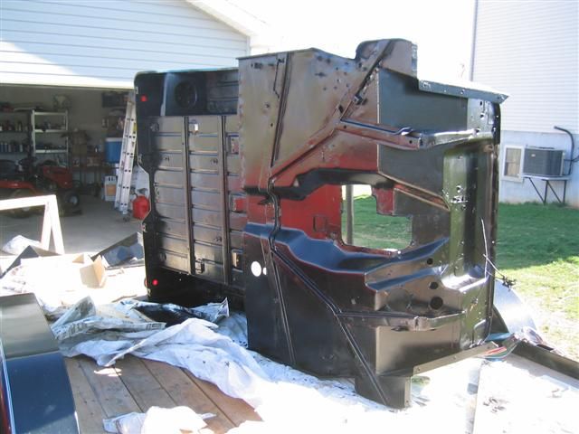

So at this point I had a fully overhauled chassis. It was late April and the nice weather was finally here. I decided the best bet was to basically "clean up" the body and reinstall so I could enjoy it for the summer.
First step was stripping out the remainder of the P.O. wiring job. Actually to his credit the wiring wasn't half bad. It was labeled, it was logical, he used pretty decent wire, it even had a couple of fuses (but only a couple). I probably didn't need to replace it, but decided to anyway just for peace of mind.
This is about 1/2 of it...
Tub. (I love west coast bodies)
'47 Willys CJ-2A -- www.pirate4x4.com/forum/showthread.php?t=690670

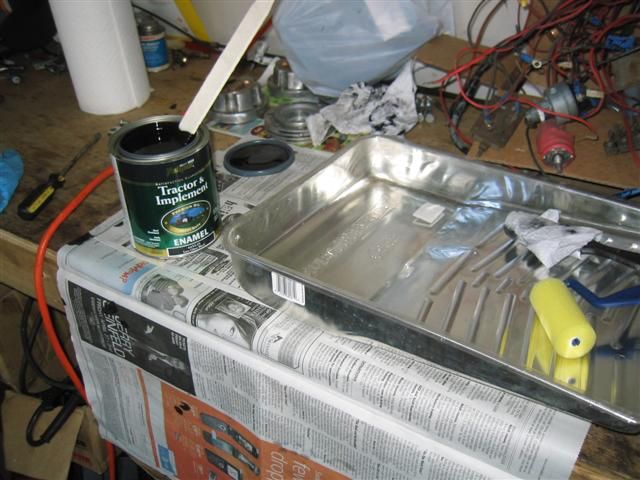

Old 08-23-2008, 10:01 AM   #161 (permalink)
jalbrecht42's Avatar
Join Date: Sep 2005
Member # 52989
Location: Keyport, WA and State College, PA
Posts: 630
I also painted the fenders and other body panel parts to match.
I just used a little cheapy foam roller for most of this and a regular brush for the crevesses and corners. Worked great! (Don't expect a gloss finish though)
jalbrecht42 is offline   Reply With Quote

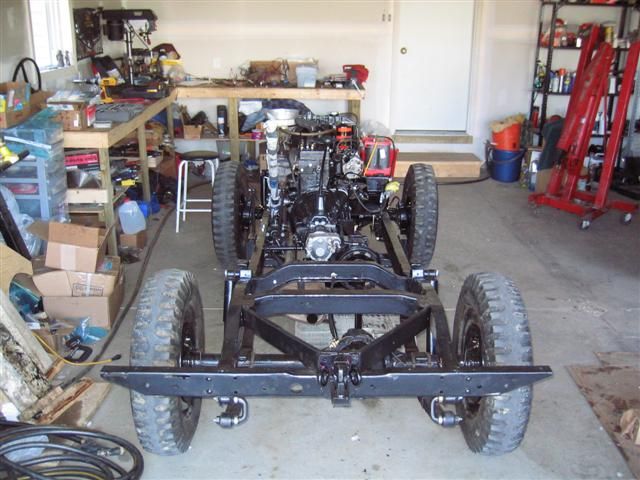

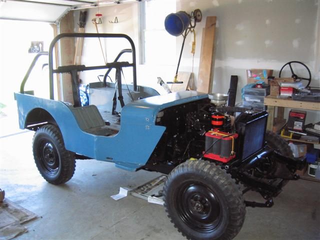

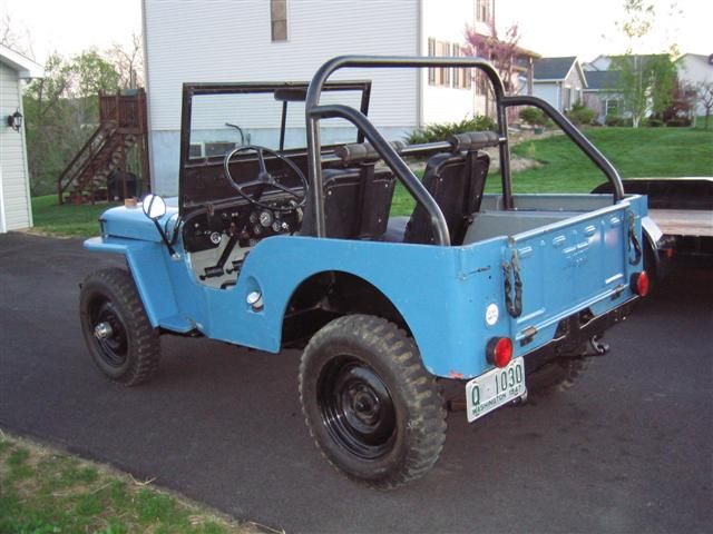

One last look at the chassis before the body goes on...
Once the paint had dried, we set the body on the chassis.
I hate rusty bolts and decided to go with all stainless bolts on the chassis. Not shown, but I got all new rubber isolator pads too. I thought about upgrading from the stock style reinforced rubber belting to a round poly puck, but didn't get around to it.

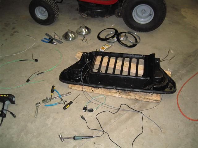

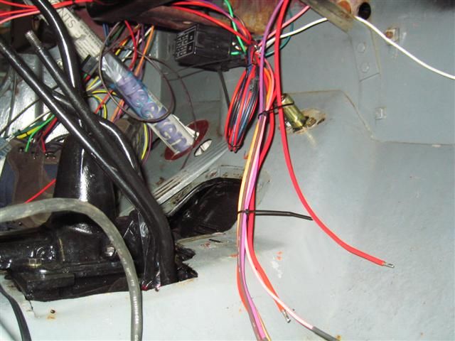

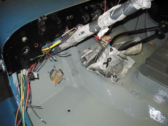

Wire
Next up was wiring the chassis. I decided to go with a kit from e-z wiring
I went with their Mini 12 kit because I wanted a minimum amount of circuits, I wanted something small and I wanted something affordable.
In retrospect, I think the standard 12 circuit kit might have been a better choice, but the mini one is fine. Note, by mini, that means it uses those little bitty fork shaped fuses, like what GM has started using lately.
Overall I thought the kit components were of good quality. I thought the wire was good and have had no problems with any terminations. I love having the labels all along each wire.
I have some gripes, but they are very minor.
-The colors are kind of a rainbow assortment of bleh, I think they may offer an all black kit, and maybe that would be better, maybe not.
-The fuse block does not have a provision for mounting it to the body. It looks like it is supposed to clip into some type of bracket, but this bracket is not included. And there isn't any easy way to bolt it down.
-While all the wires are more than long enough, the ignition wires were a little on the short side, which forced me to locate the fuse block in close proximity to the ignition switch. In retrospect, I would have liked to have located it in my glove box. (Oh yeah, the P.O. added a CJ-5/7 glove box to my dash, it's not stock, but it's really handy!)
-The instructions were annoying. They are somewhat condescending, but not particularly informative. All I wanted was a simple wiring schematic, which it does not have. Instead it's more of a "plug this into that" type of thing.
(As you've probably noticed by now I'm not really the type that just likes to blindly follow instructions. I tend to want to re-engineer the whole damn thing, eventually ending up back where I would have been if I'd just followed the directions in the first place )
Only other complaint is that I think the extras included in the kit--butt splices, heat shrink, etc are just the cheapy walmart variety. Nothing wrong with it, but I'd just assume they leave them out and knock 5 bucks off the price.

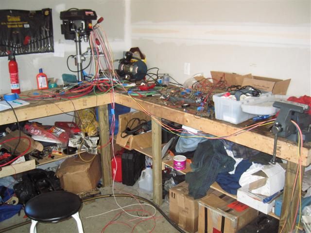

First step (for me) was to lay out the harness so that I could understand how everything was hooked up. This isn't something you have to do, it was something I felt compelled to do because I'm just that way.
I wanted to understand what wires were switched with the ignition, which were not, which ones were fused, which ones were not, how the blinkers and such were wired, etc. Like I said above, a wiring schematic would have been nice.
Once I had that mess figured out and had removed some of the extra wires I didn't need (which turned out to be very few) I then laid it out in the interior and started running wires.

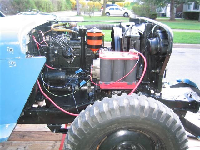

Front lights, tow bar hookup and horn circuits
Engine wiring I love flattys.

With a lot of the wiring done, but no interior in yet, I decided to scuff up the floor and give it a quick/fresh coat of paint. I only did the front portion that would be harder to get to later. Did not do the back (and still haven't).

Home stretch

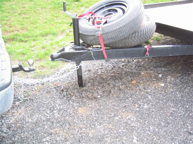

With all the wire terminations done and the jeep at the 95% done point I was really on a role. So much so that the photo/progress ratio started to swing heavy in the favor of progress.
Well, when I was to the point where I thought I had one last long weekend left my buddy decided that enough was enough, him and his wife wanted peace and quiet for a weekend, garage was closed for the weekend. Ackk! I was so close!! (not that I blame them at all)
So what do I do... well, I probably should have just left it there and gone hiking or something, but no, I felt compelled to drag the project back to my apartment to finish.
First thing I learned. When you pull your jeep onto the trailer, make sure the trailer is attached to the truck. 2nd thing I learned. When you drive up on the trailer and the tongue springboards 6' in the air, slides forward and hovers over the top of your new $1000 tonneau cover, DO NOT back off the trailer. Whups. Damn.
But I got lucky
3rd thing I learned: With the trailer tongue resting on top of the bumper don't think you can just drive off without hooking the trailer to the hitch.
Yeah, it was one of those kind of days.

Yard Sale
So once I finally made it home, time to get back to work.
Gas tank in and more wiring..
One note. I chose to make a fresh fuel line with brake tubing. It came out fine, but three things I learned that I would definitely do if I had it to do over again.
1) Put in a drain cock on the drain hole of the gas tank. This way you can hook up a hose and actually drain the tank into a bucket instead of showering everything in a 3' radius of the drain hole.
2) Put a shutoff valve on the bottom of the tank where the fuel line connects
3) Run the fuel line completely inside the frame from start to finish. I ran the last 2' of it around the steering box and I think it is contributing to vapor lock problems.

Once that was done, all I had left was to bolt on the fender, hood, windshield and seats.
Last pics of the open engine bay. It will never be this clean again...
Almost done...

Finally
After just a few more bolts and wires and headlights... it's DONE!!!

belts
I also added a bar and some harnesses. I didn't want harnesses, but I also didn't like the way the hub of the steering wheel sits about a foot from my nose. Having heard stories (bad ones) about a mouth full of steering wheel hub I wanted to do something. I'm not totally happy with this setup, but here's what I did.
Added a crossbar to the stock hoop:
And some small roundbar keepers to keep the belt centered behind you.
As seen on the ^^ pics I added some really thick padding as a neck/headrest of sorts. I don't really like how this is, but I'm not sure what else to do. With the bar lower the belts would seriously compress your back. You want the belts basically even with the top of your shoulders.
For belts I went with these corbeaus. 2" Y style.
They are a lot easier to deal with than a regular harness. I still have to give everybody a tutorial though. On the one hand, with the cute girls I don't mind. On the other hand the girls with big (.)(.) tend to shy away for some reason. I remember just getting these belts in and me and my buddy and his girlfriend go to go for a ride. We offer for her to ride up front, she sees the belts and is like, "uhhhh.... I'm riding in the back". He looks at me like, hmm, maybe these belts were a bad idea after all.
