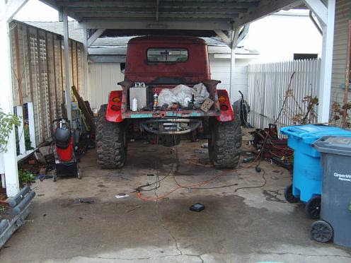

OK i have been building this for awail so here are the pics and what happened and was done over the last couple months from my web page. I dont feel like retyping everthing so bare with me. Here is my rig before the body swap.
Well i picked up a 1948 willys pickup, that will be going on the frame of the bronco II (sorry kyle the cage has to come off too!). Once i get the registration all figured out i will be pulling the body off and repairing all the rust and building up the cage using parts of the cage off the bronco. This truck will be able to drive on the road around town, still will be a far cry from street legal but i figure around town should be fine.
Well i took it down to the dmv and they said that they couldnt verify the truck sense the bed and doors where off. So back to the house to but the damn bed back on and doors!!! This time the paper work went threw with no problem. Now i had to take everything back off. I got almost everything off this time but stopped when the steering shaft didnt want to come out.
Finally got some real work done. Cut out the bottom corner pannel on the passenger side. I replaced with some heavy square tubing that i will use as the base for my roll cage that will be built into the body.
48 willys pickup on 1 tons, 408 stroker on 43, 1986 Ford f 350 cummins, 2001 jeep grand on 32's

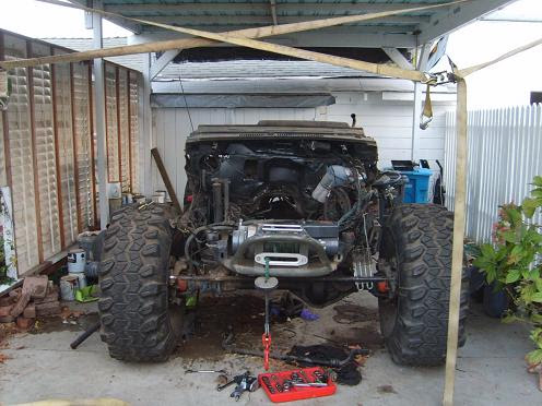

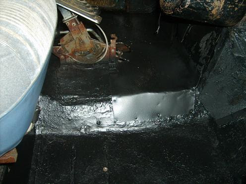

finshed up the other side, Put a bunch of rust converter on the floor both inside and under. I cut out the hood air vent becuase it was too rusted.
Got some more body work done and started tearing down the bronco II

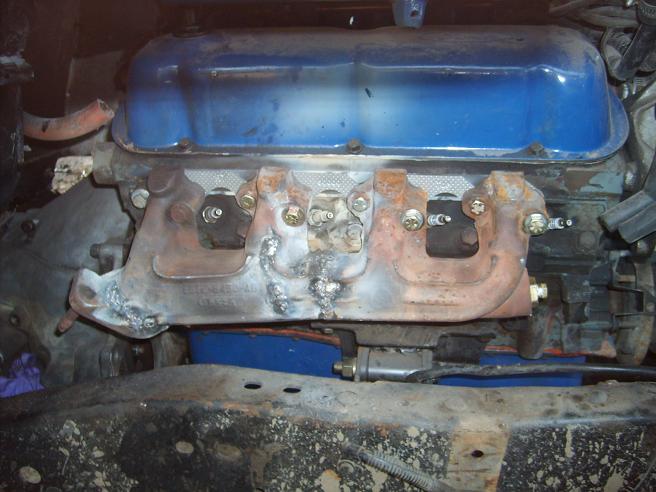

got some work done finally. I had welded up some cracks on the exhuast manifold but like a dumb ass i did it off the motor so it worped it. I had to cut it in half and bolt it up then weld it on the motor. i also had to cut and reangle the exhuast flang on the manifold. I took the front clip off to clean it up and make working on other things easier. I mounted the drivers seat. Put in the brakes other then a few finishing touches on the brakes.

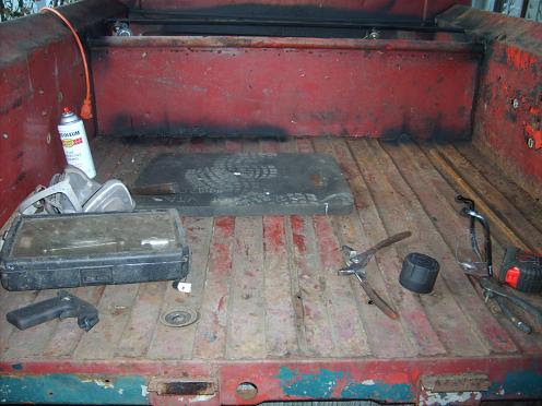

I got the bed on and cut 14 inches out of it. Now i just need to mount it which im not looking forward to doing. I slacked off and worked on my buddy's jeep today instead so we can go wheeling this week in it. But its coming along.

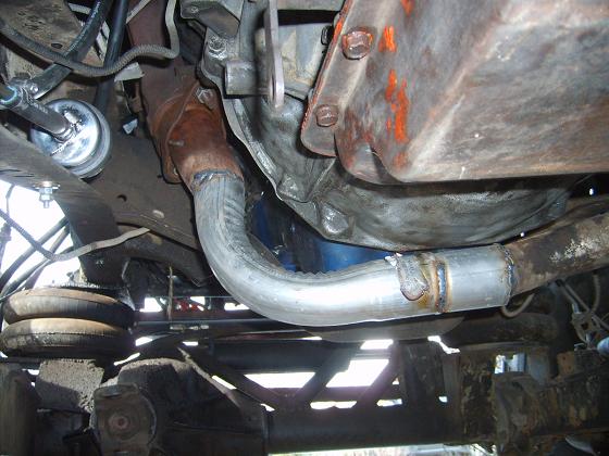

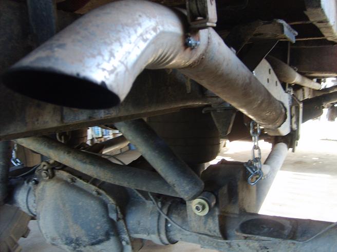

Got the exuast in and it turned out pretty good. I reused a small part of the old setup. Its 2 1/4 from each pipe and when it meets up it goes to 2 1/2 threw a glasspack. I cant wait to hear how it sounds. I also got the fuel system in. It turned out pretty good. I got the fuel pump right next to the tank inbetween the bed devider and tank so that should cut down on noise. Also changed the trans filter and drained the tq conveter.

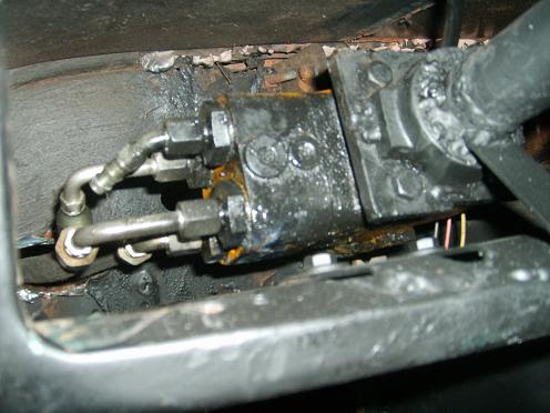

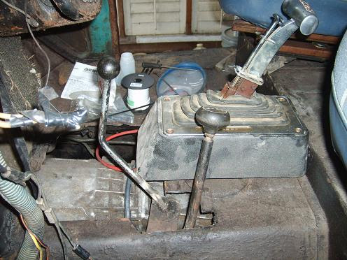

Well i got alot of work done. I got all of the coolant lines ran. I did a much better job this time with no sharp 90 made out of metal that i think is the reason it didnt work last time. I also Managed to cut alot of pipe out and run them down diffrent sides. It runs under the frame on the drivers side. The pic that shows that is with the suspension all the way down. I got started on the headache of wireing it up. Built a mount for the ecm and got the engine bay nice and clean. Im going to have only the bare minimal wires sticking out in the engine bay. I finshed up my exhaust other then one exaust clamp where i want to be able to take it part if need be. I got some nice 2" wheelspacers. Sholud really help with the bed tire clearance and look much better too! I should hear it run sometime next week if i dont mess up the wiring!

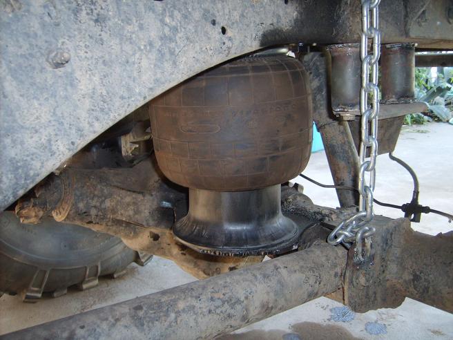

Well i have gotten alot of work done. I took out the coils and put in air bags in the rear. Built the front bumper with tube running under the finders tieing into the body rocker. I made a access pannel to the rear winch. I also had to move the back exhuast to the outside of the frame and build some heat sheild around it. I also mounted the rear shocks in a new spot which work alot better. I put in a underframe camra that runs into my cd player!

converted the rear 2 link to a three link
