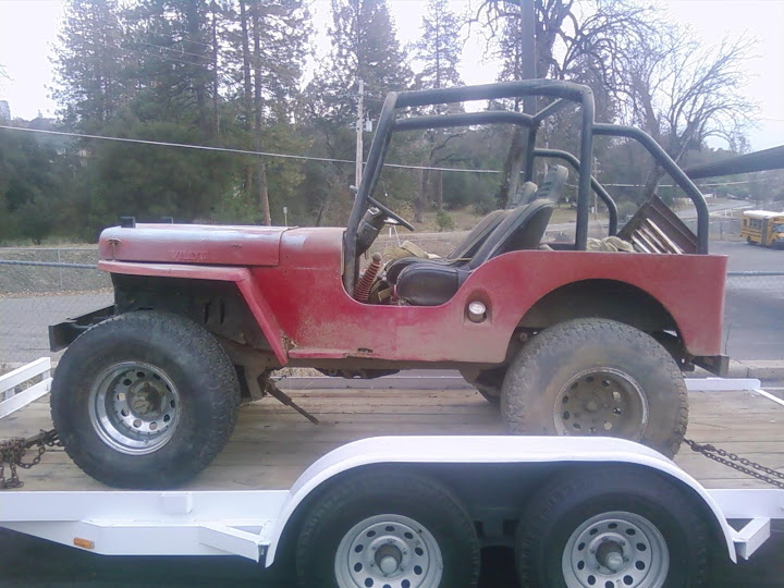

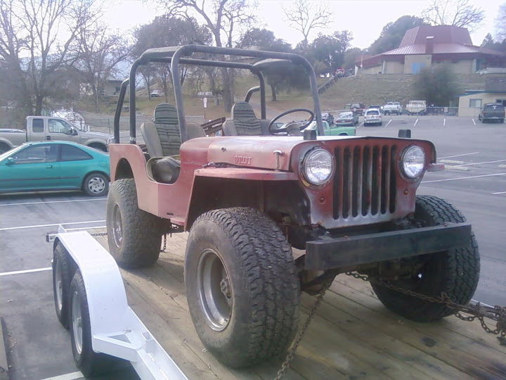

this is what I am starting with.

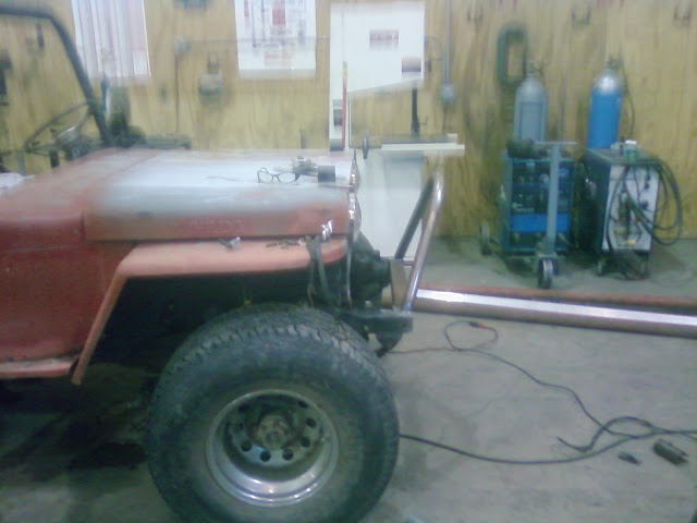

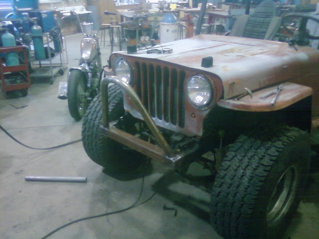

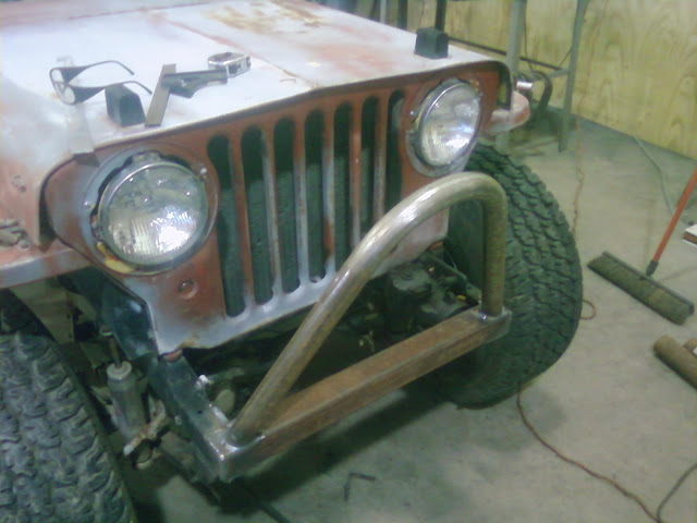

So I got some work done today. I removd the old bumper, a piece of 6" c-channel. Then I took a piece of 2.5" x 3/16 square tubing and slid it in between the frame rails, then welded it into place. Then i got crazy with the tubing bender and made a front stinger. I still need to add guesets to the stingers. Not bad for 2 hrs of work. Tomorrow I will hopefully get it finished.

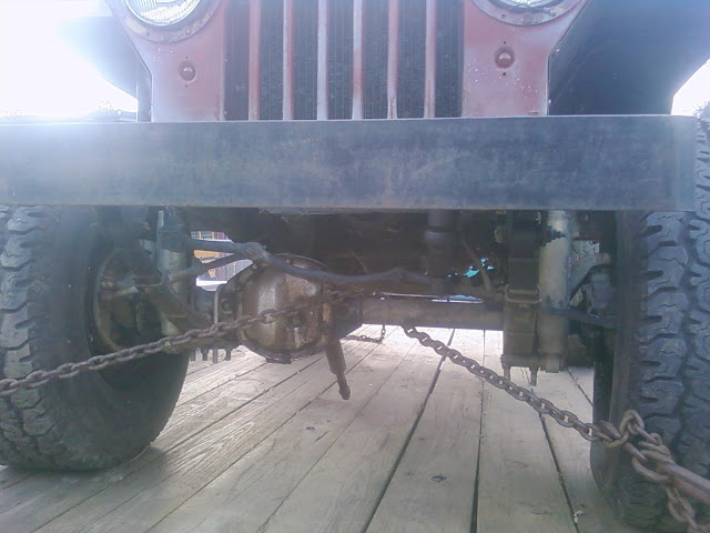

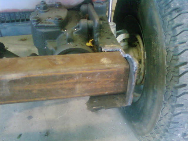

So I'm trying to figure out what I can do about my steering. Right now it has what appears to be a car style steering with multiple joints and a drag link. The PO installed this, it has been cut, shortend, and rewelded in the center and on the passenger side tie rod. What I wold like to do is build a steering set up with a staight tube connection the steering arms and one connecting from the pitman arm to the tie rod.
1.Any suggestions or links on how to do this?
2. I don't have the money to buy a new set up, but possible could look for a used set up from a dooner vehical if there is one.
3.I have access to metal that I could build one but would need to know what type/size of rod ends you all would recommend.
4. If I due a straigh tube connecting the two steering arms I would like to mount it on top of the steering arms to give a little more room between it and the leaf springs. To do this I am assuming I would need to tapper the top of the steering arms. Would I then need to find a tappered sleve for the bottom side. If so is this a special order iteam or can I find one at the local auto parts store.
I have tried to search for this info, but haven't found anything on modifing the steering on a dana 25. All advice and opinions are welcome
Here is a pic of what I got now.

Check out Herm the Overdrive Guy and ECJ5.com
http://www.hermtheoverdriveguy.com/id83.htm
http://www.earlycj5.com/technical/st...ginaw_steerin/

jjeep, thanks for the links. Looks like herm has what i need but it might take me a while to save up the cash for it. Does anyone out there have an old set up that they might be willing to sell me for cheaper? If so pm me and maybe we can make a deal.
Next question:
I did a shackle reverse back in the day without putting much thought into it. All I did was take the shackle off the front and put them on the back. There is about a 7" difference in elevation from front eye to rear eye. I'm thinking this is wrong. Should I try and get the two spring eyes on the same plane or shoud there be some elevation difference?

So I just found a 2 pairs of leaf springs, rear toyota and chevy 52". Just curious if I should swap in these springs and do a SOA in place of my SUA "2 1/2 Rugged Trail" springs (34" eye to eye, by 1 3/4" wide) I will still be running 33" tires. If I do switch over to these springs should I run the Yota springs up front and the 52"s in back or vis versa. Thanks.
kirbybuilt is offline   Reply With Quote Quick reply to this message

Ok, so i am making some progress on my jeep. I just picked up a 1952 jeep truck frame. I got the frame because it has a sm420 with an aa adaptor to the d18. It also has the stock axles. From the research I gathered the 52 truck has a dana 25 front axle and a timken 3/4 ton rear axle. I have been toying with the idea of swaping in the truck axles for the added width. What do you all think about this? Is the ten spline timken a better rear axle than the 19 spline dana 44 with 2 piece axles? Please give me your opinions.

that wiily did not come with a hydrulic clutch, that is aftermarker or home made. the steering is an saginaw box and they did not come in that year either. Most of those conversions are common. My 46 has the steering conversion.
brownbagg is offline   Reply With Quote Quick reply to this message

yeah i know that. From my research the best I can come up with is that the previouse owner put a ford hydrolic cluth and brake mastercyclender on it. As well the hooked it up with a saginaw power steering set up.
