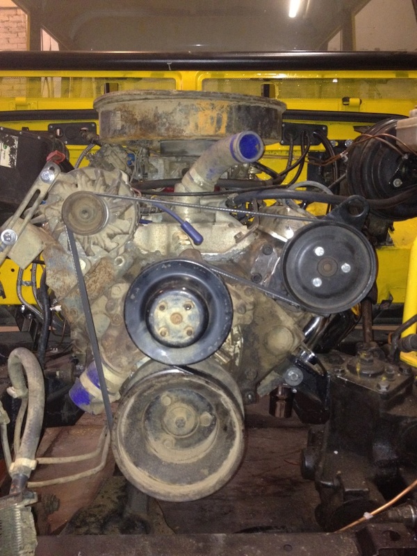

After a long break finally found some time to continue my project!
The engine is in together with the reconditioned transmission. After a lot of measuring I've welded up the engine mounts.
The final result
Some pics of the the engine in place. Still a lot of work to do, building a exhaust, cooling, moving the steeringpump, electrics, fuelling.

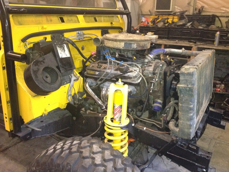

Send a message via MSN to Bowy

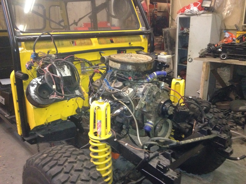

Some more pics!
Block is completely ready to run except to cooling system.
Specs

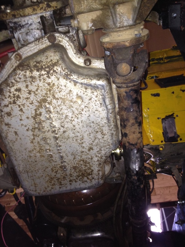

- Custom homemade headers (standard block huggers were fooling the front Salsbury differential)
- P38 PAS pump
- TBI injection

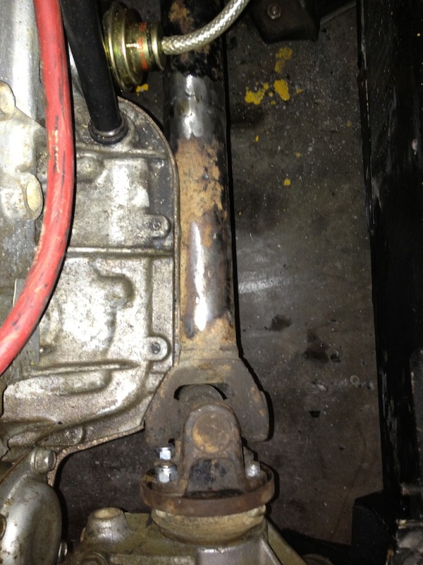

- very tight fit between the front prop and the auto oil sump (ca 6mm play) and custom lenght prop. Will be replaced by a heavy duty gwyn lewis one later on.
Fuel system is finished as is the rear electrical loom.
Very tight fit!

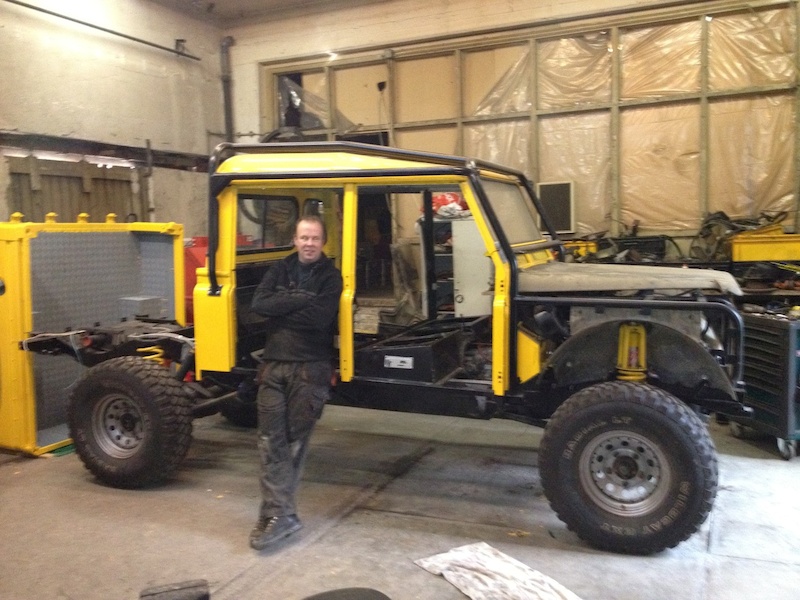

Made a new pic today. The front nose fitted. And the rear tub removed (again)
For reference, the tires are 36 inch and I'm 6,2..... so BIC is really quite BIG for a landrover!

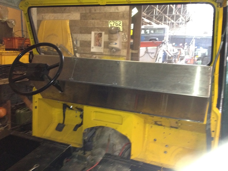

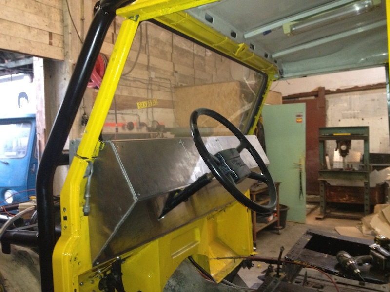

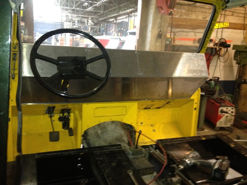

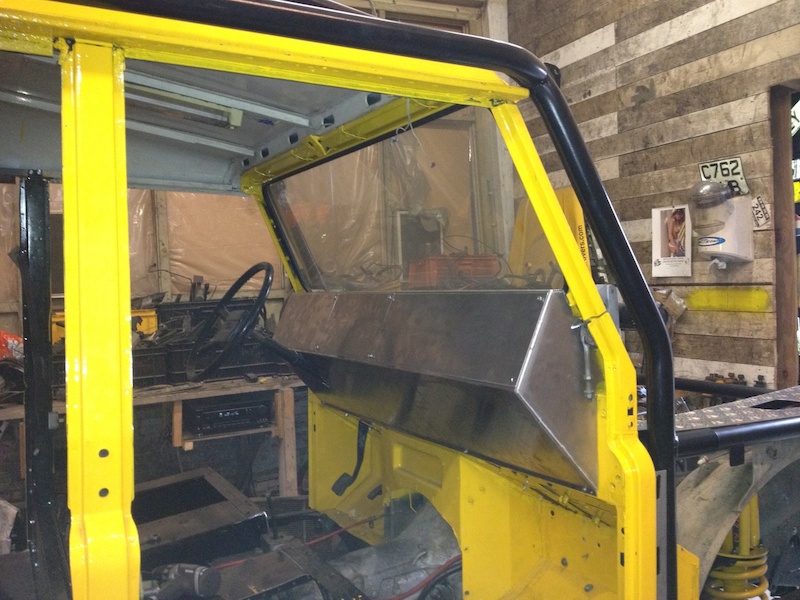

Fitted the custom homemade challenge dash, still a lot of holes to be drilled, but it fits!
Bowy is offline   Reply With Quote Quick reply to this message

I know you've had the panels laser cut, so why not have the holes for all the gauges and switches cut while they were at it? It would all be done then and they will be absolutely perfectly alined.
That's what I'm going to do. I'm already busy CAD drawing my dash panels ..

You're right about the laser cutting, so the front panels are now back at the lasercutter! Will have the first one for the gauges back on monday!

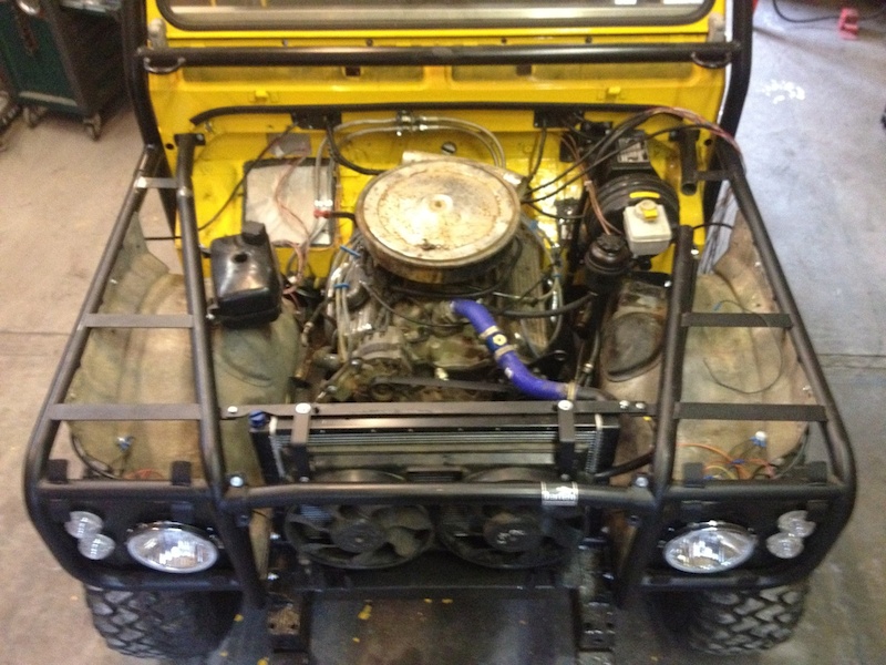

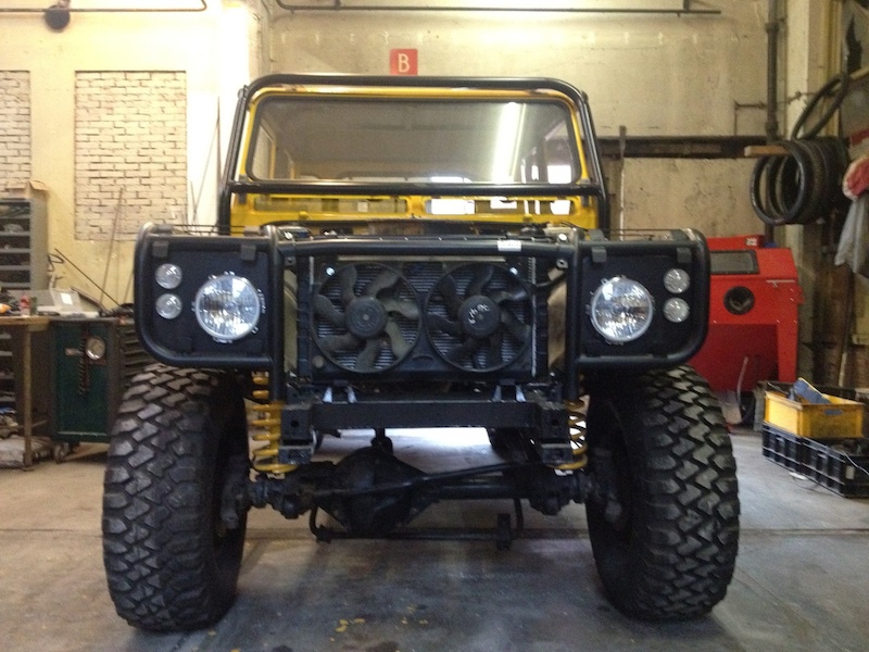

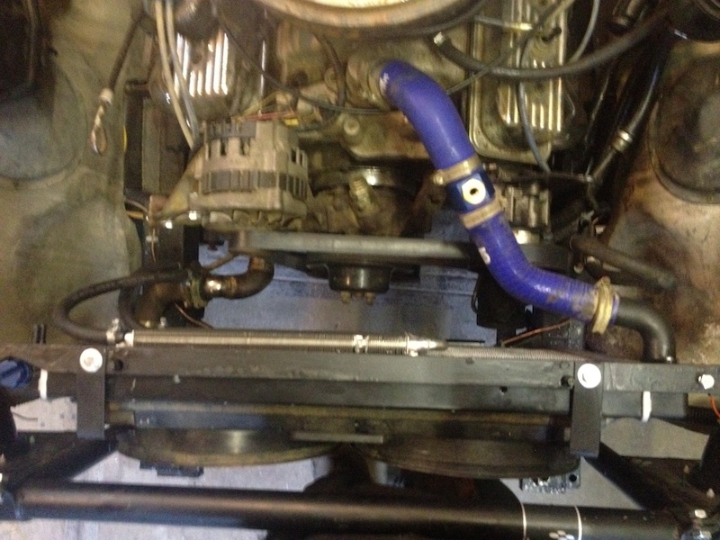

Small update (but a lot of work done!)
Cooling circuit placed and completely plumbed
PAS plumbed and reservoir fitted
Fuel system plumbed and finished
Fitted all the lighting and wired it to the dash area.
Now I have to start wiring the dash! :side
Hopefully next week the first attempt at starting the beast!

Old 02-21-2012, 12:17 PM   #36 (permalink)
Join Date: Jun 2009
Member # 137099
Location: Netherlands
Posts: 426
Nice work!
Those pics are helpfull too! Same rad as I'm going to use by the looks of it. I will have to to my absolute best to fit my huge saab intercooler, that big rad with dual e-fans behind my lights in grille panel .... gonna be a challenge...
Keep up the good work

I really like it.......but you are going to take that engine back out and tidy it up once you have finished mocking it all up, right?
Can't wait to see how it turns out.

Are those pusher fans going to do the job?
Dougal is offline   Reply With Quote Quick reply to this message
Old 02-22-2012, 08:18 AM   #39 (permalink)
Join Date: Jun 2003
Member # 20109
Location: Calgary
Posts: 1,104
Why wouldn't they?

with my RRC I have had problems when I put a bigger Disco-2 front shaft (DC) in. With the vehicle at rest it fittet. But on the road the axle made some movement (bushes allowing for movement, movement of the axle la "bump steer") and then the shaft fouled the r/h catalysator. I had been able to put the cat on diet (making it slimmer).
Having, in your case, just as little space (6mm) between the much more delicate gearbox makes me thing of that again.
landybehr is offline   Reply With Quote Quick reply to this message

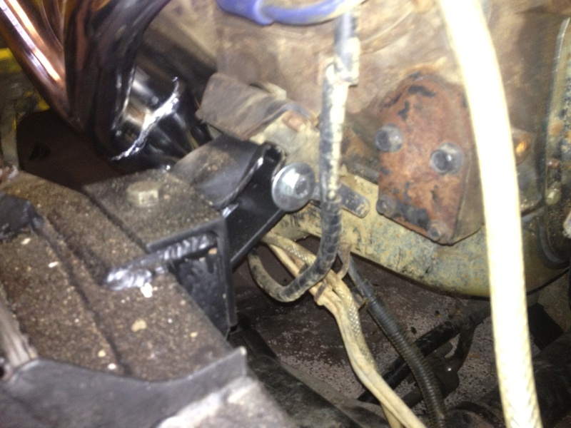

P.S. engine mounts are without cushioning rubber ?
Yep, that's the way they were bolted in , in the donor car. Didn't have any problems there, so I thought I should be fine?

That's OK for race cars. But solid engine mounts will transmit a lot of vibration and noise to the chassis. I have driven a few drag cars with this set-up on the road and it gets old pretty fast. Better to use some kind of rubber mount.
I can't find a clear picture of the Left-Hand side motor mount, but the picture of the Right-Hand side clearly shows a 'rubber' motor mount. It's a much older style than the TBI engine that it is bolted too, but it is two steel shells or halves, usually with an interlocking tab in case the rubber fails, and they are vulcanized together. I have outlined the rubber mount below.

"I see", said the blind man.
Yep, that's the stock rubber mount. I didn't see it the first time. Need to get my eyes tested. As long as the rubber is not torn or sheared it will be fine.

How about a front prop from a cat equipped RRC? They're a solid piece, and about half the diameter of the defender one to clear the right hand cat.
Attachment 654875
Thanx for the clearification! Didn't spot those myself as I'm not very familiar with chevy engines.
The problem is actually not the shaf but more the size of the ujoints. But because this part of the prop is not moving without the transmission moving I think I'll be fine.

I'd suggest that you replace the timebomb of an expansion tank you have.
Looking again I see what you mean, the perspective is lost to some degree as it's looking straight up or down.
However, as you've obviously out a fair bit of time and money into this already, wouldn't it be sensible to spend a few dollars more, drop the sump off the box and get it modified to clear the prop better?
It's amazing how quickly 1/4" of clearence can close up if one of the bearings in the UJ collapses, or the gearbox gets a jolt and bounces on its mounts.
