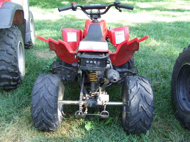

-The rear disc brake and sprocket guard broke at one of the welds where a rod ties the two guards together. This caused an annoying rattle while she drives it. I'll be welding that back up this weekend.

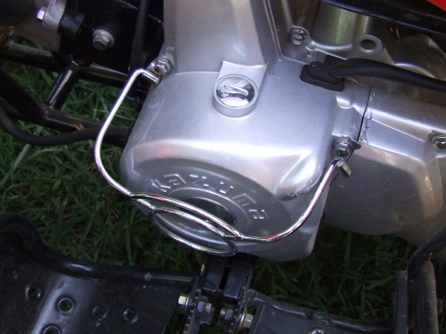

-The ATV came with some cheezy chromed wire heat "guards" to keep your feet an inch or so away from the sides of the case. Both of sides have broken at the thin brackets that hold them on. Again, 5 minutes with the welder and these will be fixed - and probably beefed up with some added bracing.

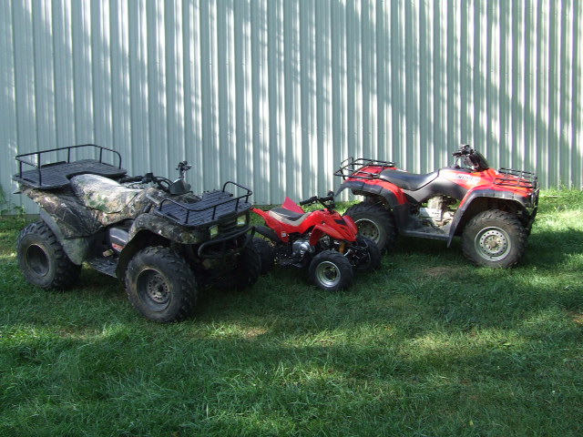

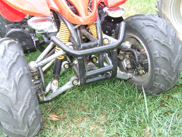

My camera died, but here are a few shots I could get.
First, our family of 4wheelers at the moment:
A few shots of the Kazuma:
You can see if you look close in this one where the weld broke on the guard right behind the rear disc brake rotor:
And in this one you can see on the right hand side where the thin bracket for the wire motor case guard broke loose:

Less than an hour in the shop and I had the broken brackets and guards welded back up and ready to go.

I eventually gave up after re-welding the wire guards and just took them off. Finally put in a good aftermarket sealed battery and it's been awesome. Had to repair the rear axle sprocket guard last year, but other than that it's been a superb ATV for the money invested
