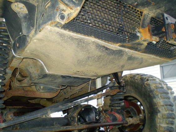

Im using rubber floor mat stuff, with a diamond plate design. FREE from work. No pics yet, but I'll get some. Pop-riveted and/or screwed underneath and in the wheel wells.

Got some pics.

Thanks for the pics.
Fix your steering.
Fix your steering.
I'll get some of the 78 next time I go to the shop.
Yeah, parts are on order for the steering. Just slapped this set together for a mud run. Actually works well, but could be much better.
