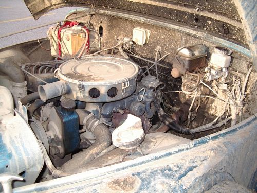

DieselCj 12-08-2004 02:10 PM
Here are some pics
http://www.delawareja.com/gallery/da...7IMGP00681.jpg
http://www.delawareja.com/gallery/da...37IMGP0076.jpg
http://www.delawareja.com/gallery/da...37IMGP0078.jpg
I also just found a link that has a lot of good specs on different engines. After looking at the specs of the 4bt I'm not sure it's big enough. I'm thinking I might go with a 6, I just need to look up the specs to see which 6 has what specs and what they will bolt up to.
http://www.dodgepowerwagon.com/best/diesel.html
basketcasejeep 12-08-2004 03:52 PM
Nice. I'm assuming this is the SD-33? Looks like it was made to fit. What kind of fuel mileage to you get? I believe one of the links I posted has the cummins 6bt in a cj. If you don't see it, pm me I'll try to find it again. The 4bt could be made to have a lot more power than stock, especially if you can find a p-pump version. But if you can find a 6bt, itd cost about the same and could make A LOT more power. IMHO, though, you might want to shoot for putting it in something with a longer WB than a cj7- maybe a scrambler or unlimited? My factory 180hp/420tq rated dodge cummins can be squirelly off-road, mostly due to the weight not being evenly distributed.
How do your diesel cj's perform off-road? Have you noticed any better performance than a gas engine?
mcinfantry 12-08-2004 05:36 PM
i dont believe a 6bt can fit in the hood of a cj. length or height.
im 3780lbs on the front axle and 2500lbs on the rear at 126" wheelbase.
the motor is TALL. and its about 300+lbs heavier.
but i say do it. take pictures, and i want to see it. i was told i couldnt do what i did....
