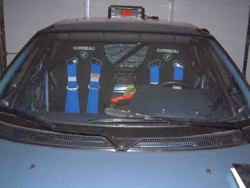

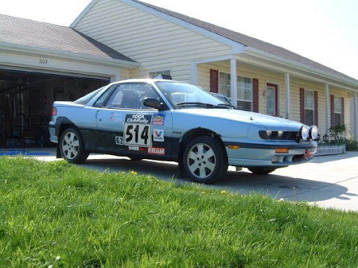

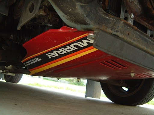

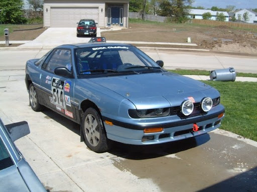

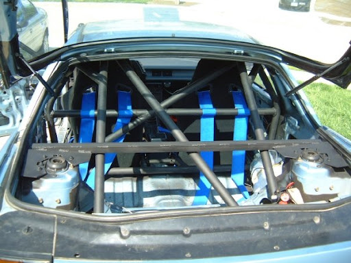

My later couple years of college ('01-'02), we built and raced a SCCA ClubRally car. A '91 Isuzu Impulse XS (FWD, NA 130HP 1.6L), in Group II. All being Engineering students, we sat down and all RTFRB (read the fucking rule book).
$800 Impulse, and they (the 2 guys who had money in it. I was just the builder/fabricator, truck driver, and crew) had less than $3500 in it, said and done. We found a place that would bend tube to spec and truck ship it to you for CHEAP... We just took the measurements, gave them $350, and they bent the main hoop and A-pillar tubes, and provided the rest of the tube for a 12-pt cage (that we then made into a ~16 pt cage). A set of Khumo gravel tires lasted the whole season, and a set of regular street tires on RS wheels. Orange tow hooks front and rear, racing buckets with 4-pt harnesses, replaced the sunfoof with sheet metal and a vent, skid plates made out of an old riding lawn mower hood and shelving from the K-mart that closed, etc. etc. etc...
We pulled into tech at our first rally in MN, and the tech guys walked around the car... and walked around the car again... and looked at each other... then looked at us, and said "somebody read the rule book!"
They actually had me stick around with the car for the next 3 cars, so they could show them how things were to be done. One pair of guys showed up in a FWD DSM with gravel tires, stock seats, and 5-pt harnesses attached to a single roll bar. No tow points, no skid plates, skull bucket motorcycle helmets, nothing in the way of Nomex suits, etc... They got turned away... fast...
RTFRB!!!
Mike
barton174 is offline   Reply With Quote
Old 01-18-2011, 07:07 AM   #11 (permalink)
barton174's Avatar
Join Date: Mar 2010
Member # 156636
Location: Central IN
Posts: 603
Proof:
Oh yeah... Love the ghetto strut tower brace tied into the cage... Yes, that is 2 pieces of angle iron turned into a square.
Oh, and stuff like this tends to happen... 2.5 rolls at 80mph, plus 200' sliding on the roof, down a hill... This is why you need a cage. As ghetto as the car was (keep in mind the shoe string budget of college kids), it met the rules, was reasonably safe, and it just plain worked.... And sadly, was MUCH less ghetto than some of the stuff, there...
