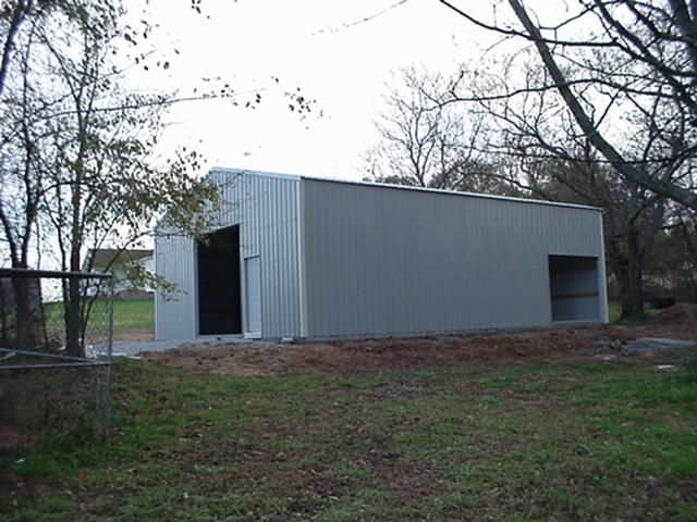

a Pic of mine during construction:
I know, not what you were asking But I could not imagine just one door for my shop - even a double-wide style door. My front door is 10x10, side door is a standard 9x7 garage door. Having dual access is the *only* way to go...
My buddy has a 28x36 shop where access is along the 36' side like this:
*single garage door* *double garage door* *walk-in door*
Works well - his trail truck stays on the end where the single door is, works like a single garage "bay". The double door area is the "work" area - with tools on the wall opposite the double door and sometimes it is nice being able to pull a vehicle in a bit cock-eyed, and have TONS to room to maneuver around, and work around the vehicle, etc, especially if the vehicle (or trailer, etc.) is too long to fit all the way in - and you don;t have to squeeze through a single 9' wide door to get a tire rolled outside, etc.
But IMHO - don't really ever count on using a double width garage door as 2 bays... I just don't think there is enough room. Personally - I consider them "garage & a half" doors, just a single large bay with PLENTY of room to work on either side
