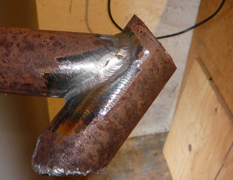

I have a longevity plasma, & review
I also just got there big 200a ac/dc tig
I played with it a few minutes
1st tried aluminum, I have no idea what I'm doing
then yesterday I tried a few beads on steel with fill rod, I can lay a smooth but thin flat bead, but goes all the way through the metal, I think 3/16" so I was too hot, aprox 140a I think.
I'll get to playing around this weekend, it's neat to weld and it be so quite and no messy spatter & sparks
I need to tell ya how much I like my miller auto helmet, think I paid $250-275, worth every dollar
I'll get some info on that as well, had it about a year, got it around same time I bought a RE-manufactured Hobart 187, I like that allot too

well I messed around with steel welding again
it welds just fine, I on the other hand need to get more steady with my hands/eys
buddy says the aluminum I was trying to weld with no filler rod was fine
I'll try some rod too, & I'll get pics soon

Ok ok
see my thread for pics, got only minutes on this so don't too much as I have never tigged before.
I keep moving and banging the tungsten in the work
link
http://www.pirate4x4.com/forum/showt...37#post8967237

I am currently certified with 14 companies for GTAW/SMAW of Carbon Steel, Stainless Steel, and Nickel Alloys (Inconel, Hastalloy, etc) . (Boilermaker )
I have a Longevity 140 AMP stick welder that I have used to TIG with and it welds just fine. No AC. DC only Scratch start etc.
Here are some pics from around the house work.
Tig Root and 2nd pass on an old pipe test coupon 6" Sch 80 .
Duplex 2205 Bead on 1/4" plate .
I also have one of the other machines that is multiprocess. It too tig welds and stick welds nicely.
It is a model CT416D.
Here is a piece of scrap handrail pipe I cut with the plasma and welded with the same machine.
These machines have not been used in a production environment however I have no reason to think they wouldn't hold up. I know of at least one person using the plasma on a CNC table so I am sure his machine is getting some arc time.

very nice work, seeing you got all those certs, when mine don't look too bad with this being my 1st tig on steel, I'm getting there, weld did not break
what do you think?
1/8" 3/32" cerited grey tungsten, small filler 1/16" heat? 100a, might have been a bit high, 1st buttweld ever with a tig
what do you think?
The consistency looks good. The weld face looks slightly concave so adding a bit more filler metal may help. Using a 3/32" filler will allow for more buildup. What is morfe important than what we see in the picture is how much penetration there is below the surface. With 1/16" wire and 100 amps more than likely you got pretty good penetration. (I wrote the previous before all of the pics loaded. The penetration looks good. If the internal surface was also slightly concave, pushing a little wire or opening the gap may halp however in many tubing applications full strength may not be required.)
You could stick with the 1/16" and just and another pass to make sure the weld is at leas flush with the surface. Any metal above the surface ads no strength but is common in most joints to assure the joint is at least flush.
