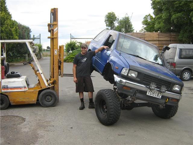

Hey guys

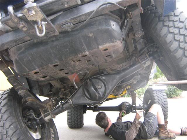

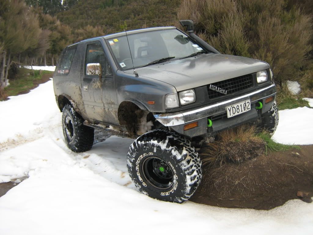

Well after drooling over your rigs i thought i better get some pics of mine up.
these are taken about 3months ago, she is now grey and sits on 35" MTRS
It has Hilux diffs front and rear, 4.8 ratio, hi pinion up front, rear disc brake conversion, ifs hub swap for more width and bigger brakes, custom crossover steering, hilux rear leafs up front, SOA in the rear, gearbox dropped, 20mm, custom crossmember for gear box, Rancho Shocks, custom hoops, custom rear shock mounts, rear trction bar, u bolt flip in the rear, 4JB1 Turbo Diesel engine.
To do: Bar work, lockers and a V8

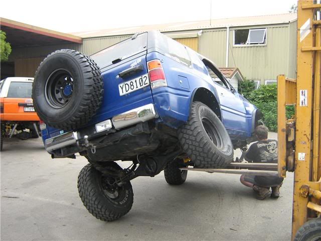

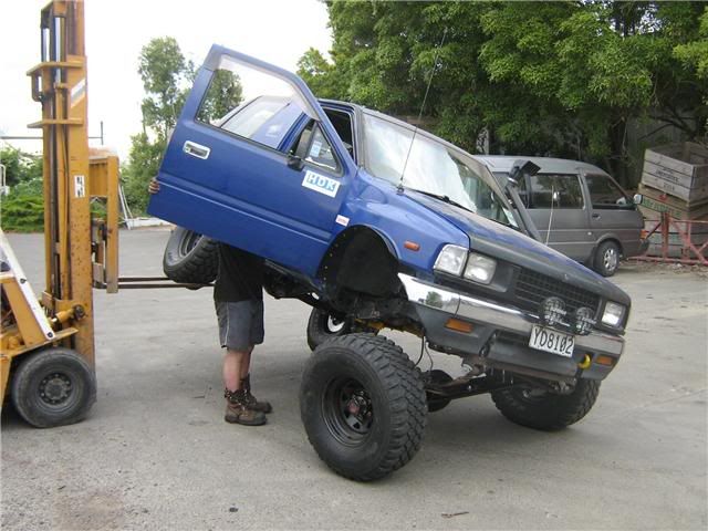

More pics, this is how it was 12months ago
And some from the rear, ill get more pics up soon

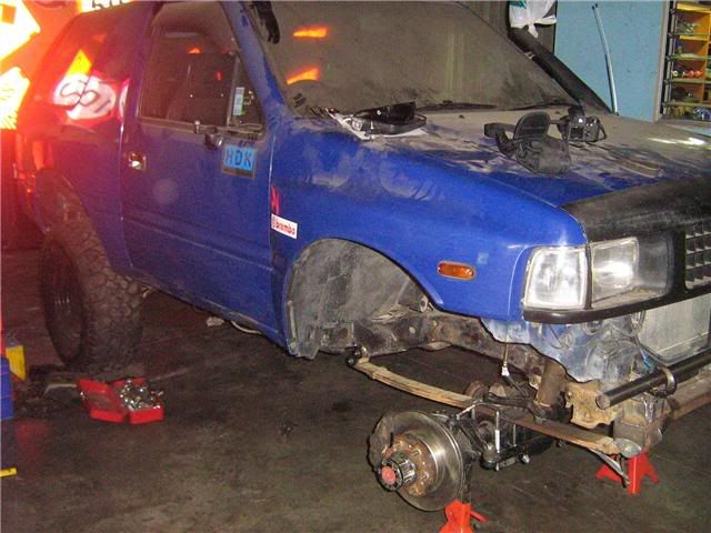

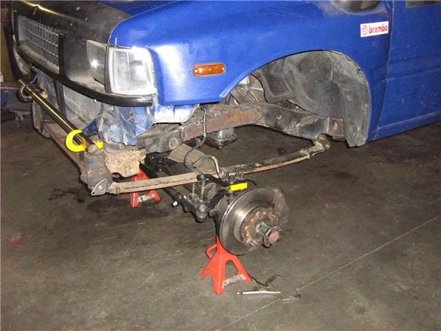

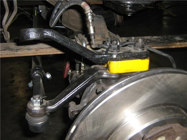

Looks good; but how much up travel do you have in front? With the flat springs and shackle angle, it looks like your static ride height is about full stuff. That's can't be too friendly on the kidneys

i have approx 3inchs up travel, the front springs invert a bit, drive bloody great, it was really soft, after the ranchos went in it helped stiffen it, i also had a bad bumpsteer issue at first, but had a panhard rod fitted to the front which helped heaps,

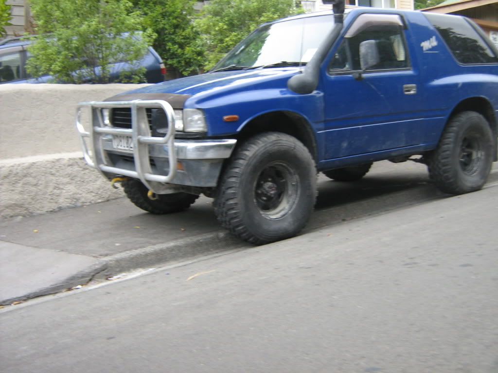

Well truck has had some changes, including a new body after i rolled the old one,
new rock sliders and 35s

So did you scavenge the front leafs from a Toyota Pickup.

Hey yea, i put ifs rears in the front but they inverted with the engines weight, i now have a set of rears out of a Solid axled hilux as they were stiffer and a thicker pack
