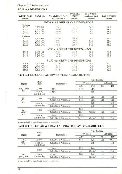

Originally Posted by TroyM View Post
not true. i have seen several supercab shortbox 4x4's up here in canadia land
also have a couple pictures of 76 or older crewcab 4x4 longbox but with a deck on it rusting away in the bush
You might of seen some pieced together trucks but they weren't factory made. The information below is directly from Ford for model year 79 and comes from 2 seperate books, one is a buyers guide and the other is the Ford light trruck facts. If you notice there is only one wheelbase listed for both the Supercab and the Crewcab.
If you have bad eyes like me, click here:
http://www.supermotors.net/registry/media/765211_1
http://www.supermotors.net/registry/media/748212_1
They don't even show a 167" WB for a cab and chassis 4x4 crew.
http://www.supermotors.net/registry/media/748216
http://www.supermotors.net/registry/media/748220_1
Heres a link and picture of a crewcab longbed. Notice the expert craftsmanship of the frame stretch.
http://www.rustfreeclassics.com/Ford...Crew_Green.htm

Originally Posted by younggunmarshall View Post
A lot of time spent building this truck but in my opinion the stacks and wheel flares ruin the truck. What is up with the rear lower section of the bed? Cut out for a future bumper?
Originally Posted by freeclimber00 View Post
What year(s) were these made? I will try to catch a pic of it, if I see it parked and post it up.
IIRC 66 was the first year for the crewcab.
Originally Posted by wahlstrom1 View Post
I've seen quite a few crewcab longbed's around western Canada....like too many to all be custom fabbed. I'll get some frame pics from local one to confirm.
Kind of hard to argue with Ford literature. One of the books I got my information from was from the 1979 Ford light truck facts book that the dealers were given back then. The other one was a buyers guide from Ford that they would hand out to a prospective buyer so he/she could see what options were available on a truck they were ordering.

I know, but there's a lot of stuff you can factory order that doesn't show up in buyers guides/owners manuals. Like 4.56's in RBV's, front/rear limited slips, front suspension air bags etc....
Not saying your wrong, just saying there's lots around here.....pics will confirm.
If its a 2wd crew then yeah. But all the 4wd from factroy were shortbeds. If you have alot of them up there then im sure its some sort of MH or Quigly type conversion.
