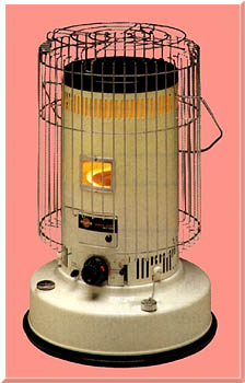

I have 2 heaters, one Propane, and one Kerosene.
I see them for sale all the time used for cheep around here.
I get the Garage warmed up with one simular to this one: (Propane)
Then I use the Kerosene one to maintain the heat. The reason I use both is the Propane one is very noisy, while the kerosene one is silent. Kerosene puts out a lot of btu's per gallon of fuel, twice the amount of Propane.
Here is the Kerosene one, it's a Toyostove OMNI 105
