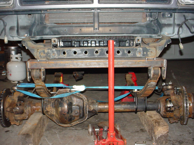

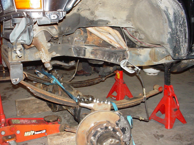

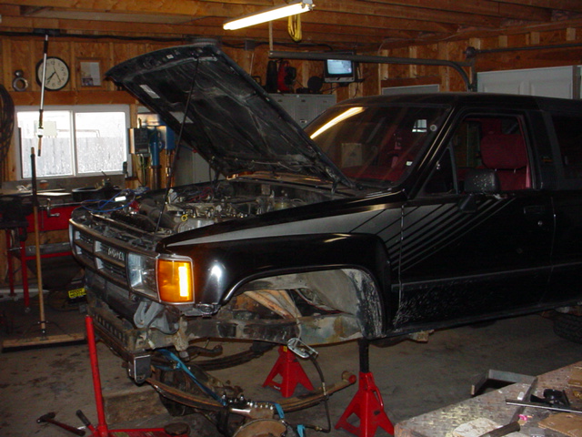

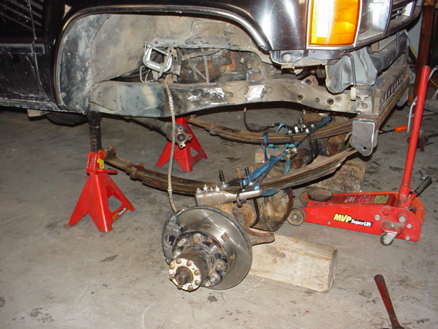

We got started Saturday morning, and this is a far as we got this weekend on the front end until we got to a point where we had to stop for lack of parts.
Like I said - gotta round up some more parts before we can do the shackle hangers (through the frame), some bushings, steering linkage, etc.

No plan changes this time (too late for that, and my buddy wants his shop back so it can't sit here long )
Front springs were built intending on the weight of a 350 for an engine, so they are probably a bit too stiff for the 4 cyl. We'll just have to see once it is up and running. They are a hybrid rear pack that moves the axle 2" forward of stock, and I moved the fornt hanger hole about 1" forward as well. Early measuring (see the blue strap) looks like the steering box is gonna have to go forward 1-2" to make room for everything.
I traded my 42's this weekend for some 38.5x16 TSL's - I just did not want to deal with trying to turn the 42's with 4.88's and a 4 cylinder, or trying to cut that much metal to get them to fit.
I have a sky dual case crossmember waiting to go on it when the time comes to do the dual cases.
More pics this week as the parts come in that are needed

O and on the steering box, when I did my sas I move the axle 3" forward as well. I moved the box 1.25 forward which is tight to the rad support. Ive only got 1/2" clerance between the drag and tie rod so you might want to cut the rad support and go a little more.

One thing I noticed is his BLING steering arms are pretty short,or look to be anyway. Might help a little there
