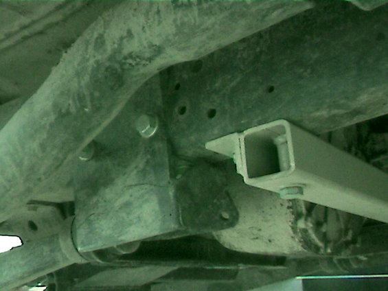

Im looking into getting some extended radius arms for my 79 Bronc from broncograveyard...$750.
Whatever I do I need to get rid of these damn drop brackets...
They catch everything, thinkng about making my own too.

Ok I don't really see why you guys couldn't do what I did. I spent $80 in Johnny joints, $30 for 7 degree C- bushings,and fabbed up my own mounts (4 plates with one hole each) Ok fine the arms aren't extended....$110 vs. $750?????
I was pretty proud of myself when I put on a large sized condom and it fit, untill I saw the label...."Made in Japan"

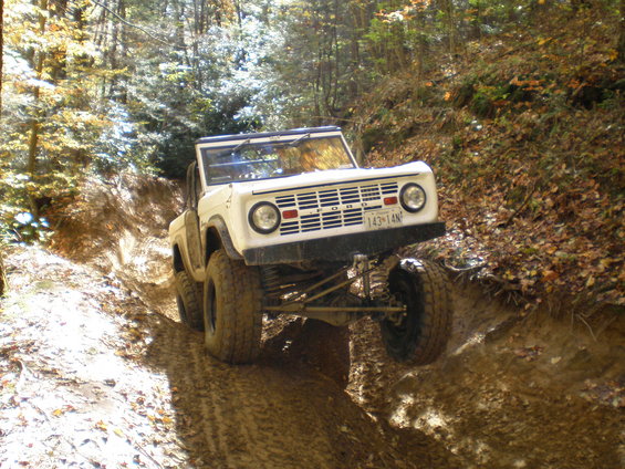

First off not the best flex shot but it is raining and this is what I had on my disc.
Front I have extended- johney jointed arms and a WAH. WH 5.5" front springs and plenty of shock travel.
Rear I have 3.5" 11 leaf nationals and a 7" long spring perch that is also built to give me 2" of lift to match the front and they piviot. The rear shocks are not long enough and this is the down fall of my rear set up.
As far as spring settle I have never checked from when I put them in. It all works real well but their are some changes I am going to make.

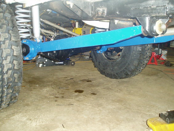

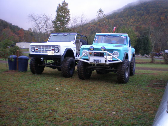

I built the suspension for both of the rigs in the picture..both have the same 14" extended arms shown in the next pic. The white EB has 5.5" Cage coils and the blue one has 5.5" BC coils. Both flex very well and work well on the trail but both still spend time on the street too. No WAH or wristed arms..just KISS extended arms..but the blue one took second place in the modified class on the ramp competition at Paragon last spring (but I do not remember the score..).
69 Bronco trail rig
72 Bronco TT racer
78 Bronco trail rig

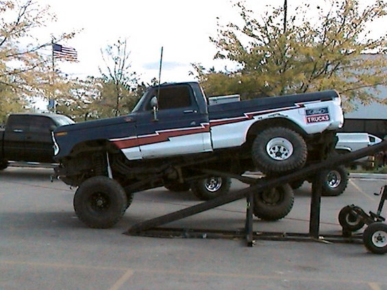

I was all in favor of anything but extended arms until a buddy built this thing. Sick flex and stupid easy design (cage arms).

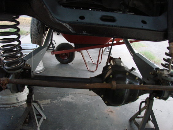

I bought the Cage arms. It is a lot cheaper to build your own, but the thing most people forget is that when you lengthen your stock ams, you need to put a bend in them where the stock arm would have ended to keep your tire clearance. The Cage arms have that built in. You can see the bend as the boxed portion changes to the round tube. And yes these things are beefy.

I have to ask...what's the wheelbarrow for?
mad_boi is offline   Reply With Quote
Old 12-27-2006, 08:53 AM   #46
jonnybronco
Join Date: Aug 2006
Member # 77280
Location: Yuma Arizona
Posts: 20
It's holding up the truck. Just kidding, it was just there to get it out of the way.
