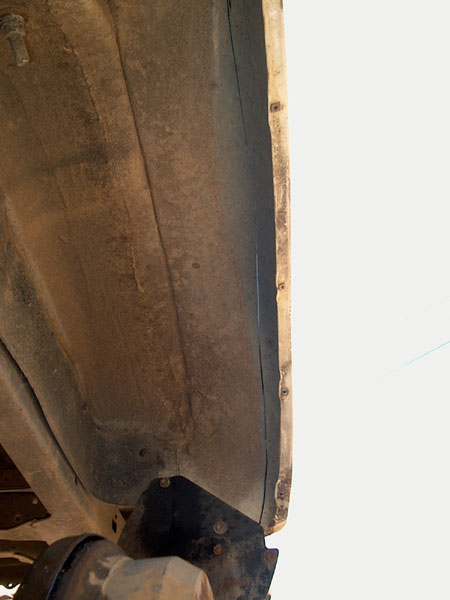

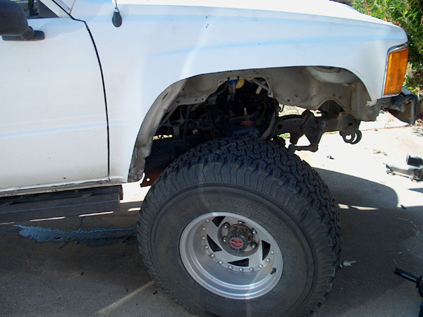

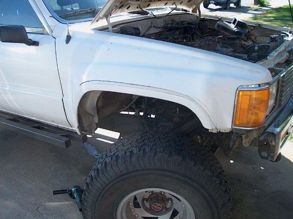

This post includes pictures of trimming both the front and rear fenders on my 1st gen 4runner for added tire clearance, including making new wheeltubs for the rear. This is my first time doing this, so bear with me!
The offending sheet metal:
I used an adjustable square with a pencil strapped to it for making the fenders out. This is about 2" for the front fenders.
Am I really doing this?
Looks like I used a can opener.

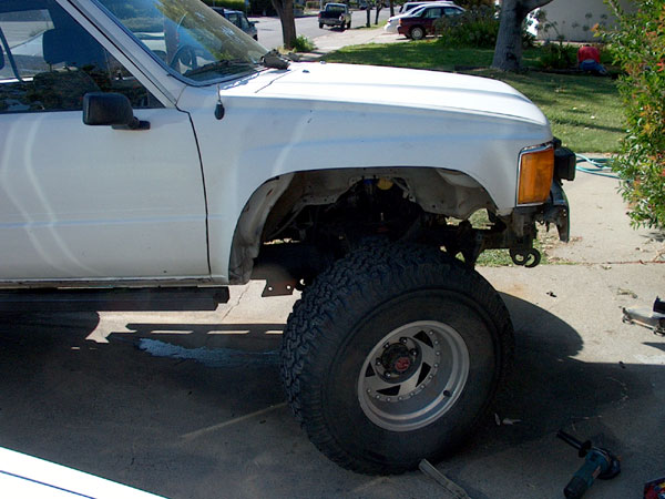

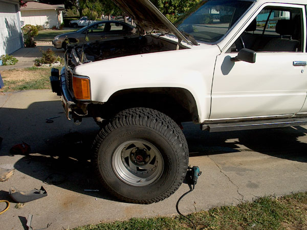

Cool

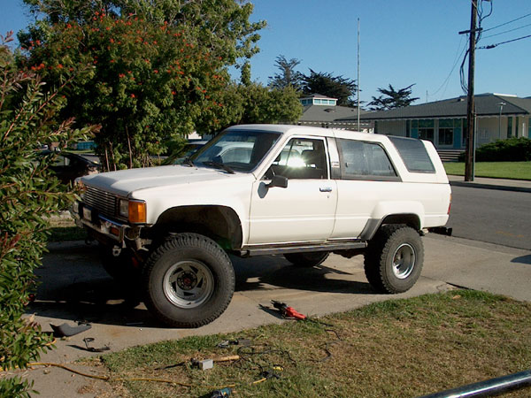

Now that's better...
Looks funny with 33" tires
Firewall tub would be nice.
Time to start the other side.

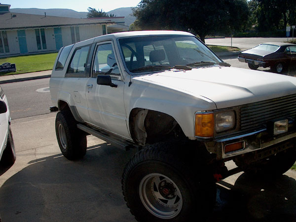

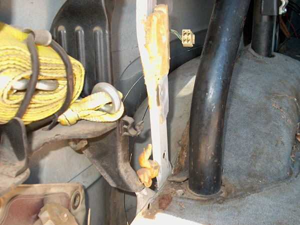

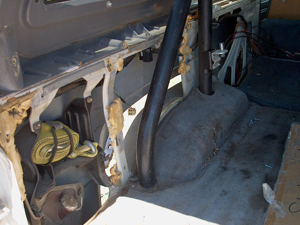

Take this sheet metal!
I always end up with a goofy smile when I do this sorta thing
Almost... there....
Now I just need the courage to start on the rear.

outa curiosity, what did you do to keep the cut from being razor sharp? on mine, i left about half inch of material beyond where i cut and folded it under for a non-meat eating finish.
I'm gonna try out that door trim stuff that presses into place. Looks just like the factory chrome on the rear and should keep my skin happy. Folding the edge is a great idea.

How much can you cut in the rear before you have to weld the inner back to the outer skin?
I don't think you can make any worthwhile cut without welding in some sort of inner tub patch. I think the max would be in the 1/2 to 1" range.
I cut a bit more than 2" from the front. I would like to cut a lot more from the rear so that the upper cut on the front fenders is level with the upper cut on the rear. I'm not sure if this will be possible because of where the rear seats are. I'll have to pull the interior panels off and take a close look at where things meet up.

I think 1" will be the max. EDIT: to keep the inner fender /edit www.toyotafiberglass.com is considering making front fenders w/ 1" larger opening all around - but with the factory toyota look - for those who need this mod but with a more stock look.
I got about an inch and a half on both sides until the inner fenders were straight instead of bowed in.

Mike glad to hear you are SASing. I wish I had the money to do it myself. I think dual case will come first for me as that would be more useful I think than the solid axle. When I do my SAS I want to go three link, so it wont be until after I graduate. In the meantime I'm doing the inexpensive things that I think will be the most useful (ie, Chevy springs, sliders, Detroit)
Okay folks, day two is underway. I went for about 3.5" in the back, all the way around.
Here is where I cut the wheel tub. I used the sawzall from underneath.
What the cuts look like from the inside.
Peek-a-boo!

Hey Mike, can I borrow your 37s to check fitment?
When I get done with the wheeltub, this is gonna look badass. Can't wait to reep the benefits of increased uptravel without muching the fenders.
I have a lot more to do on this, but I have some schoolwork to finish. The truck is going to sit like this for about another week.
My tip for anyone doing this is to invest in a few sawzall blades. I did all of the above with ONE blade and a cutoff wheel. Using the same blade was a bad idea because on the second front fender and again on the rear the blade caught the sheatmetal and jerked it around pretty bad. That can happen even with a brand new blade, but after use the blade gets kinda wavey and makes it more likely.
Also I would say don't let the blade stop moving. If you hav to pull the blade out of the metal, do it quickly while it's still reciprocating. This will keep it from catching and fubaring the metal.
