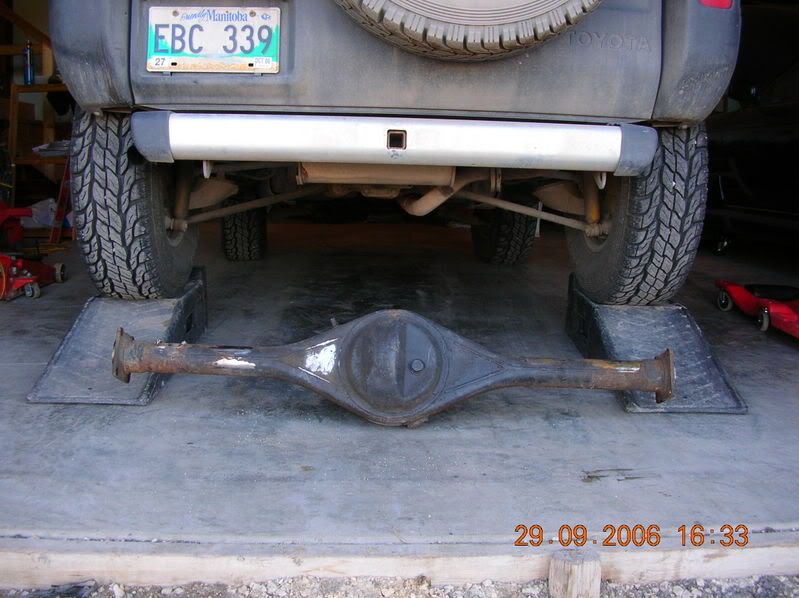

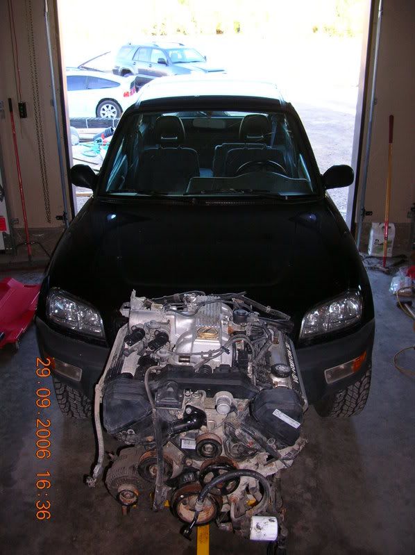

Well im starting on this idea now.. I have this old post rounding up ideas, but now the build starts. So im going to need some help on where and how to mount the 4 link rear.. if thats the best way to go.
Old post >> http://www.pirate4x4.com/forum/showthread.php?t=414439
Here is what im doing.
98 2 door Rav 4
14" Coil overs
JJ's all around
3 link front
4 link rear
36x13.5" Irok tires
Full hydro???
1uzfe V8 with a V6 5 speed and T-case.
Im going to start with the 4 link rear because i have most of the parts and it seems like a good place to start.
shaved housing
Now where to think about making the links mount up to?? Im going to lap areas of the unibody with 3/16" pate to make it strong enough to hold the links. So if you guys could help me figure this out What do you think? I would like to keep the stock gas tank.
And after I do the rear 4 link I have to get this under the hood....

...Since it's unibody... If I were retarded too , I'd probably build some type of sub-frame which would mount to all (or most of) the points that the current suspension and driveline mount to, and build my links from there.
...Or at the very least, tie into those mount points, in some way, since Toyota designed them to carry the weight of the vehicle...

Yeah I have though about that... but I think it might be easier to beef up what is there. I will run a hoop in to the wheel wells to mount the shocks.

I agree with the subrame idea - mounting it to the suspension mounts, etc - but what ever you do, I'm looking forward to this build! Especially if you can keep it a sleeper.

Hey dood, you may want to go three link with a panhard in rear if you want to keep the stock gas tank.

Yeah i think your right, the tank is in a pretty bad spot... i did get enough JJ's for a 4 link
The frame idea might be the best way to go, but there in not too much in the center to bolt to...

OK... so i started to pull it apart today (was still DD'n the little bugger) Now looking at I think im going to make a 1.75" OD tube frame that ties into the unibody ond hang every thing off of it.... Im almost done my tube bender and my 1.75" 240* die is in the mail.
But I have a question.... at the front of a toyota truck (80-94) how wide is the frame (outside rail to outside rail)? Just thinking about tire rum and mounting a PS box... or will I have to run full hydro...
