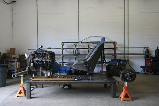

Once Tim got the Old Timberwolf torn down, he started measuring and doing some Bendtech Magic.

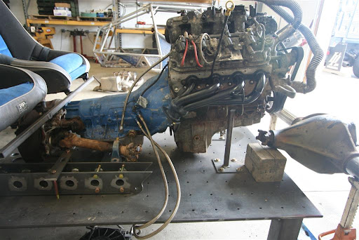

Drivetrain laid out on the sweet Jig table.
Then he started work on the Subframe. This will all get boxed in.

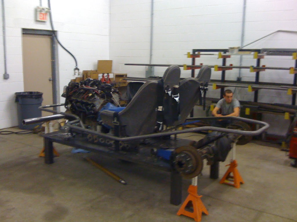

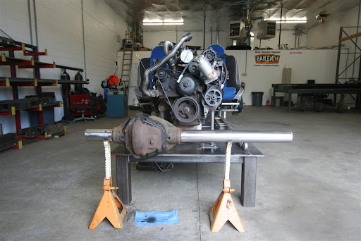

Setting the wheelbase, (motor will be moved back a good bit from this location)
So, this friday, they started bending some tube.
This will much closer to the location of the motor now.
This is where we left off, on saturday wee hours.
More will resume on Monday.
I'm really excited about the whole build. and I cant wait to see what Tim has in store for me in the next few weeks.

A 40 fits like a glove. Almost like I planned it.
These are the end of the day's progress.

OCD shop cleaning much? I think Dom would sweep the shop for 2 hours after every day if I let him.
Turning out real nice. I'm very happy with it so far. Hopefully A.J. thinks the same.
