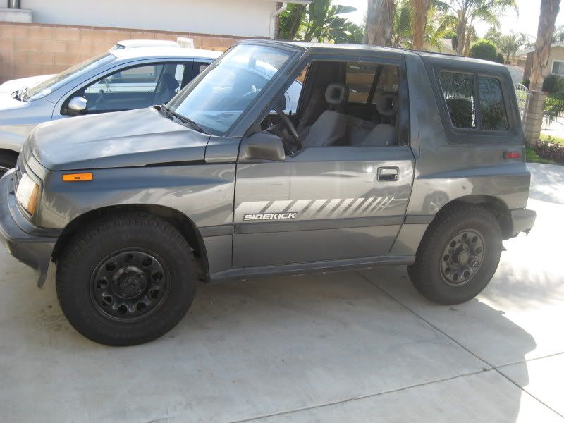

Hi! My name is Aaron, I haven't posted here in a looooong time because I got side tracked from my original off-road project truck...
...and started a company (driftmotion.com) doing 1jz swaps in these...
...but decided I want to go rock crawling so I just bought this...
In the past I would have built it up over time and made a huge 2 year long project out of it, but we're so busy with project cars and our website that I wanted to get something I can just bolt on and go have fun. I know that the mods are not going to stop with this kit I will be installing, but at least I can get the major part of it done and upgrade other things in time.
I decided I am going to turbocharge my little 1.6L, so stay tuned for that!!!
I placed an order with Trail Tough on Monday, I can't wait to get everything!!!
Here's what I have ordered from Trail Tough so far:
Front and rear Toyota axles with new 5.71 gears and Lockrite lockers installed
Trail Tough Straight Axle Coil Spring Conversion Kit
A late model Sidekick transfer case with Trail Tough Rockmonster 4.24:1 Transfer Case Gears installed
Trail Tough Nerf Bars
Trail Tough Front Bumper
Trail Tough Rear Bumper
